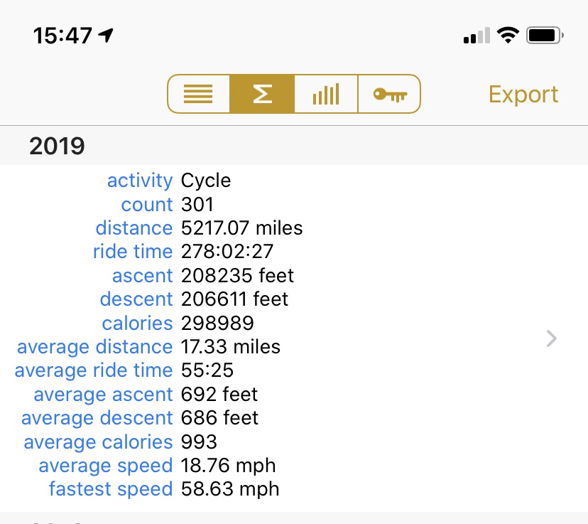

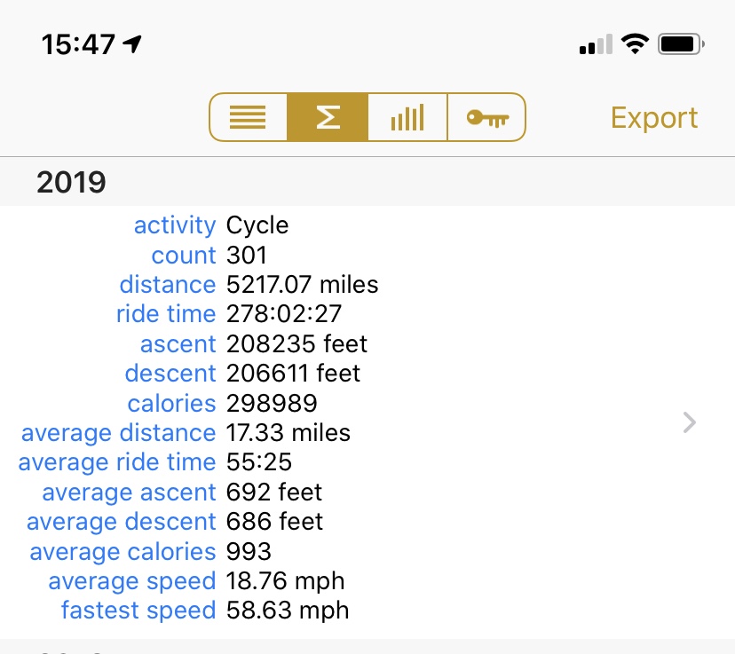

My average speed over the entire year has been 18.76 mph that's 5217.07 miles as of today.
Ignore the top speed. I had some GPS issues last week when it jumped all over the place for a few minutes. I have hit 50 before but not this year. The real top speed is about 10mph less.
18.76 really nice, did you derestrict it ?

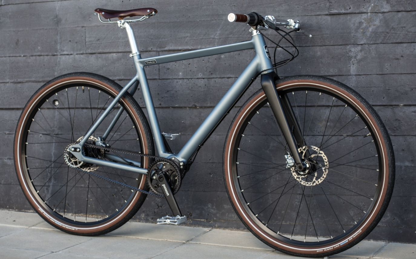

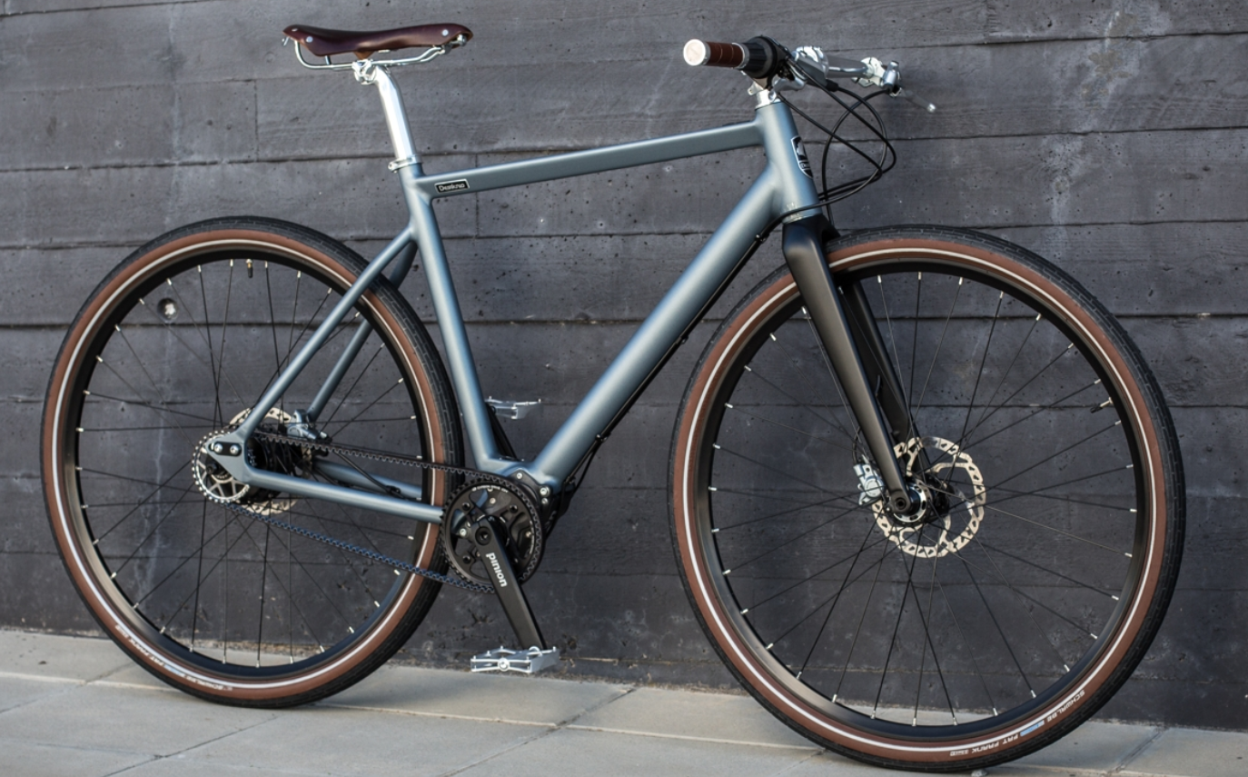

Not a direct drive hub but I still like the Desiknio over those other designs. Maybe better for a stronger rider. And their video with Fully Charged mentions a patent related to the Pinion integration:
If you like the desiknio, you might be into the Enki Cycles' new bike.
Mid drive with 25% more torque than Bosch apparently
