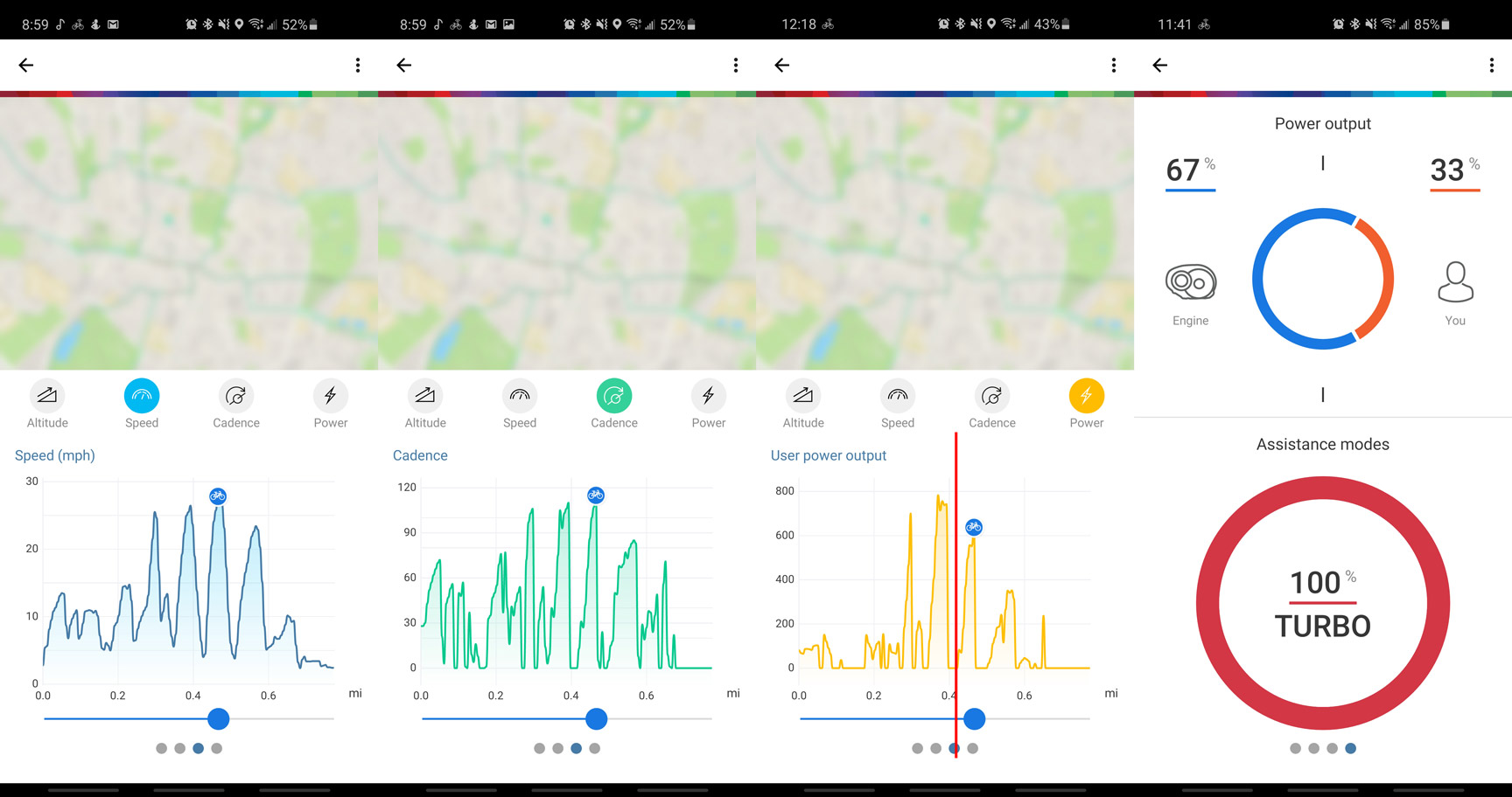

25 is hard, 28 near impossible, 20 easy as pie. Power screenshot attached
Makes perfect sense. You see you are hitting almost 800! Can you also post the altitude and speed graphs too? I like to see the grade and speed.
At 28 it is completely you so given the weight and riding position 700 is expected and it is as you said near impossible.
At 25 though when the motor supply 250-350W you should be able to keep that speed with a modest 250w rider input.
I am assuming that you are maxing the motor out, Bosch usually gives you the percentage of the power supplied by the rider too it would be great if you can show that too.
Hi, speed and cadence are in a prior post. Altitude/grade are not captured. Power ratio attached.
Overall, my concern is anything above 20mph. A motor that can get me to 20mph with ease and barely lends anything further up through 25mph or 28mph, does not seem to be maxed out; it just quits.
ok Just checked. Your input around 25mph is too high. Your input should not be 600w+ when you have support unless you are climbing. Don't expect to keep 28 with these motors though because of the cutoff.
Do you still hear/feel the motor engaging at 25mph? Your cadence is fine, these motors will be close to their peak power until late 110's.
While going 24-25mph try turning the support off and see if it is any harder?
Of course the simplest is to try another bosch gen 4 speed bike on the same route to see if it is any better.

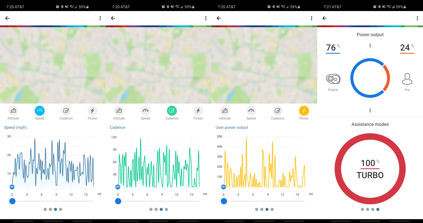

Has anyone noticed that the assist acts differently based on tire circumference setting in Kiox? I'm getting drastic improvement by up-ing circumference setting in Kiox from the stock 86.22 inches to ~88.5 (closer to actual) LBS said this shouldn't matter but I'm getting better assist up to 28mph as a result and everyone's confused. I dont want to throw off the Kiox accuracy for MPH and cheat the system in any way but my user power has dropped significantly (~<500W, down from ~800W)

86.22"
88.5"

86.22"
88.5"
Weird but the second graph seems normal and it seems to be assisting properly.
At 88.5 your reported speed is higher but the difference is so small that it shouldn't make this much of a difference. Maybe this is a buggy speed hack prevention feature.
