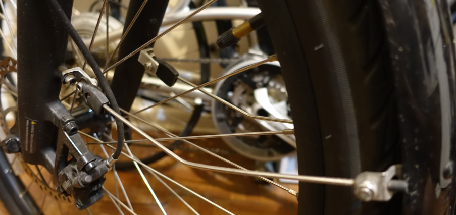

I'm new to the site and just got my CC last week and enjoying upgrading it. Two questions for you. Do you know what size bolt will go into the front Suntour to mount the fender supports and can you share your mod for centering the mtx rack?
I believe they're M5 threads. I don't have the MTX rack but a cheapo house brand rack from Performance Bike. Not sure the way I mounted mine would apply to that rack since mine has adjustable height legs. I cut the down the spacers to center with the tire. Bent one leg forward to correct the tilt & line it up front to back. And one one leg sitting higher then the other to level side to side.
Thanks for the tips.
I got my Blackburn Central 700x60 fenders installed. It's been raining like crazy in Southern California this winter. The fenders were quite a pain to get on the bike requiring three trips to the hardware store and the purchase of a cheap rotary tool on Amazon to trim down the fender stays. I removed the mudguards because they require you to mount the fenders really far from the tire to prevent rub. Took them out in the damp conditions last night and they work very well. My 17.4aH battery should be arriving tomorrow so I can start doing some range testing.
