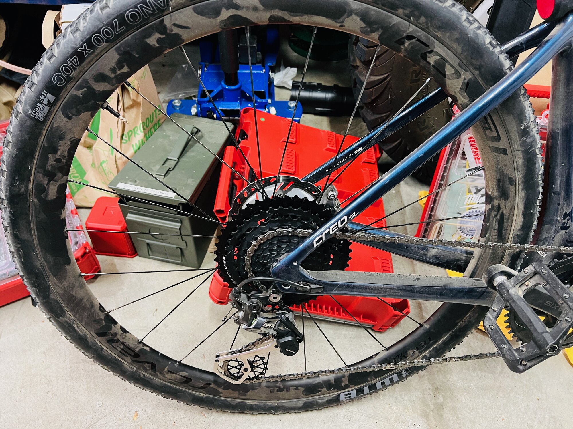

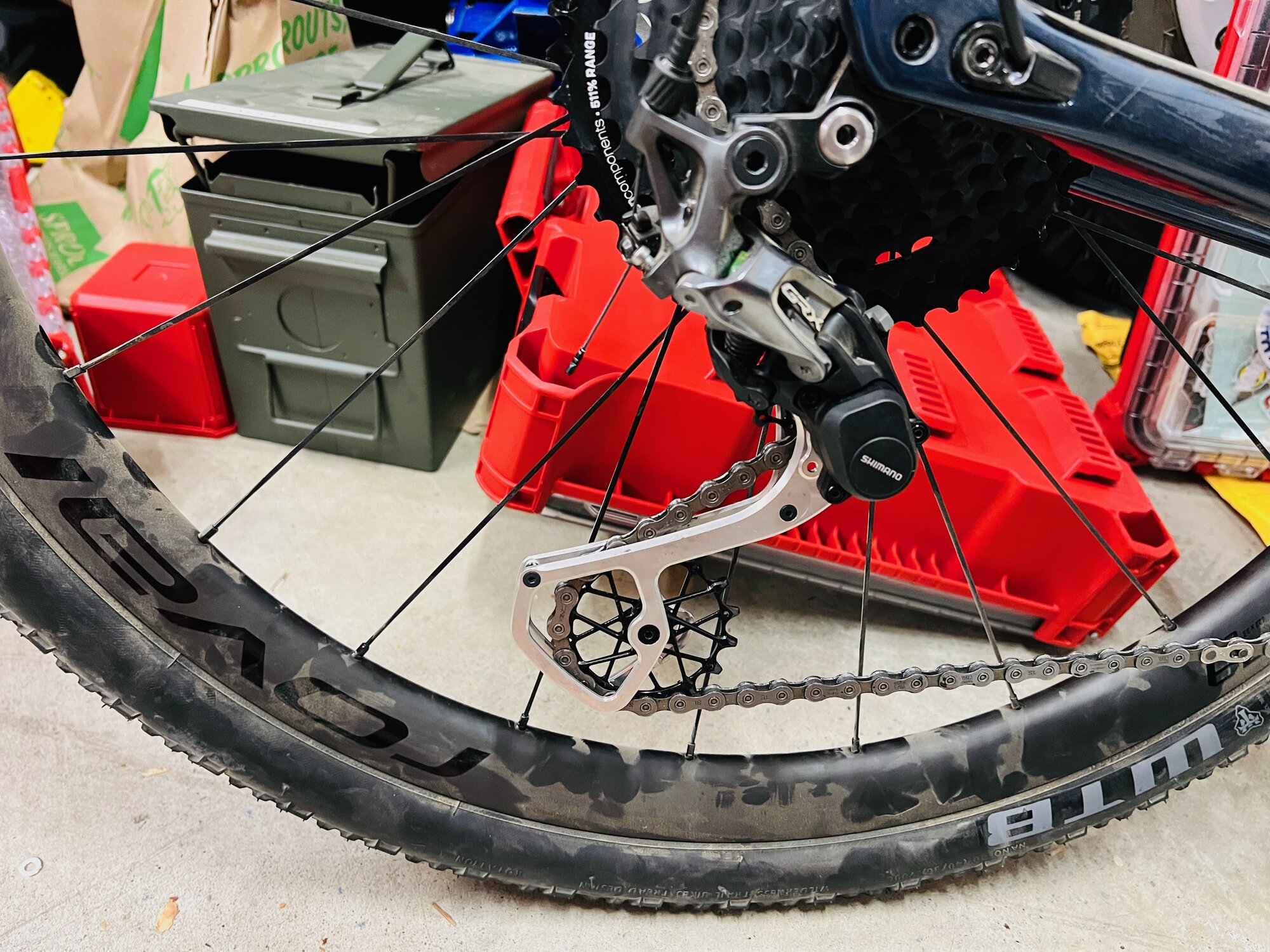

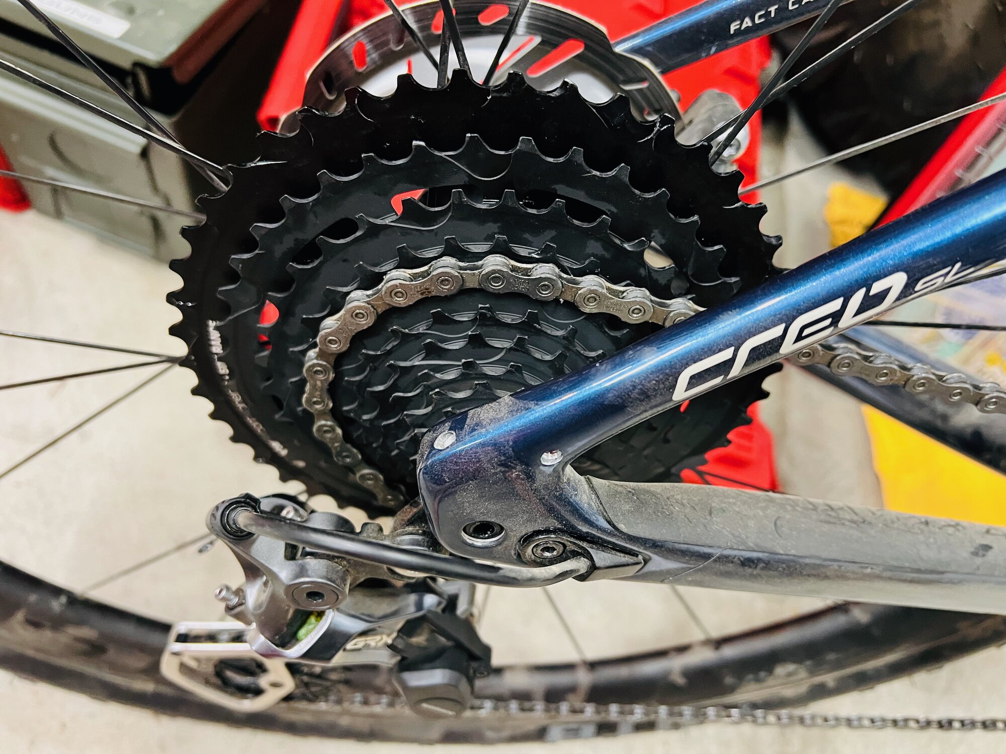

I went with the Garbaruk long cage and pullys for the Shimano GRX with the eThirteen 9-46 cassette and it's super dope! It's so fast and can climb anything. Really happy with it. Nice work Garbaruk!

I know the Shimano GRX has sufficient B screw adjustment to accommodate a 46 tooth cog even though its specs say the max is 42. This was done without the use of a wolf tooth goat link and did not even require a longer chain! Whether the same can be done with the Sram etap, I have no idea.
