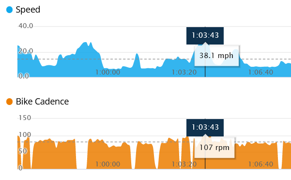

I'm a spinner and often go as high as 90rpm ... and if I hit 30+mph on a descent I'm probably going to coast.

I tend to average in the high 80's for cadence. Particularly if I'm pushing rather than lollygagging.
