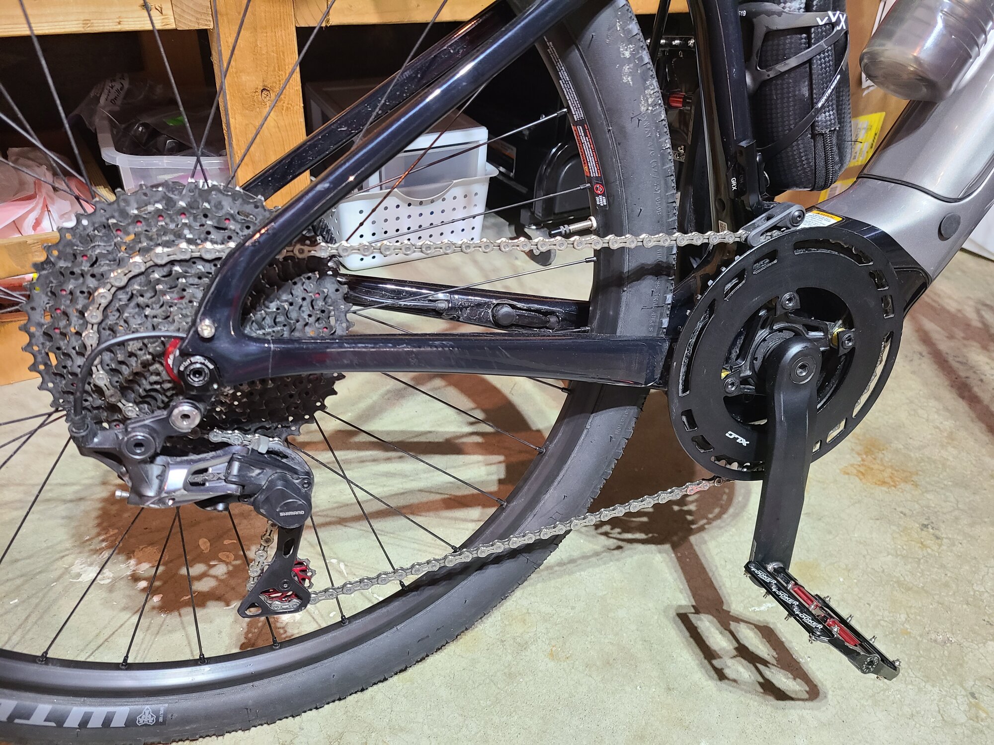

I ride a Cannondale Topstone Neo Carbon - a drop handlebar gravel bike that is similar in some ways to the Creo. It does have a more powerful motor, bigger battery and left front fork which gives is another 10 lbs of weight. The wheels are 650B with 47mm tires.
As I ride it at more on pavement than off road so I wanted a top end that did not require such frantic spinning. It came with the GRX group set, a 11-42 cassette and a single 44 tooth chain ring.
In order to get my candence down to 75 rpm at 25 mph, I swapped out the 44t chainring for a 48t and bought a larger front chainring guard to cover it. Shimano specs the GRX to accommodate a max cog size of 42 teeth but I found the 11-46 worked just fine with an adjustment to the B screw.
I live in a hilly, mountainous area at the top of a 600 foot hill to end every ride. Changing to a 11-46 cassette allowed me to recover lost climbing ability with the larger chainring. I used a Sunrace 11-46 cassette (all black) as it shifts smoother than the Shimano and has much more even spacing between gears.
Unless I was to go to a 2x chainring or change over to a 1x12 speed system with a 10x50 cassette and a 44 or 46 tooth chainring, I could not do any better and am quite happy with both the top end and bottom for my riding. That would require a new hub with a or microspline driver, a significant added expense.
