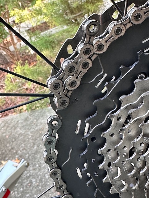

Dragging open an old thread which I have been reviewing prior to today’s project after a good ride. For anyone wondering if you can run an 11-46 on a first gen Creo with the standard GRX derailleur:
Note that this configuration is not supported by Shimano, but tightening down the B screw and adding a brand new chain as well gives me the desired 6mm spacing to the largest cog and the whole thing is shifting beautifully. If it all explodes and tries to kill me at any time, I will acknowledge it, but as it stands right now I have a greatly enhanced climbing gear with no identified downside.

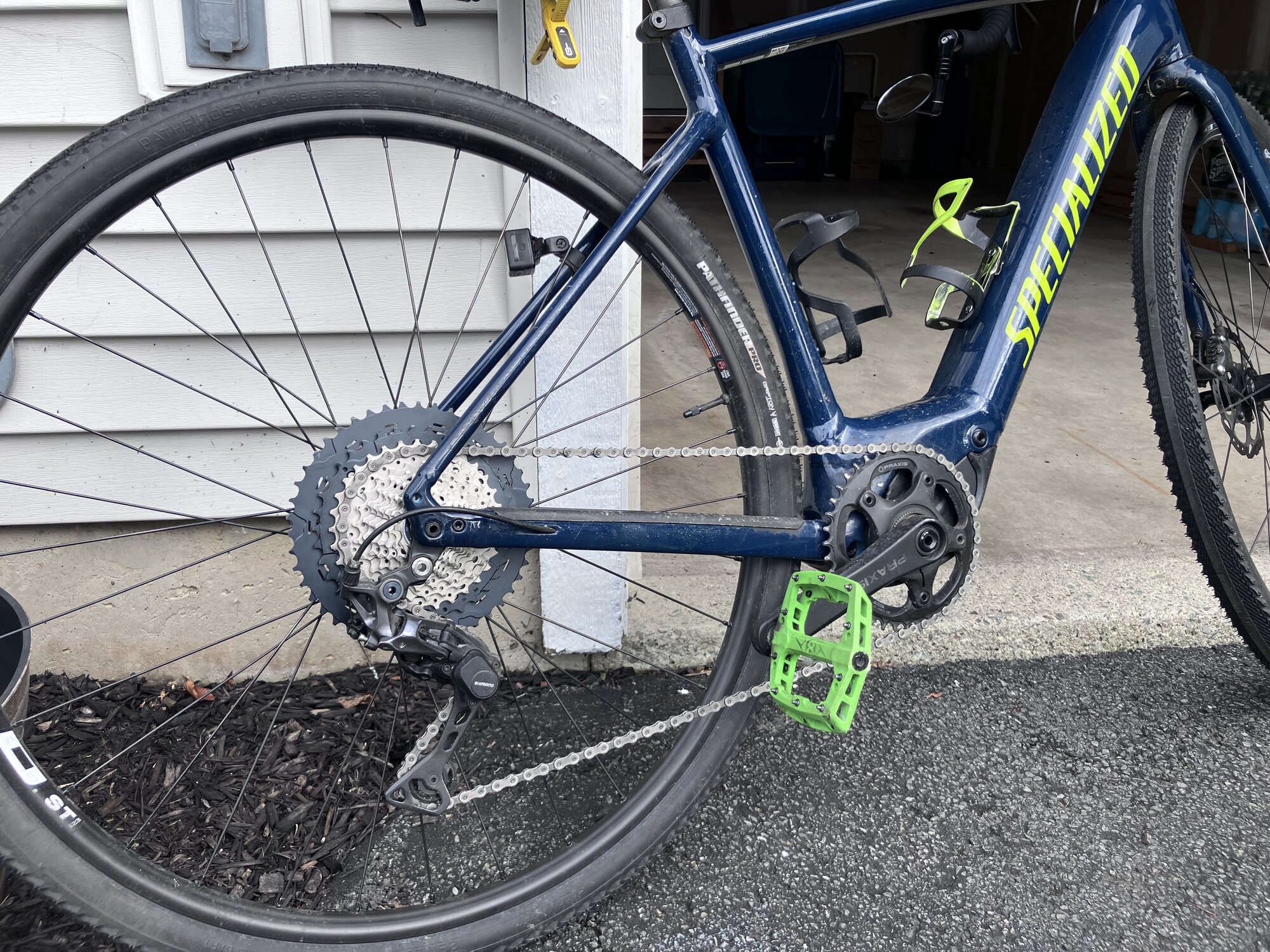

I'm running a 11-46 cassette, Wolftooth 42 chainring and Shimano Deore XT Di2, Shadow Plus, 11-speed combo for the last 8k miles. I bought the Wolftooth extender but did not need it. I use a 116 link chain. i took the chain keeper off since it didn't really do anything. I had a dropped chain from a slightly out, derailiuer hanger. Once that was aligned it's been good. The Creo 2 chain keeper will not fit the Creo SL because it mounts in a moulded recess on the case. They both attach through one of the motor mounts.

Interestingly I recently put a Shimano XT Deore M8000 11-46 cassette on my Creo1 E5 with 46T Wolftooth chainring -- after appropriate adjustments of the GRX812 derailleur it's seemed fine. (not a lot of miles on the chain)

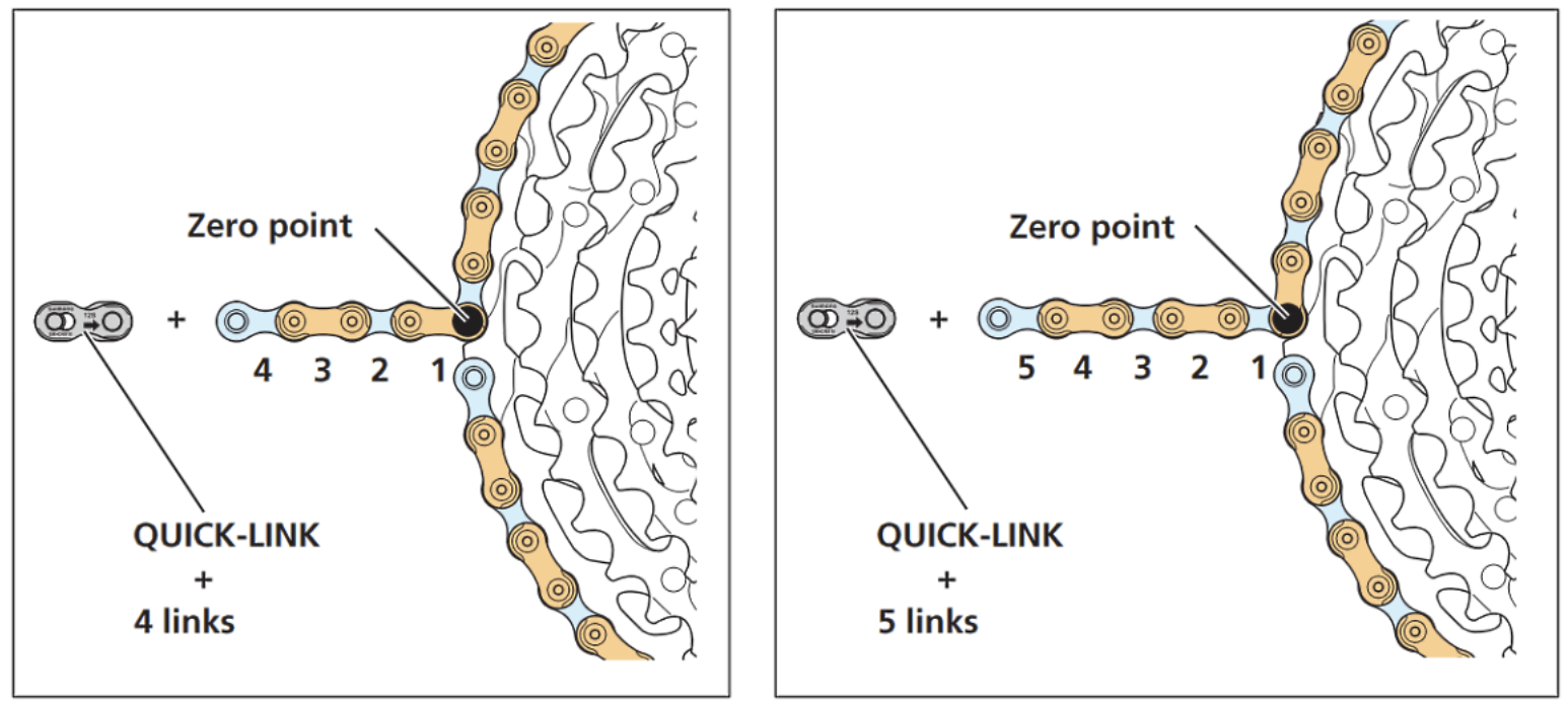

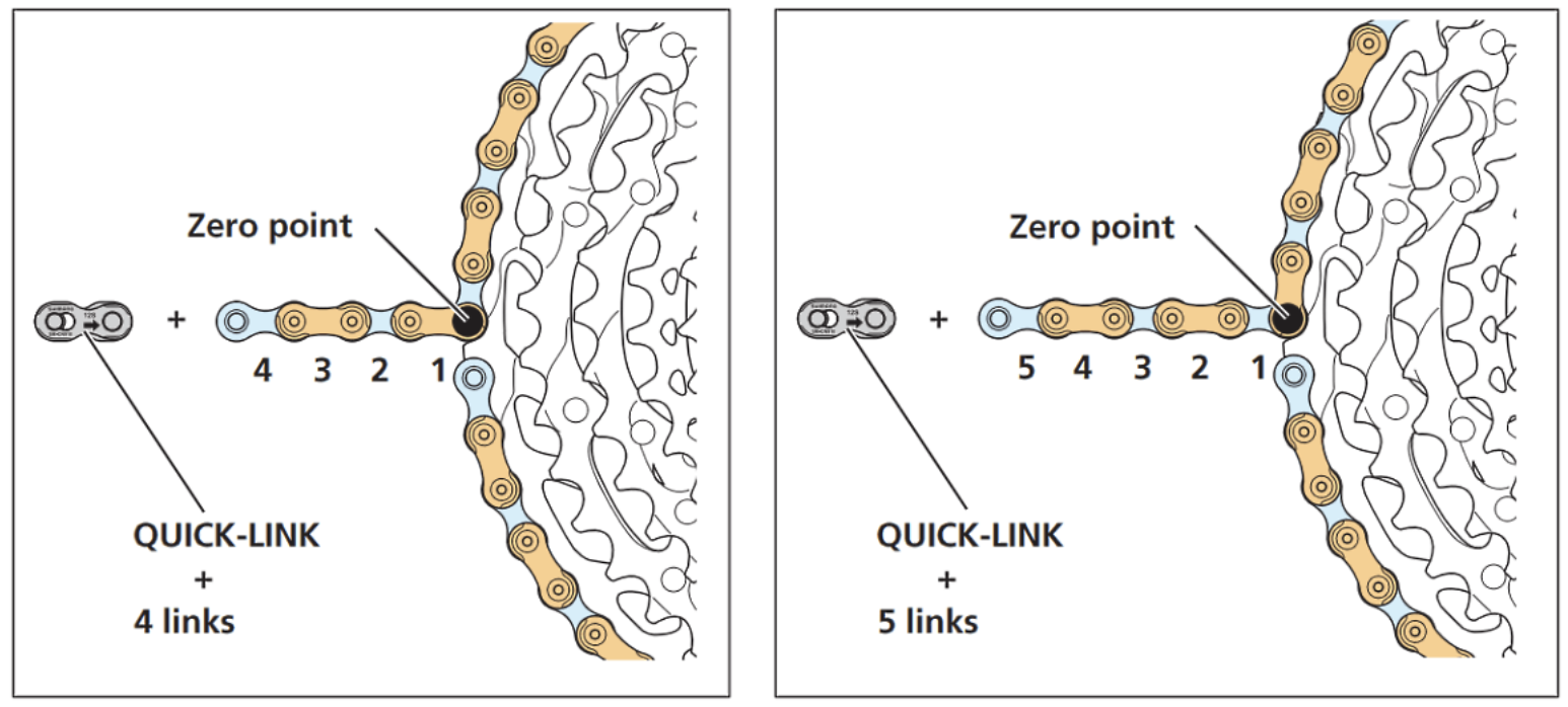

Still, I figured I better double check and today went through the process of removing the quicklink and checking the chain length per these instructions the chain length is already fine. Per the Shimano GRX-812 manual, it's okay but I could go two links longer if I was concerned about "turbulence in the drivetrain components" -- so I'll see how it goes for the time being. (yes, it can stand a cleaning)
