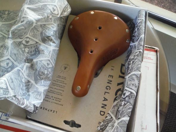

Look at what just arrived. I was able to get an amazing price on it because it was called a 'woman's' saddle. Who cares? I never get to work on my own bikes. When I can, this will go on a new classic build. It will be elegant. And nothing like the fat chopper bike I am working on today.

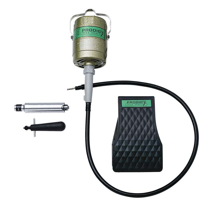

Been there too! Almost always the case with old Schwinn steel frames. My wife's jewelry Dremel on a cable does it nicely. But painstaking!
