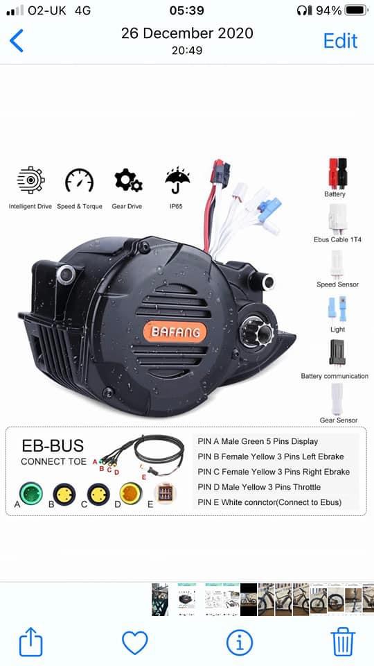

Unfortunately, the m620 doesn't have a brake sensor :(
This suggests otherwise. That is the brake sensors connect via the EB BUS cable loom. My Frey Beast cuts power when I apply the brakes (Magura MT5e brakes).

As I recall there are connections for front/rear lights (no brake activated light). I've taken the motor out a few times and the light connections are present
My Frey Beast is the same. I find that the motor still runs for a bit after stopping peddling, and it ignores the shift sensor during this overrun (perhaps I need to adjust something?).
