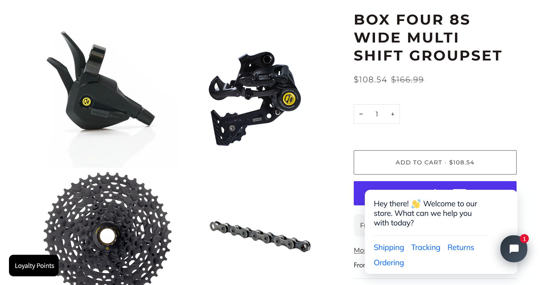

With investing, in my opinion, in a DM02 it is worth it for a major drive train upgrade. The left shifter will go anyway. I would look into a Box 4, 8, 11-42. The 8-speed is wide and robust. It has a powerful clutch on the derailleur and you will be down to 1:1 for huge climbs. A quality 48V 10.5 or even 7Ah is all you will ever need. This motor is highly efficient if you are pedaling.

Can or will I be able to use the wide/narrow chain with the new ring gear, 11/42 and 8 speeds?

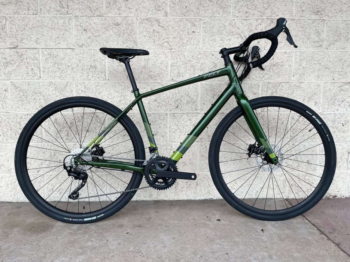

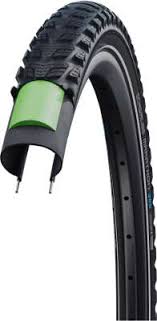

Yes, use a normal 8-speed chain. And use the standard 10mm offset 42-t steel DM02 chainring to bring in the chain-line in to hit first gear. I am 35 miles north of the Golden Gate. Look me up on Maps and I can help you to order parts and give individual support before, during, and after. The bike I am working on is a beautiful bride of Frankenstein. It is almost done; just needs Marathon 365's, 50-622's today. The starter bike looked like this green one. Now it has a stem riser and backswept bar, comfy saddle, and a DM02.

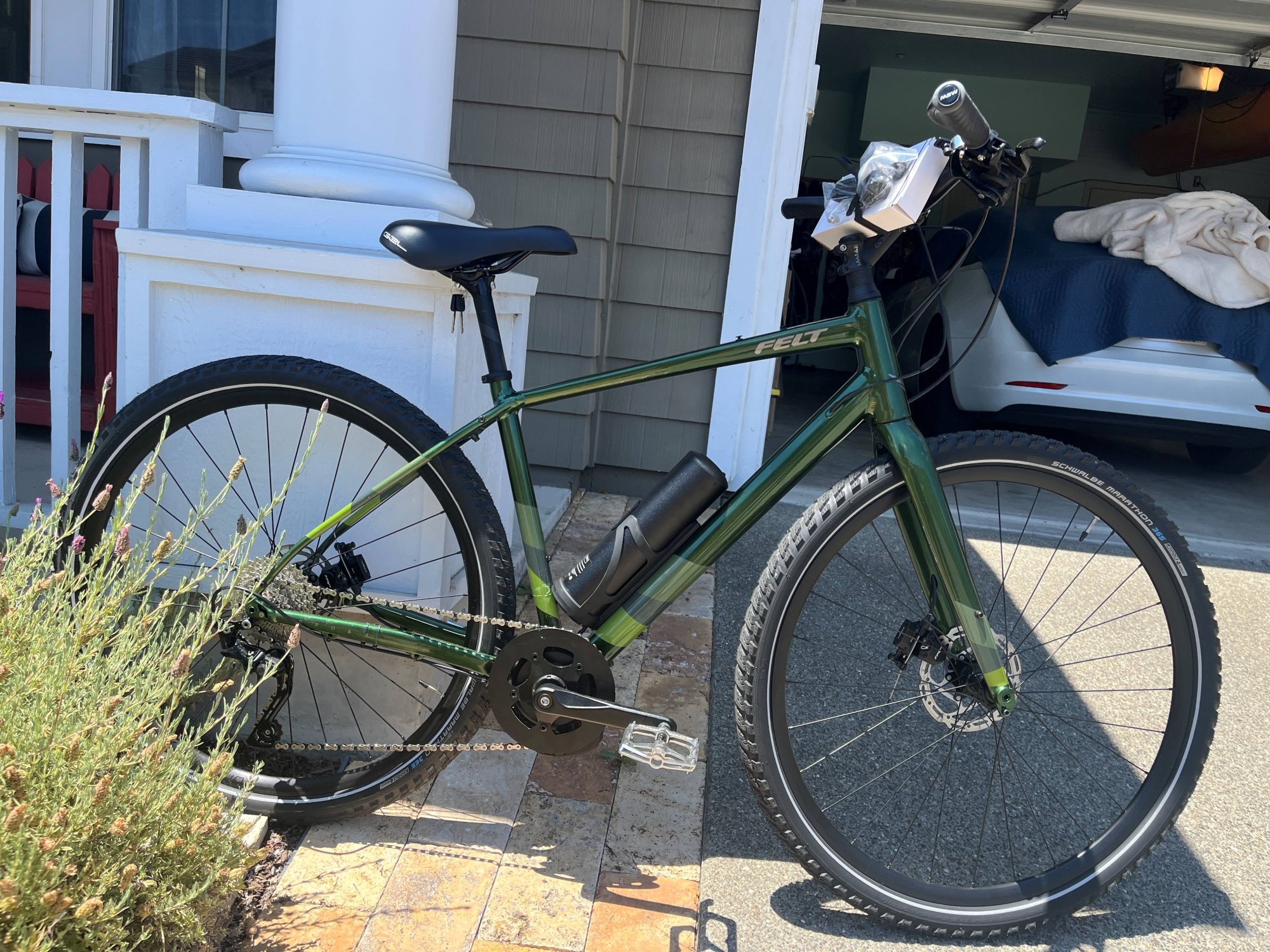

Update: I dropped-off the bike to my friend's garage with the conspiratorial help of his wife, a H.S. languages teacher Jennifer. He is an Electrician. We covered it in a blanket for him to discover on his own. A whippy green dropbar skinny tire gravel bike is now effing bad-azz. I had it to 28 on a test run at mid-level. I do not want to crash over 24, 34 Kph. That means broken bones, with a long recovery. Going along at 18 is fine for most rides, 28 Kph. Its limit is 50 Kph. No throttle, pedal torque sensor only. And fully user programable. The white box is the charger.
@stompandgo, here is the black box. I can adjust the degrees of angle of kick-in and feel of the torque sensor millivolts, and everything, like milliseconds of overrun for smoothness. Download to expertly critically review me if I am F.O.Shite. You can't just do that on other bikes. Specialized? His bike is so tuned, thoroughly refined, it kicks the butts of $10,000 bikes from stores. If I am Full of It. Call me out.

My friend's wife covers the car so the cats don't scratch it when climbing on it.
Oh, I just remembered about one morning when there were horrible mechanical sounds, followed shortly by horrific human screams. A cat sleep inside the engine compartment of a car for warmth. Then the owner started it.
When my friend was helping remove the car cover this morning, he found the green Felt bike. He thinks it is beautiful and will ride it tonight. She asked me the price today. I told her that is free for one week. It is like the free gift of heroine.
