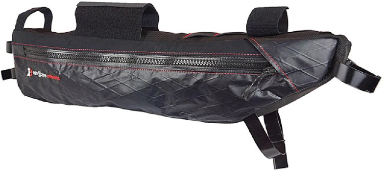

I think something like a Revelate frame bag, hanging from the top tub is the right way to carry it.
Just like you mentioned, my plan is to use partial frame bag to carry the second battery.
