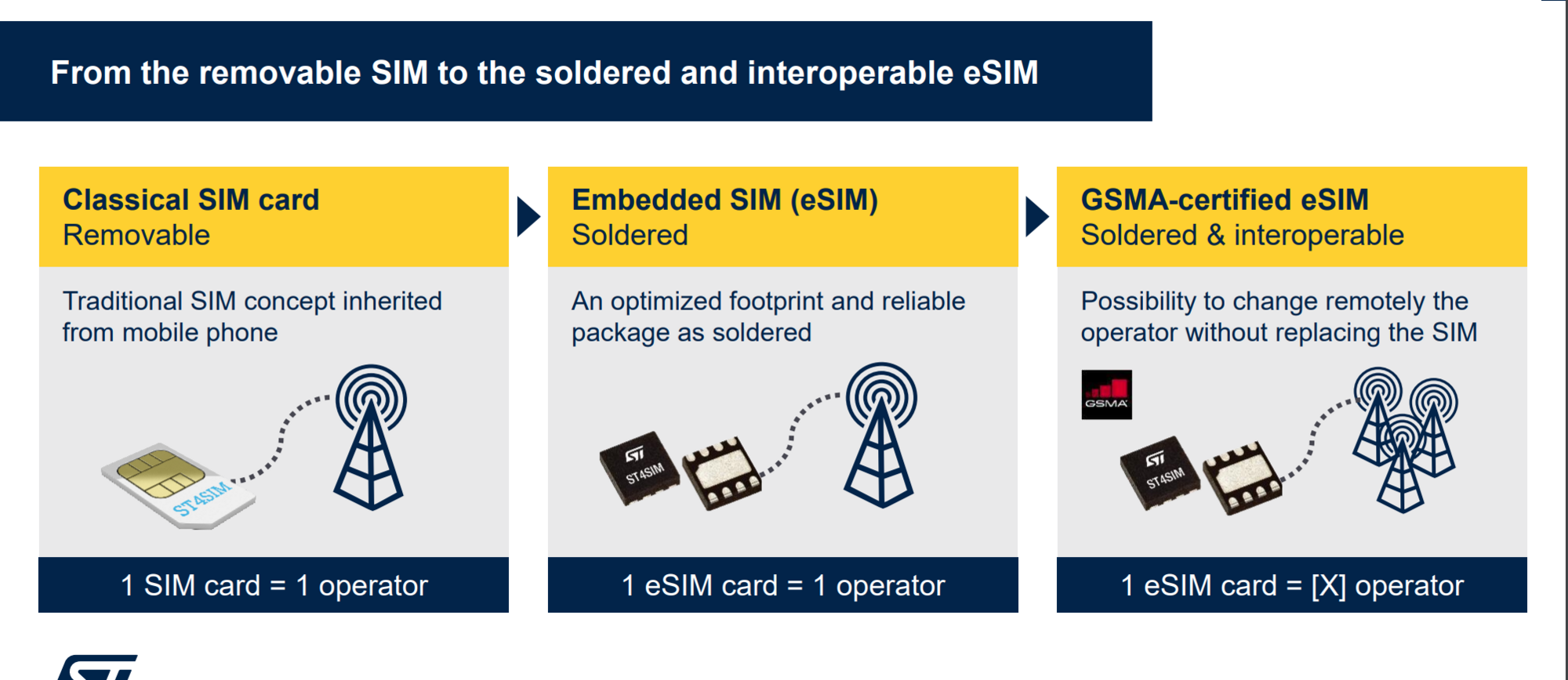

After consideration and technical analysis with some technical friends, I think we have a solution for some of the Canadian Stromer owners.
If you managed to turn off your Canadian based Stromer, before November 30th, 2022 to avoid the forced Canadian firmware and your bike remains off, this may work out for you. Kill the SIM card, before turning on your Stromer. The Stromer OMNI-C controller is based on a Sierra Wireless radio model HL-8548. There is an embedded SIM card (eSIM) that you can find on the board. There are many YouTube videos out there that can show you how to heat up the SIM to soften the top and pull out the SIM. This should leave the Radio intact, looking for a cel tower, without an IEMI/SIM to authenticate on the network.
Upon more consideration of this possible fix, it made me think of something as an owner of two Stromers. We should be able to ”opt out” of any connectivity for my ebike. If you do not want to be tracked, the dealer should be able to disconnect any ebike from cellular connectivity upon delivery. It’s a basic right to ask not to be tracked, however, this would also discontinue the alarm service that is included from Stromer and no ÔTA OS updates would be possible, unless you could toggle the SIM service on and off manually for software updates only. If you want to track your own bike without Stromer knowing, just use an Apple AirTag or TILE system, as you wish.
I am considering my options moving forward, I look forward to hearing if anyone out there killed their eSIM and if their Stromer continues to work well without cellular connectivity, which I assume will be fine without a SIM. I heard from a friend this week, that a Canadian owner of a new ST1x was throttled down to 32 Kph on Nov 30th, as he was on a ride! The bike “just started offering less assist” during the ride and he called the dealer to find out about the ÔTA update was today… poor guy and he had just bought the bike.
Any other Canadian Stromer owners running into problems, been affected or are looking for a fix? Please post! Keep your Stromers OFF, until a fix is found. More news shortly.

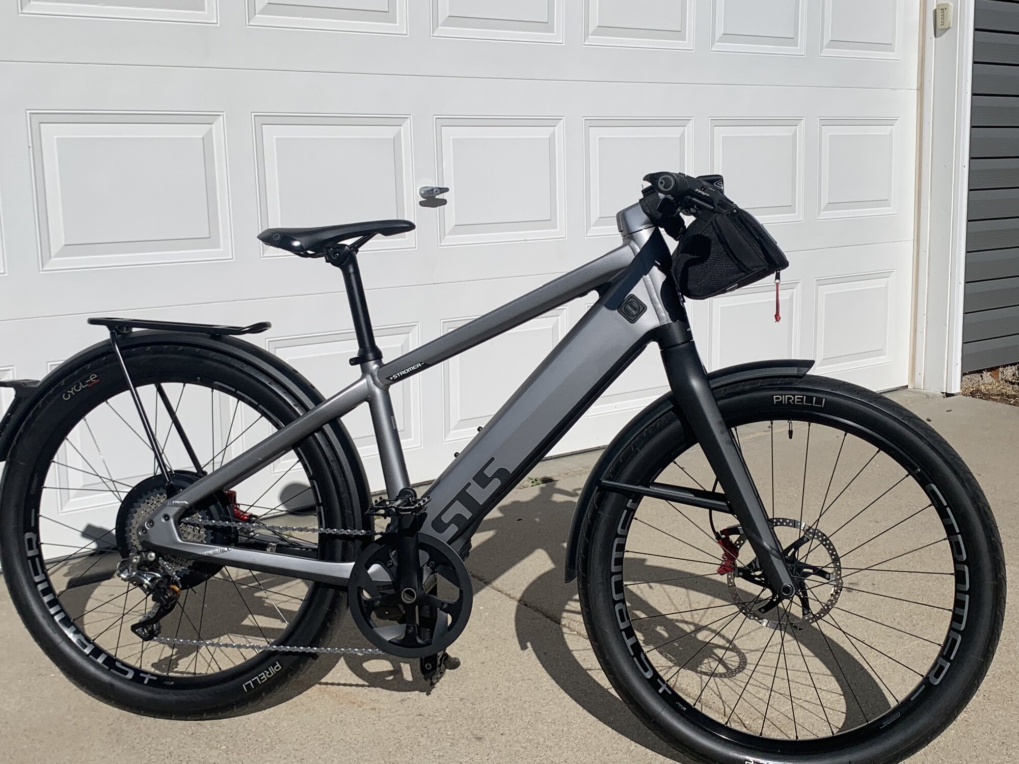

Minnesota but can deliver close to Canadian entry city….
It does suck that Stromer is now forced to comply with crazy CA law. 🙁

I wonder about just shielding the SIM. I was thinking it was more like death rays from space. Canada is so huge that there must be many unpopulated areas without cell service where the bikes would continue to work just fine.
once it gets the "upgrade" it can't be reverted back. I would have disc. the Sim by now or connect a Sim card with a US address ?

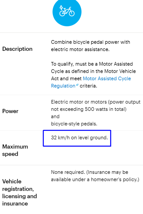

"Below are universal rules across the provinces in Canada regarding electric bikes (excluding Prince Edward Island, as they have their own set of rules):
  • Motors are limited to 500 W output, and cannot travel faster than 32 kilometers per hour on motor power alone on level ground"
Specific rules for BC, Canada:
Chap, you can protest to Stromer until you're blue :D
I would recommend doing a deeper dive into the source Regulations. As a starting point, the fact a motor-assisted bike has a maximum speed greater than 32 km/hr simply means it does not qualify for the category identified by ICBC in the above screenshot from their website. Importantly, however, laws/regulations in BC do not ban, outlaw, limit or otherwise restrict motor-assisted bikes from travel on public roadways at speeds above 32 km/hr… but don’t rely on me, please DYOR.
