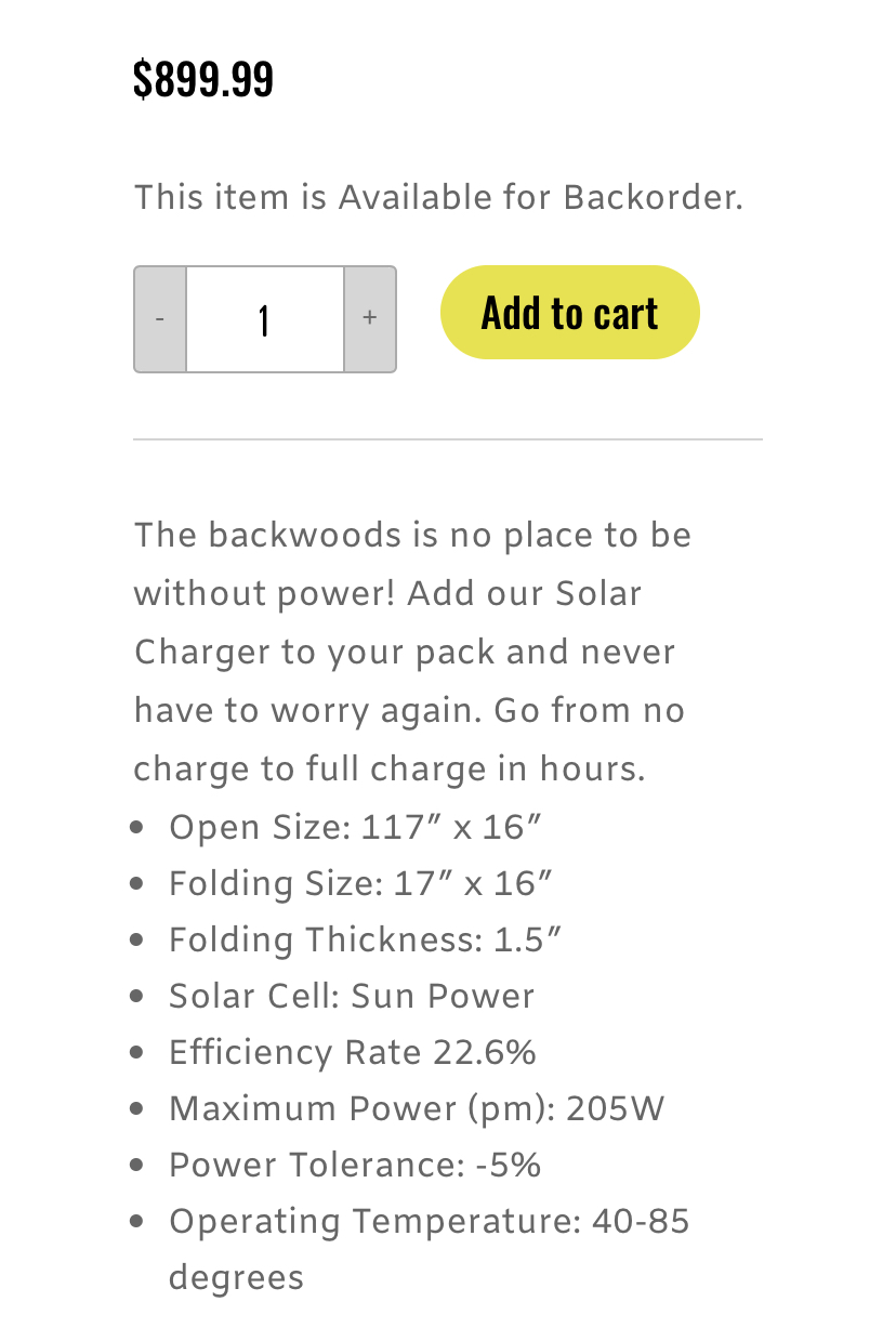

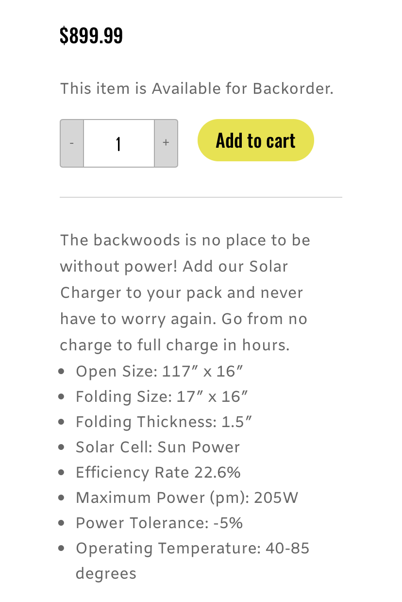

There seems to be a distinct lack of reliable information worldwide on this "+5VDC on CAN bus line trick", the discontinued 12V Bosch Travel charger & powerbutler.de in regards to newer Bosch batteries & Y-Cables (dual battery setup).
Upon closer investigation, PowerButler looks like they weren't shipping outside Europe and the dead YouTube channel with the unanswered comments looks like they're not in business any more. I've deleted the post to avoid wasting anyone's time with them. I'd love to test some Bosch batteries but sadly all of my batteries are free of proprietary encumbrances and I don't know anyone who would be willing to let me play with theirs.
What i like most about this is: "Operating Temperature: 40-85 degrees" !
And secondly "Maximum Power (pm)" :)
Oh, and thirdly "Power Tolerance: -5%" :)
The first two are just lazy typos while the -5% power tolerance is incomplete but not surprising. PV modules are commonly rated with power tolerances with -5w/+5w (US, a few years ago) or 0/+5w (Europe, due to different laws and US now as well) as the PV cells have manufacturing variances and the PV modules have cell mismatch so all manufacturers have to bin the power ratings this way. This is why you typically see PV module datasheets for the same module but listing, say "355w, 360w, 365w, 370w" variants of the same module. They all come off the same assembly line and they just put a different sticker on them depending on how they test when done.
I'm more offended by the price. $900 for 205 watts? That's $4.39/watt! Unless these Rambos are adding value to what they're selling, you can and should get the same quality from the usual scumbags (AliExpress, Alibaba, eBay, Amazon) for $1 to $2 per watt. Given the lack of attention to detail in spelling out the product specs, I wouldn't hold my breath.
And what's the deal with photographing the product on a cloudy day? It's a notch above the hatchet-job PhotoShop abominations I keep seeing in so many other folding solar panel product postings but come on, you're selling a solar panel. At least pretend you know how to use it.
