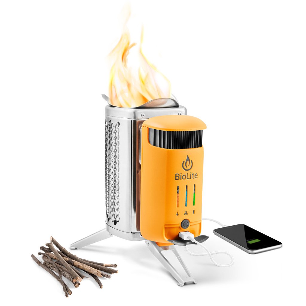

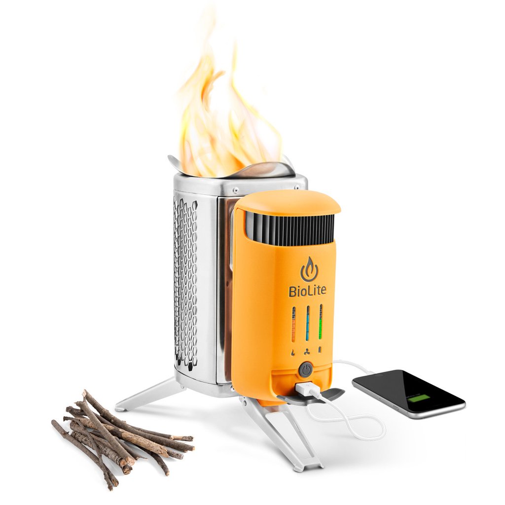

This seems it would work and it can charge more electronic devices, a lot smaller to carry, has a internal battery to store extra power, can help cook your food, keep you warm, works day or night, sunny or cloudy, 5v 2 amp USB output, and can work in any weather. Just need to figure out what type of USB to power adapter to charge the battery.
BioLite: https://www.bioliteenergy.com/products/campstove-2
A 2amp output to charge a 14ah bike battery? Laughable.
