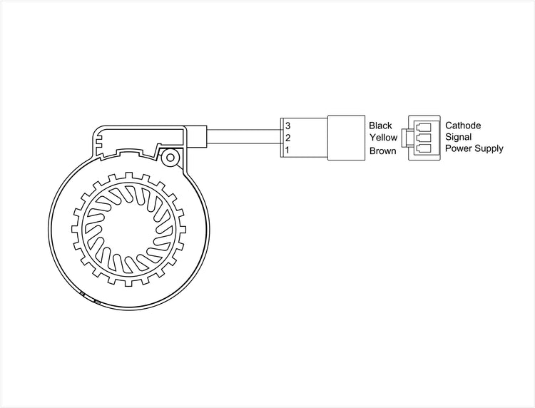

The most common cadence sensor
The signal from the cadence sensor is an symmetrical square wave. It's different when pedalling backwards vs forward. So you will have to analyze it, and set your electronics to simulate a forward signal. Should be easy enough for you young techies.. It would take me too long to relearn that stuff.

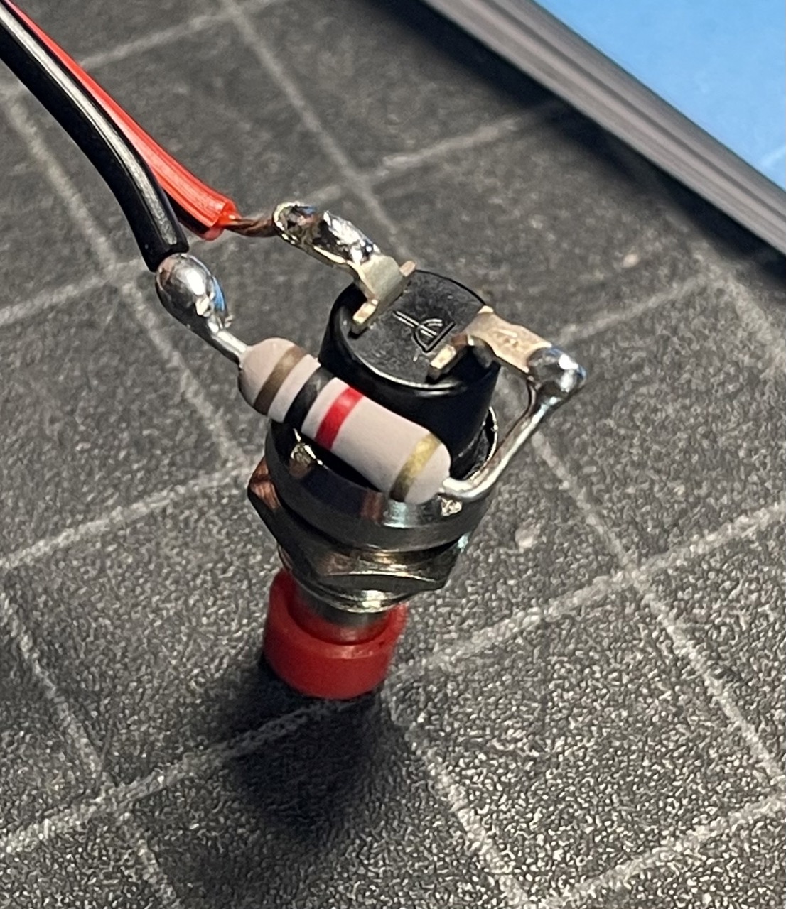

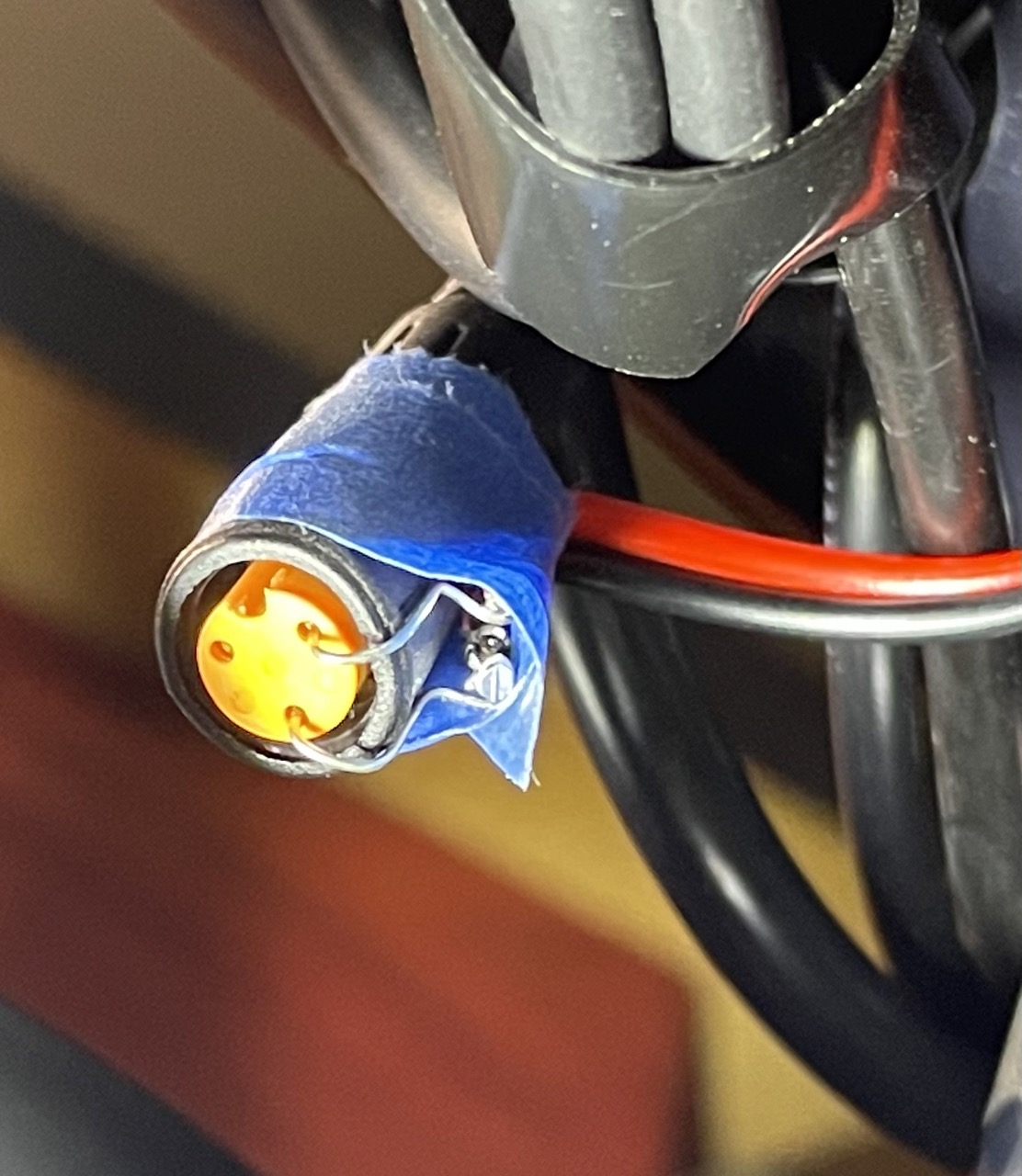

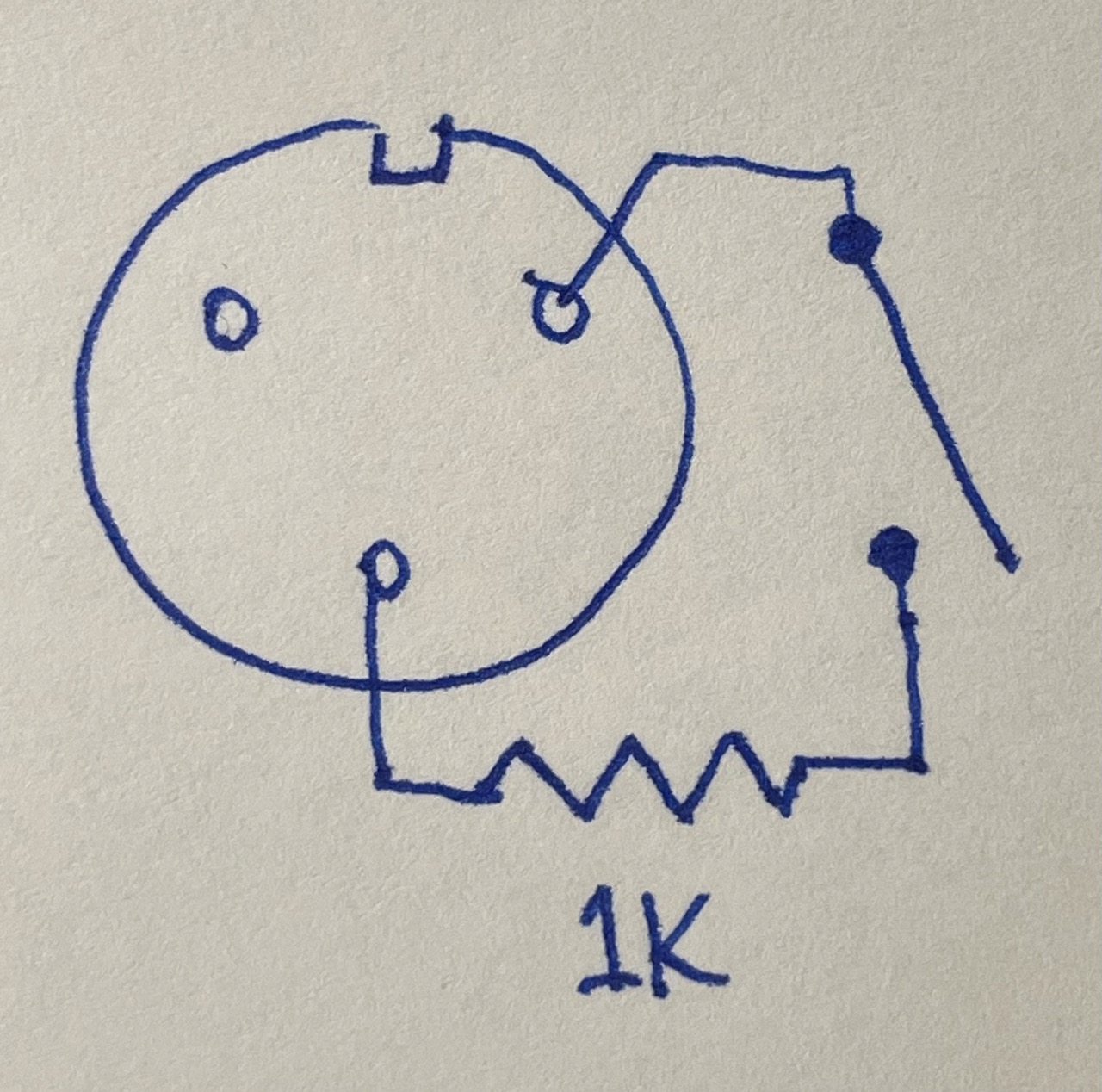

I found the simplest possible solution. Simply short the two pins shown below using a momentary switch and a 1K resistor. The 1K resistor prevents the short from drawing too much current (4.5v drop across 1K = 5mA). You just need to tap the button a couple of times each second (say, 120bpm, for the musicians out there). I went for a test drive, and it works perfectly! Now I just need to mount the button where my thumb goes, just under the throttle. (You need 60" of hookup wire to reach from the PAS connector to the throttle controller on the handlebars.)
I don't plan to plug in the crank sensor again. Effectively, PAS is moved from my feet to my thumb, making my ride more of a motorcycle than an eBike, which is exactly what I want. :)

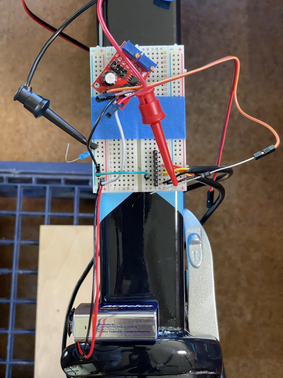

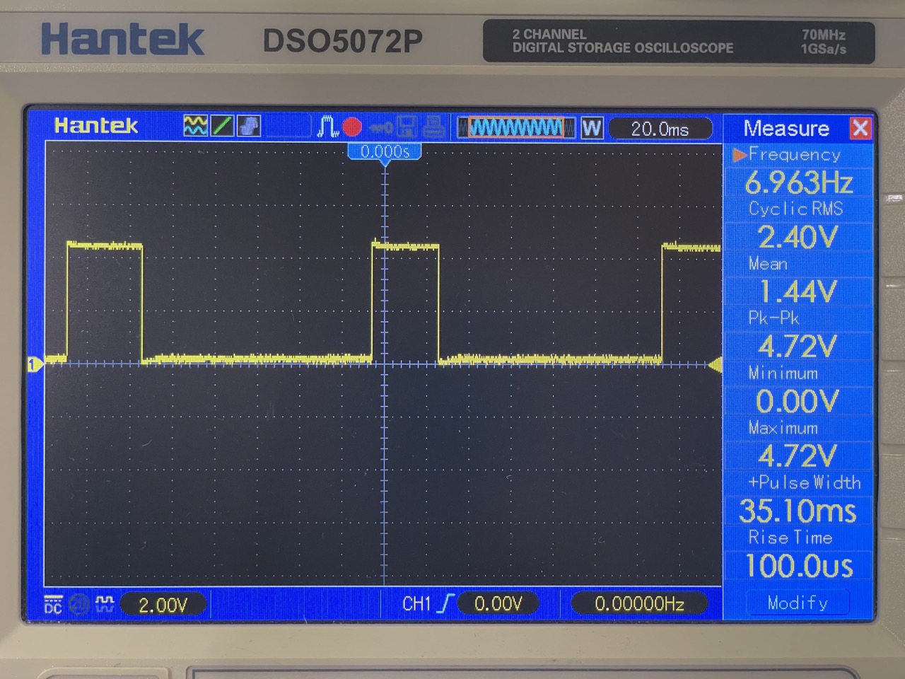

Now that I received a 3-pin cable and the 555timer module, I made some progress. The waveform photo shows the output from the cadence sensor--roughly 7Hz, 25% duty cycle, 4.7v peak. I hooked the 555 module to the eBike's 5v supply and adjusted its output until it looked similar--but this did not trigger the motor, because the output voltage of the 555 was only ~3.6v. I used a 9v battery instead to power the 555 module, and the output square wave rose to ~6v, and that worked perfectly to trigger the motor. So, I've ordered a small DC-DC boost converter, and will continue this project when it arrives.
