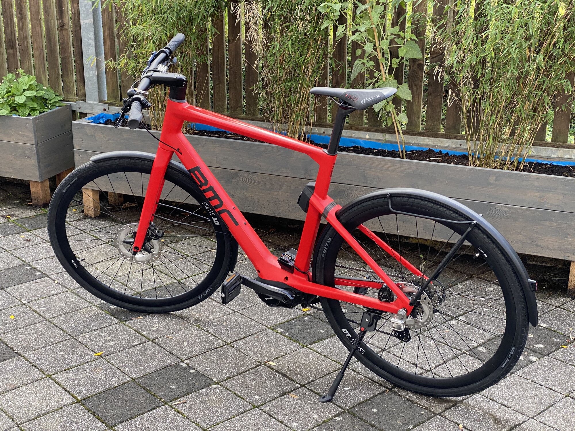

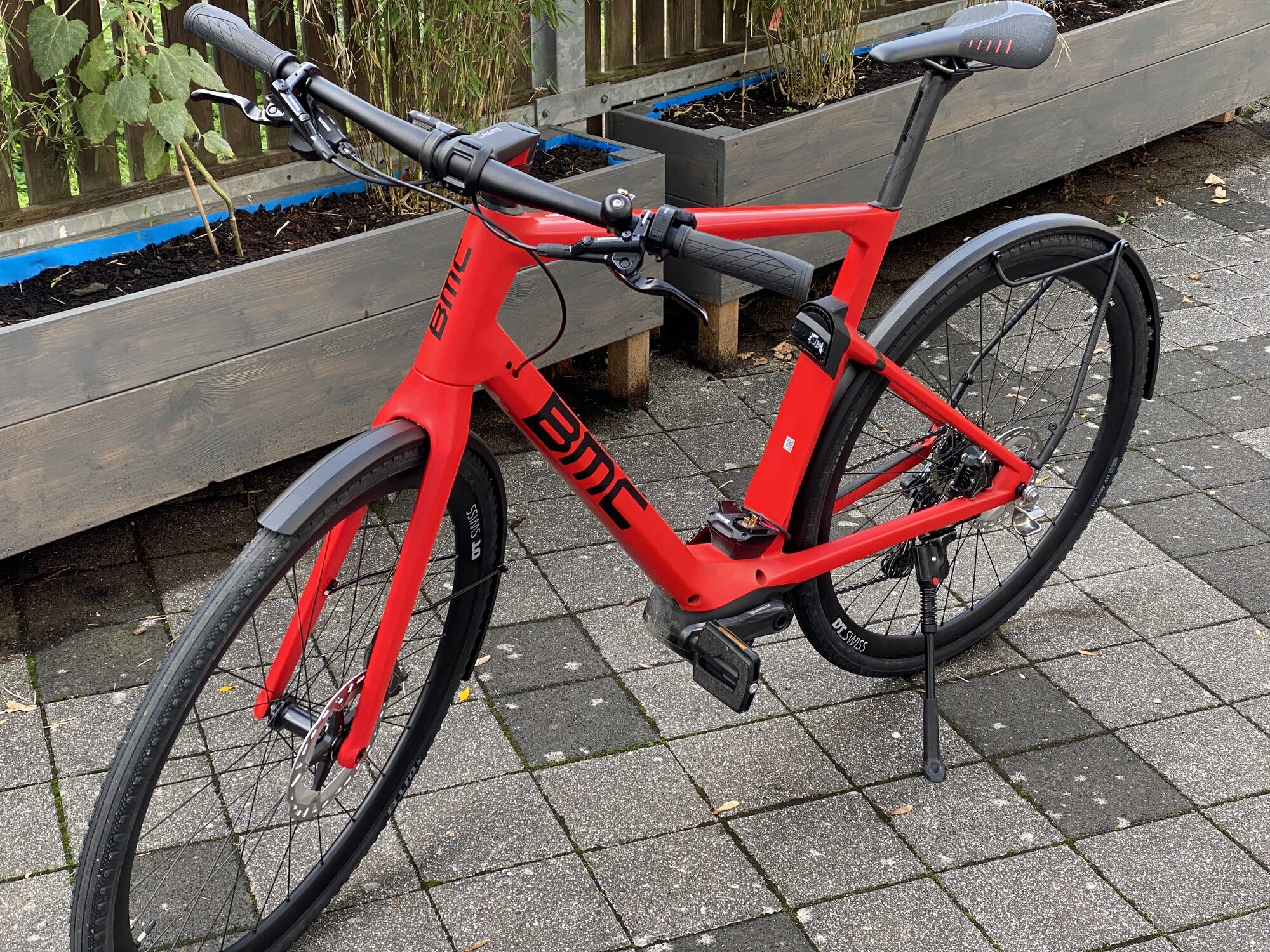

I have finally received the herkelmann wingee fenders today. Very easy to install. What do you think guys?
Dear gerardo.garcia, could you tell me which size your tires are? I just bought the Sport LTD and also want to buy the Wingee. I just don't know which tires will fit as I want to have some tires like Vittoria Terreno Dry or Schwalbe X-One Speed Performance. I'm considering 35 or even 38 mm width.
The tires on your pictures (the black ones) seem to be well suited for the Herkelmann Wingees. Maybe you can tell me the model of the tires as well.
My bike originally came with 35mm. I changed them for the shwalbe marathon supreme evolution, those ones were 38 I do believe, those are the black ones that u mention.
Currently i have (theres a picture as well of them here with the tan sidewall), the WTB byway in size 40
my wingee is size 41 so this is the maximum i can put, but keep in mind there are even bigger versions for wider tyres.
But having in mind you have the sport version probably you are looking for the same wingee width size i have

Oh, I didn't have the WTB byway on my radar. They seem to fit my needs very well. How do they feel compared to the marathon supreme or the stock tires? Do the byway fit well with the 40 (?) Wingee. Are you riding them tubeless?

For the Wingee, could you send me all the choices you took for the screws etc? I don't know what to order.
I think I will go the same route, taking the WTB Byway and the 40 Wingee.

I just fitted the WTB Byway and the Herkelmann Wingees. Doesn’t add to much weight, neither physically, nor optically.
It was quite a hassle to get the Wingees attached. But I’m quite happy after the first testride. And after all this is my go to bike for everything, driving around my son, visiting clients and doing sports.
