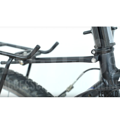

I see. It seems similar to this, which I fear would not hold very tightly (the seat stays are not fully round).
However, I found something very interesting that could work with minimal effort and cost, a 10 € seat post clamp replacement with rack attachments :
I will give it a try and let you know how that fits.
Does it work ? I am also struggle to find a solution to install the child seat on my BMC AC AMP, so you're my last hope :)
