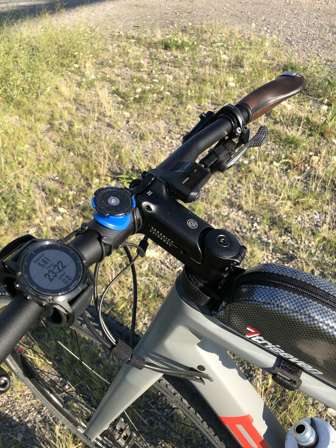

If you would have asked me about the suspension stem before I changed out the tires that came stock with the Sport I would have said a definite 'yes', but with the somewhat larger volume tires and even more so running less psi, it's more than tolerable, to my surprise I might add. So other than going over paved over tree roots and such, not so bad at all. You got me thinking though 😁
After a little research on the Shockstop the only conclusion I could reach is that it's a no-brainer. Ordered the +/- 6 in 100mm....same length as current stem. Thanks @bob armani .
That's great! Looks like an all around great product based on many reviews. I have also seen handlebar kits that are made of materials that absorb shock and vibration. Hope you get great results from your new purchase.
Ended up going with the 90 mm size since that gave me the slight elbow bend I wanted and just tad less forward position. It works as advertised and I get now why the reviews I read were pretty glowing.

Looks awesome and comfort is key. Happy for you this is a useful add-on. I see you have Garmin on your bike with an additional mount. I have the same setup. The Garmin305 watch with handlebar mount and the Garmin Edge 800 which I recently purchased. Currently my favorite accessories.

Fenix 5 Plus. I use it with the Garmin Connect phone app and it covers all the bases for me. My photo did prompt me to give it a cleaning 😁
