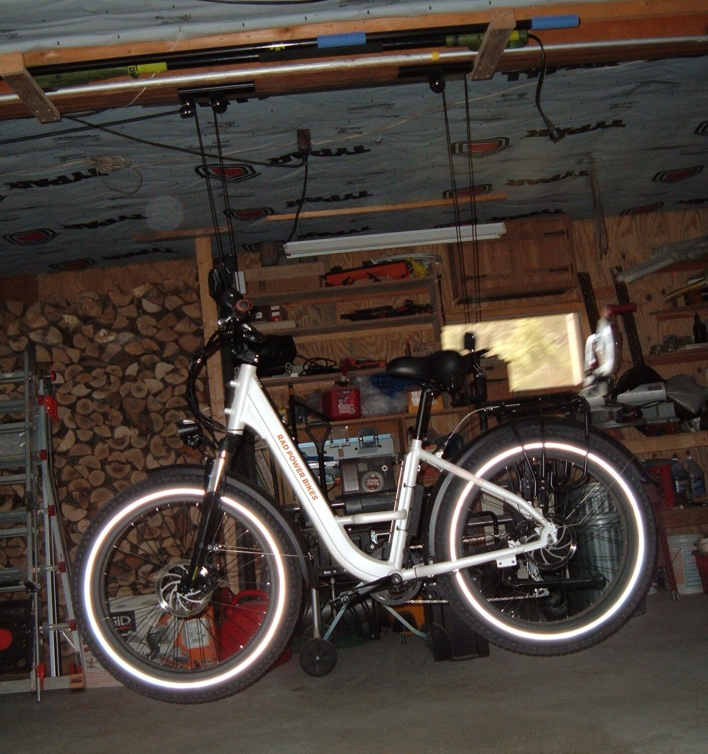

IF you have a shop or garage this is a very inexpensive way to lift your bike off the floor to work on it. I just used it for the first time today to clean and oil my chain and it worked great. It's designed for storing a bike but it's an inexpensive way to work on one too without having yet another work stand in your shop to be in your way. Costs about $25 on Amazon and is rated for 100 lbs.

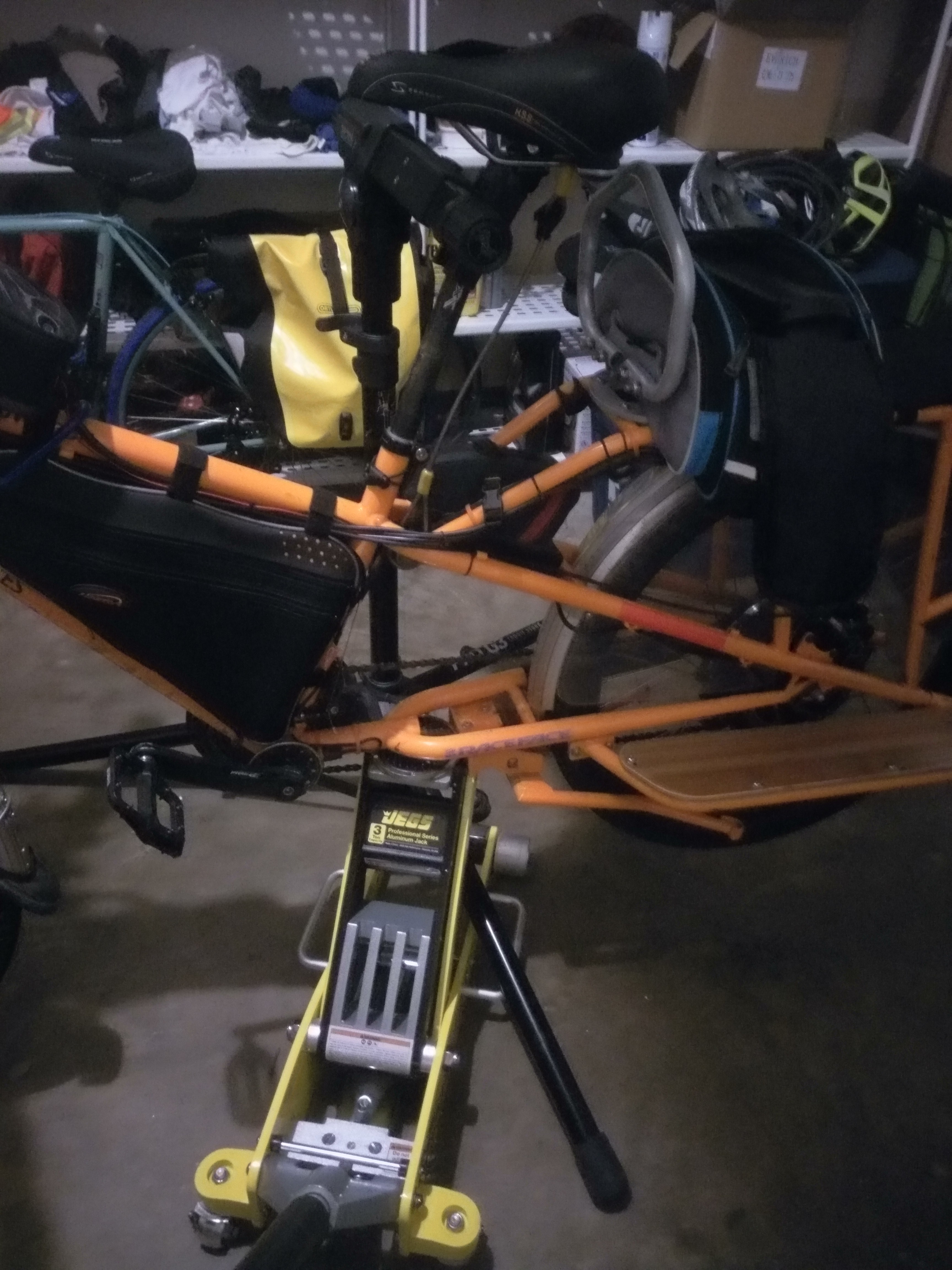

While most of my e-bikes are around 65 lbs, its a pain to lift them to my bike stand. The Radwagon is the one that is hard to work on weighing in at over 100 lbs with both motors.
Now, I use a JEGS aluminum 3 ton hydraulic jack and a ordinary G3 bike stand to lift my dual motor Radwagon. The jack lifts the bike and I can bring the stand over with one hand and clamp the seat post. Once its locked in, the bike doesn't move at all. Its good for removing the rear tire for cleaning or when I need to true my wheel. The jack is probably overkill, but it makes lifting the bike a piece of cake.
Ool
The jack weightJks about 58 lbs so its pretty light.

IF you have a shop or garage this is a very inexpensive way to lift your bike off the floor to work on it. I just used it for the first time today to clean and oil my chain and it worked great. It's designed for storing a bike but it's an inexpensive way to work on one too without having yet another work stand in your shop to be in your way. Costs about $25 on Amazon and is rated for 100 lbs.View attachment 52670

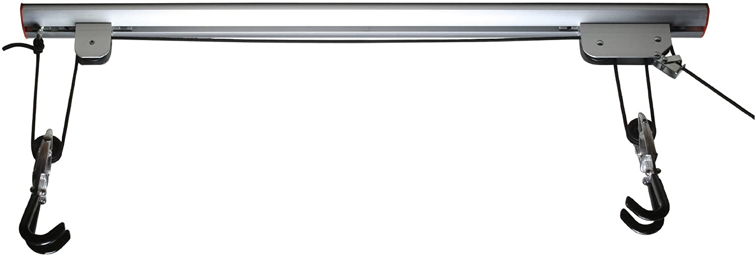

Nice bike lift... here is another version that includes an integrated mounting track. ;)
That would definitely work as a lift for storage but working on a bike that is just hanging does not give you much leverage when you are loosening tight bolts or torquing them back down. It would require one hand to hold the bike still, leaving only one hand to do the work, at least for those of us who have only two hands.
For some tasks, a hoist would be OK, like pulling a wheel or changing brake pads. For others, esp when you need to rotate the bike or apply some higher torques, a fixed work stand is the way to go.
