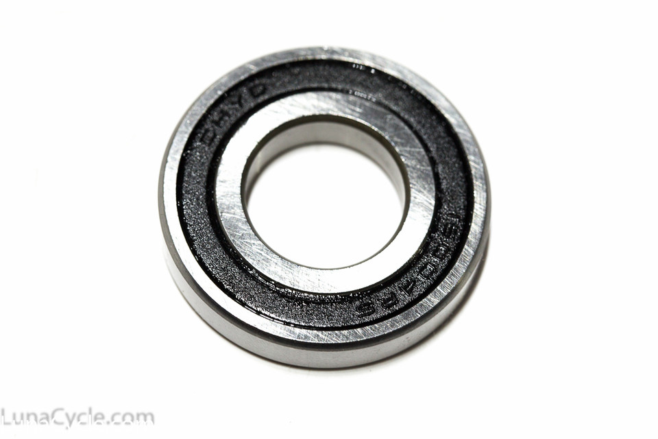

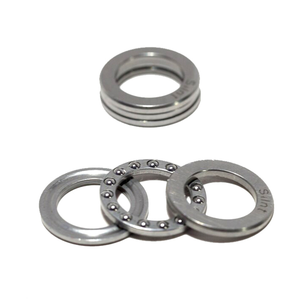

Can’t I buy bearings from Luna?

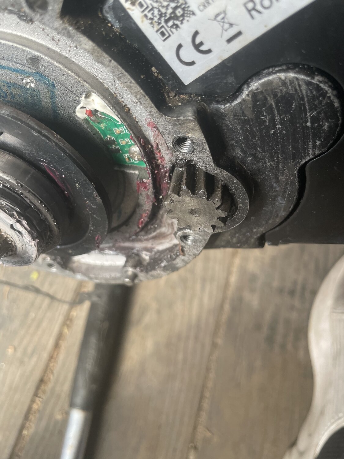

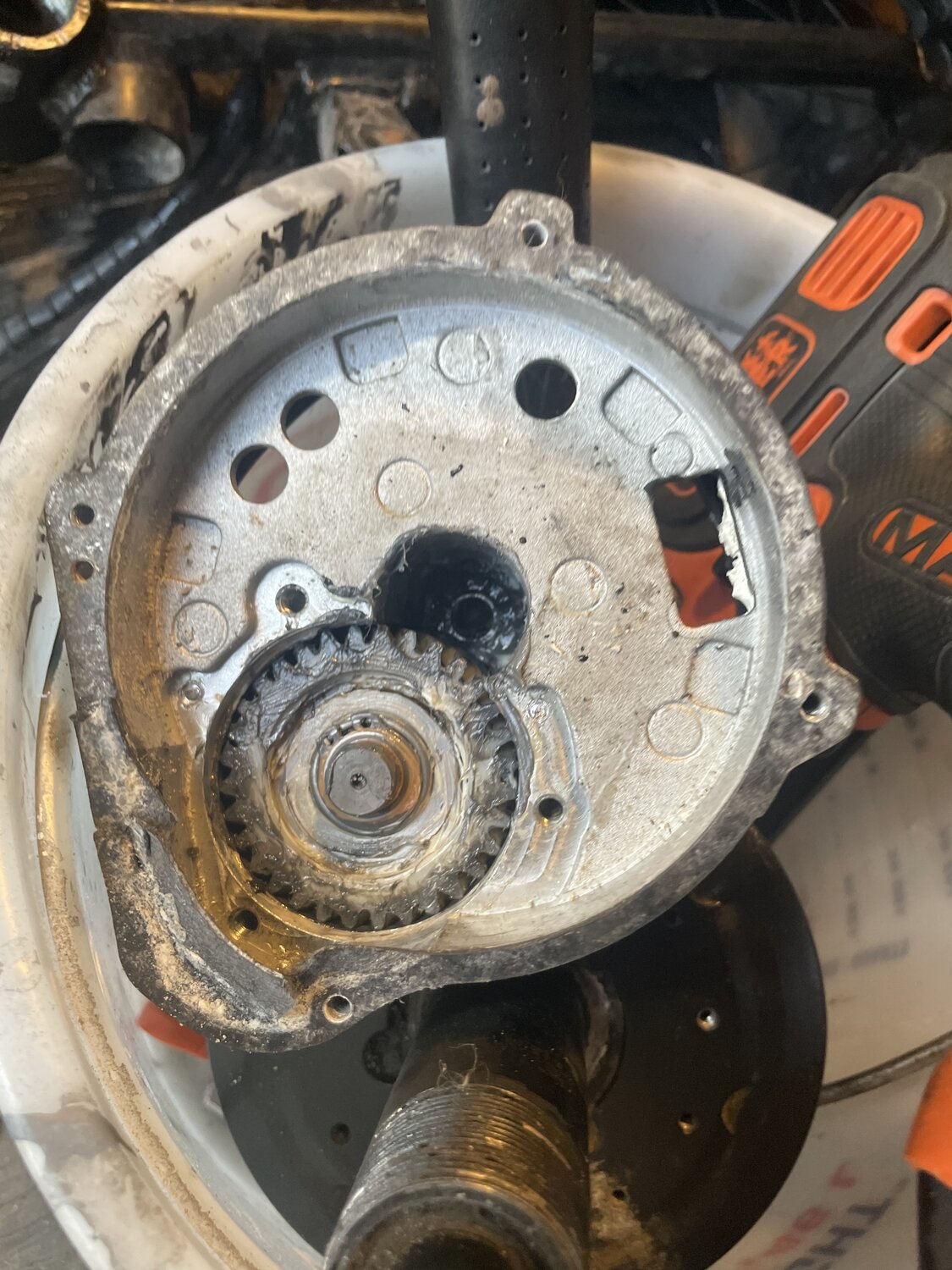

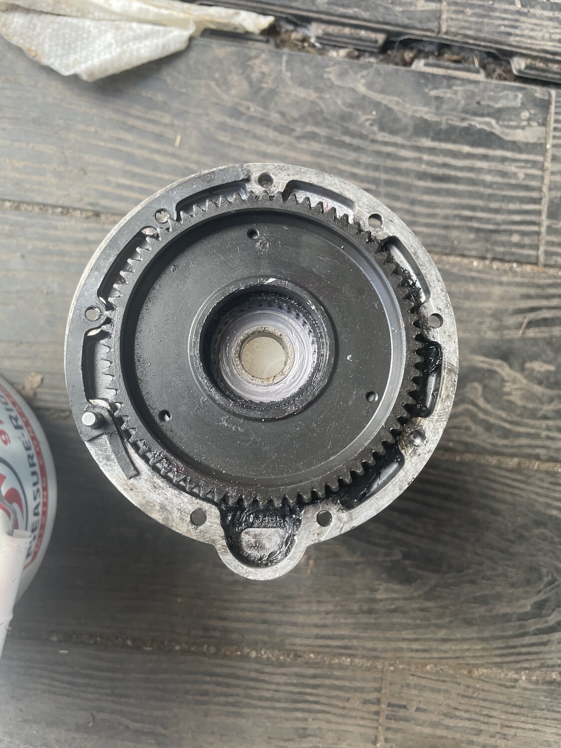

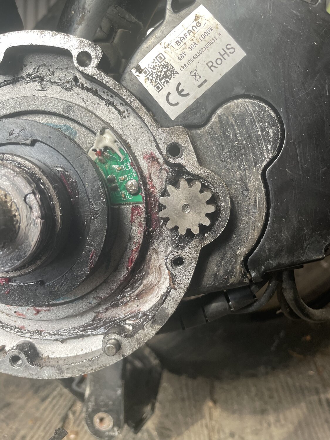

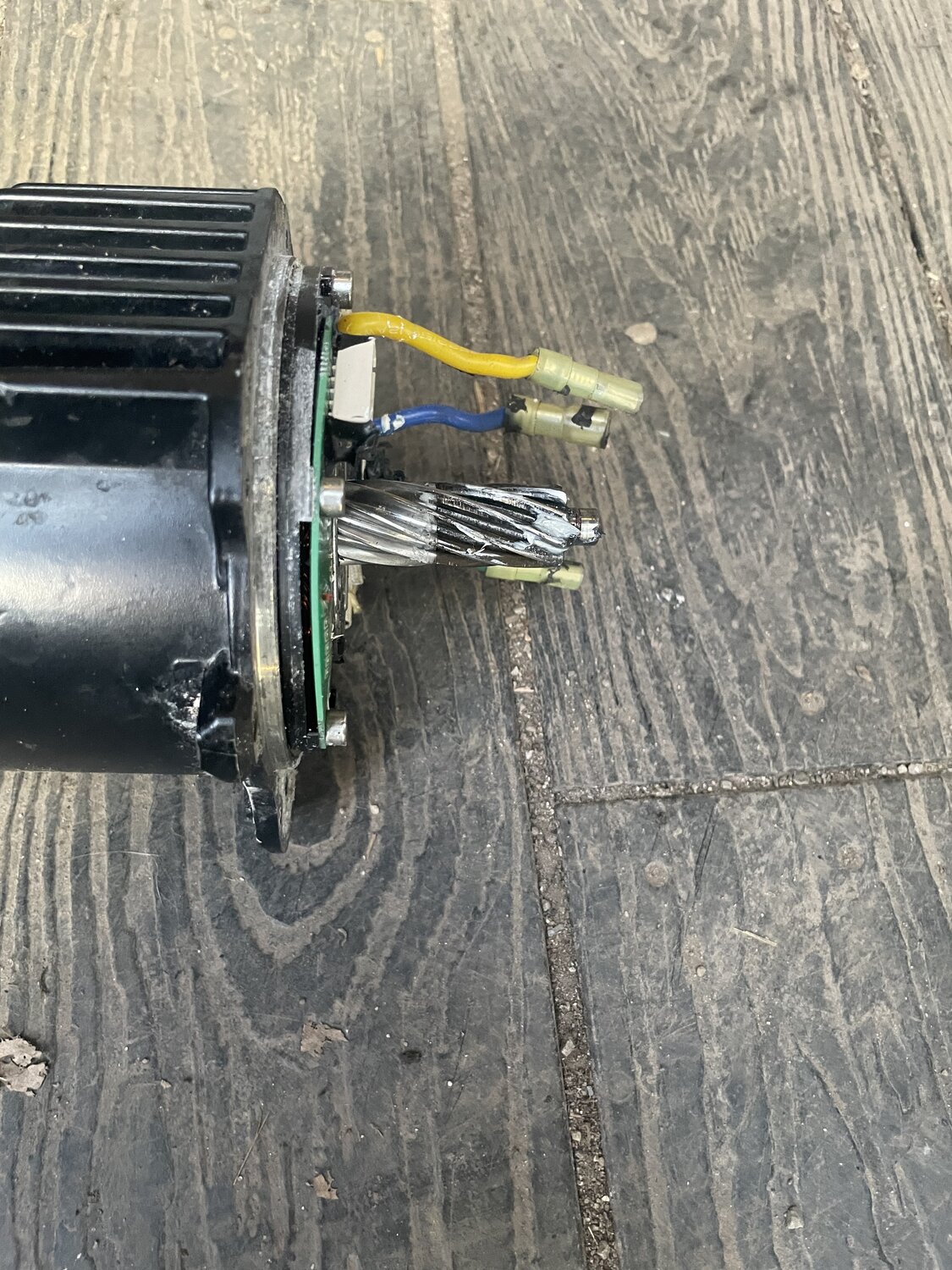

I logged in 2700 miles on old motor, when I disassembled it for new grease,I also installed new gears bought from Aliexpress however with the new gears during reassembly the cover plate where the controller is on the drive side. New gears and new bearings were not fitting properly in the holes.
Long story short I took my rubber mallet and smacked it a few times and smashed a 100v capacitor then I snug everythang with my Hilti screw gun and motor was not working after that.
I learned long ago to have patience with assembly... of Everything
Powered screw gun a definite no no as you won't feel something is wrong until too late.

Rome doesn’t have a BBSHD. At least that’s not what he’s pictured.
3 piece set is Bafang the press fit is off the shelf.
