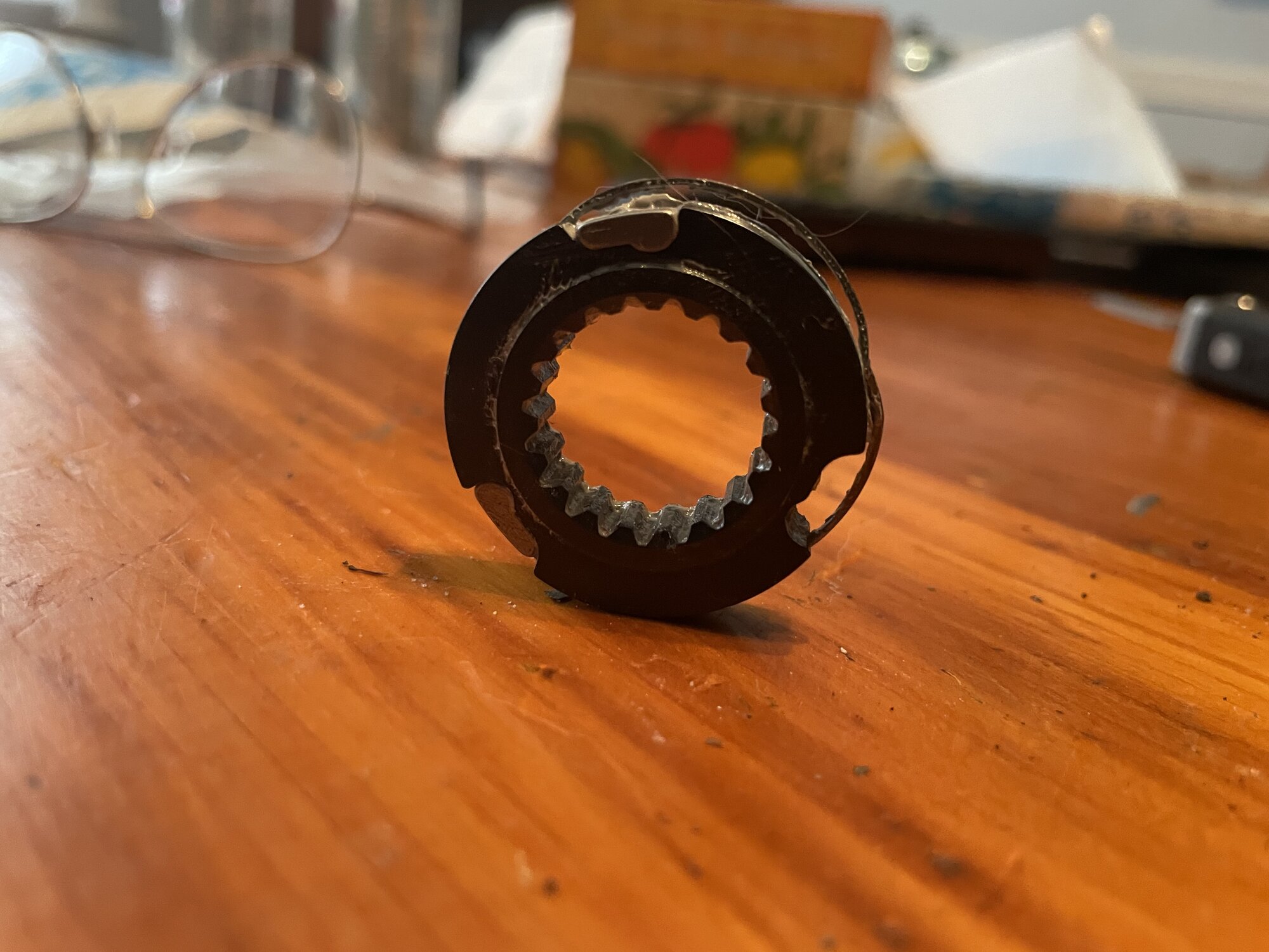

I just put a clutch in and (what ever makes it’s skip or shake or what ever it’s doing) destroyed the clutch.
So if it was shaking with a new clutch I’d have to think hard about what else it could be. Or buy a new one

What did the previous clutch look like? Was it "destroyed"? Do you still have it? If "yes" send pics.
So, the current clutch in the motor is a "destroyed" clutch?
When you say "destroyed", what do you mean? Can you share detailed pictures of the "destroyed" clutch (especially the pawls).
(I just destroyed the clutch (pawls) in my rear hub. The teeth were sheared off.)
Can you share pictures of the inner ring gear teeth that the clutch pawls engage. They could be sheared or worn.

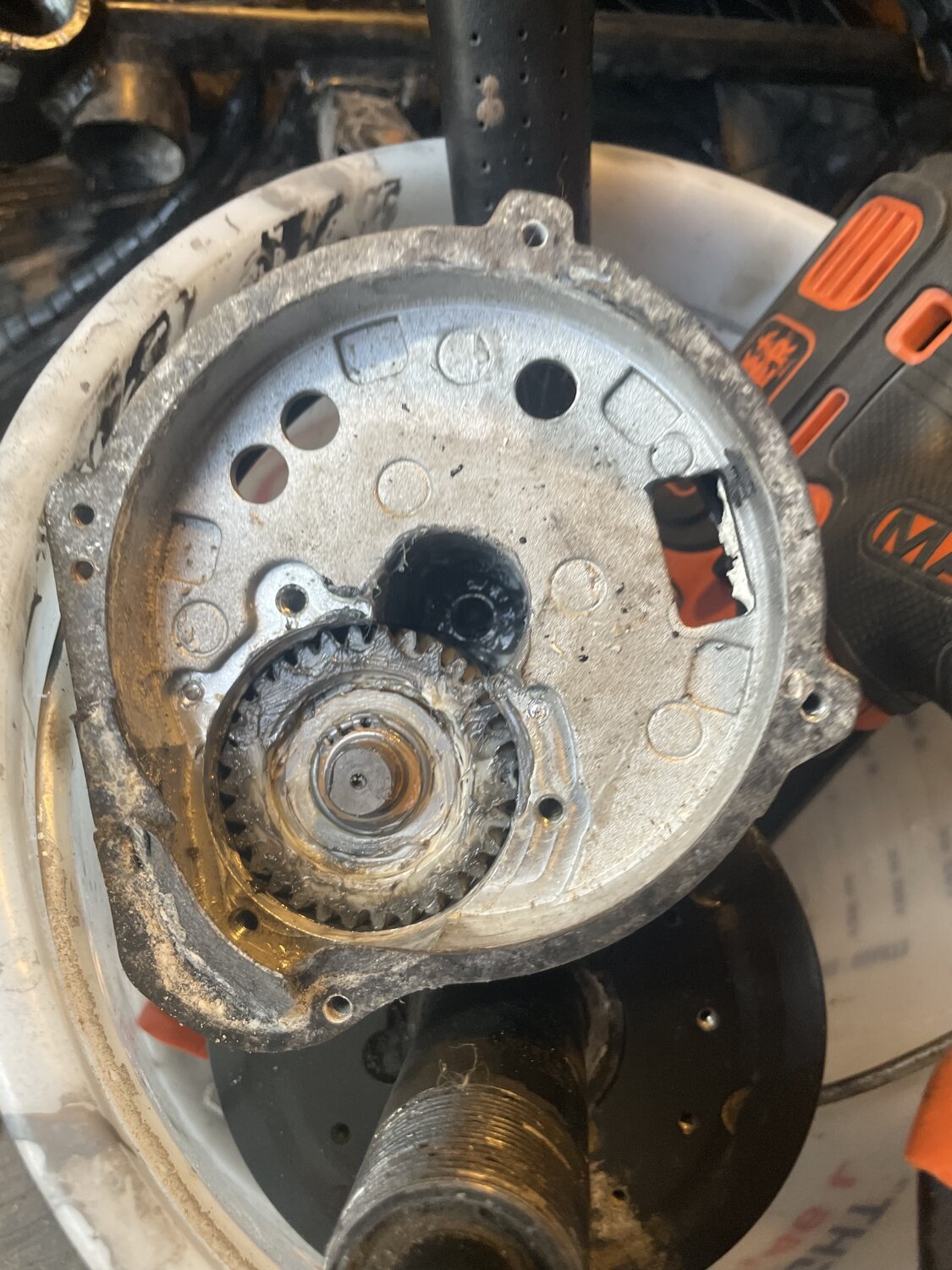

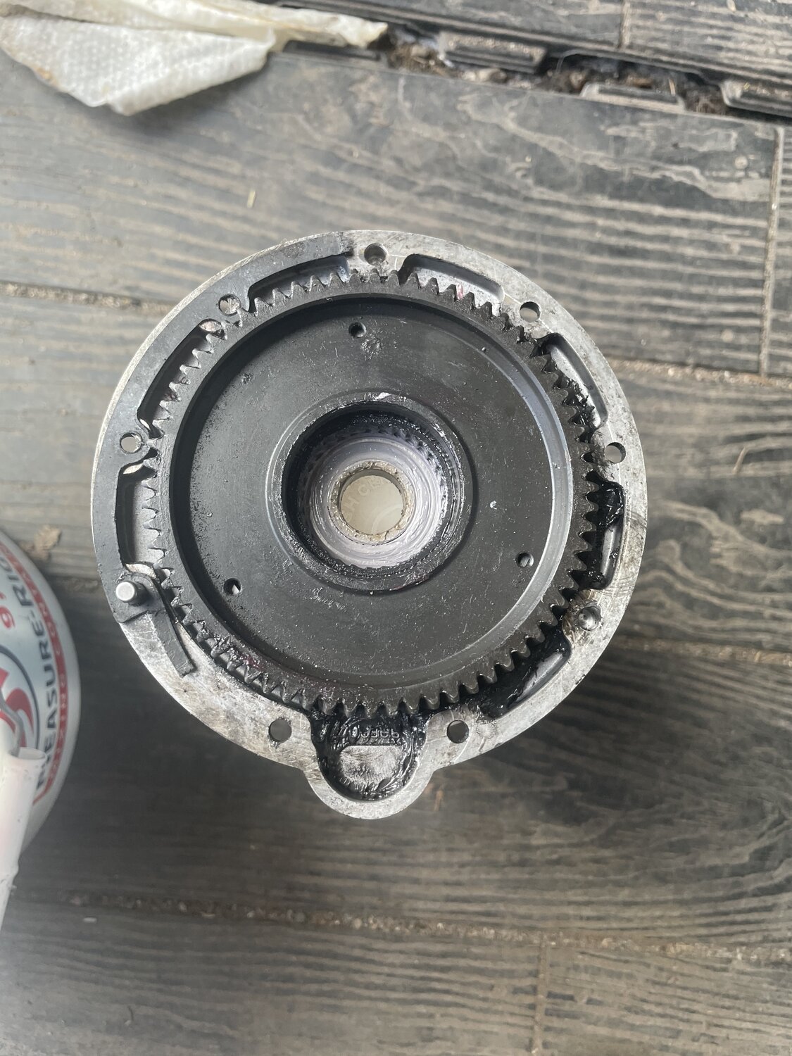

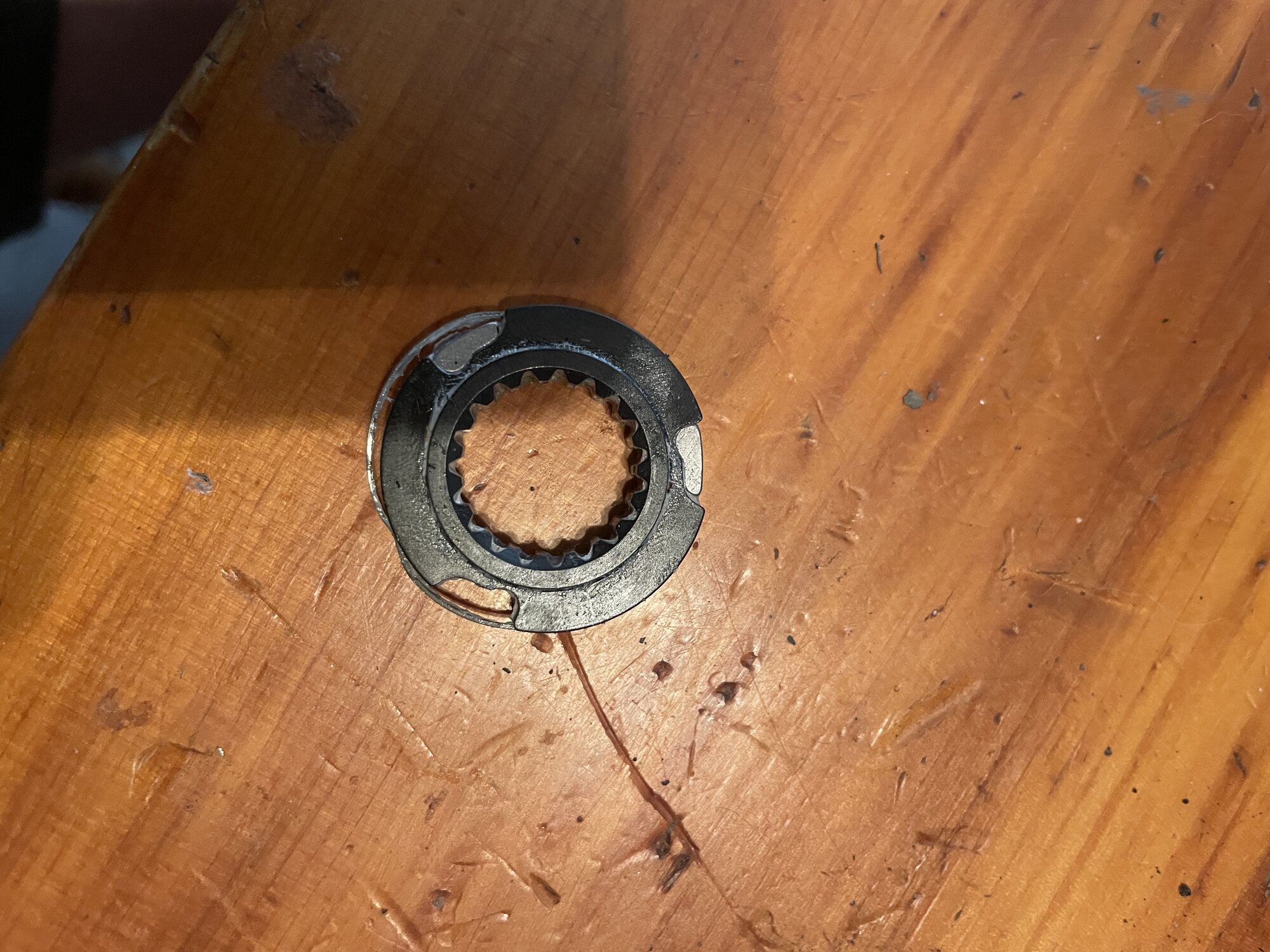

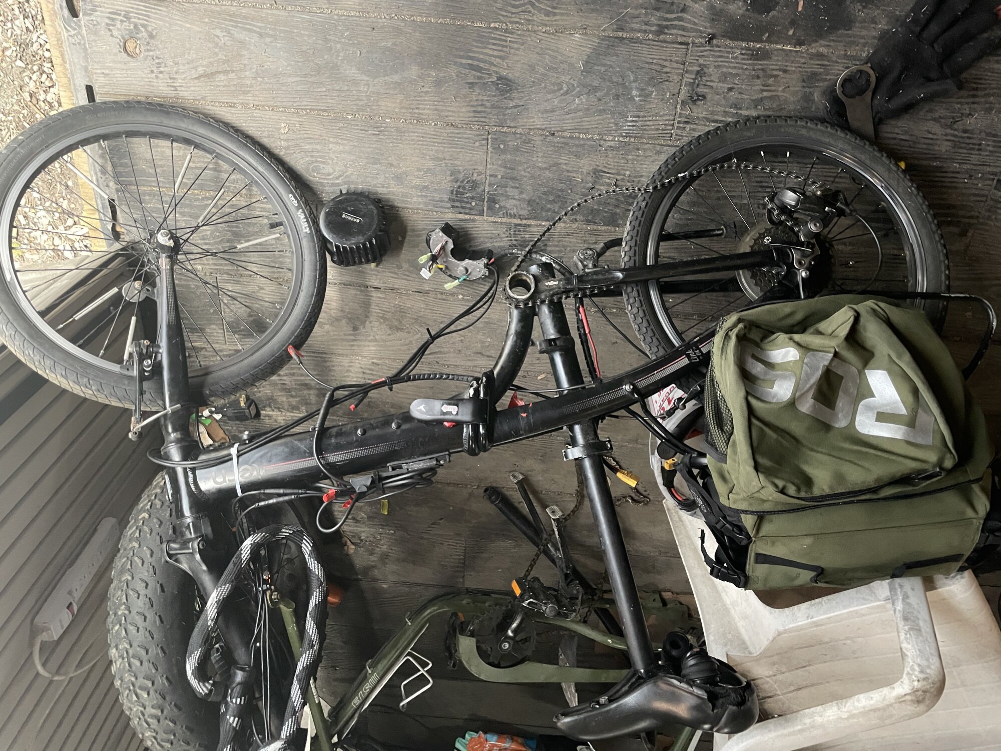

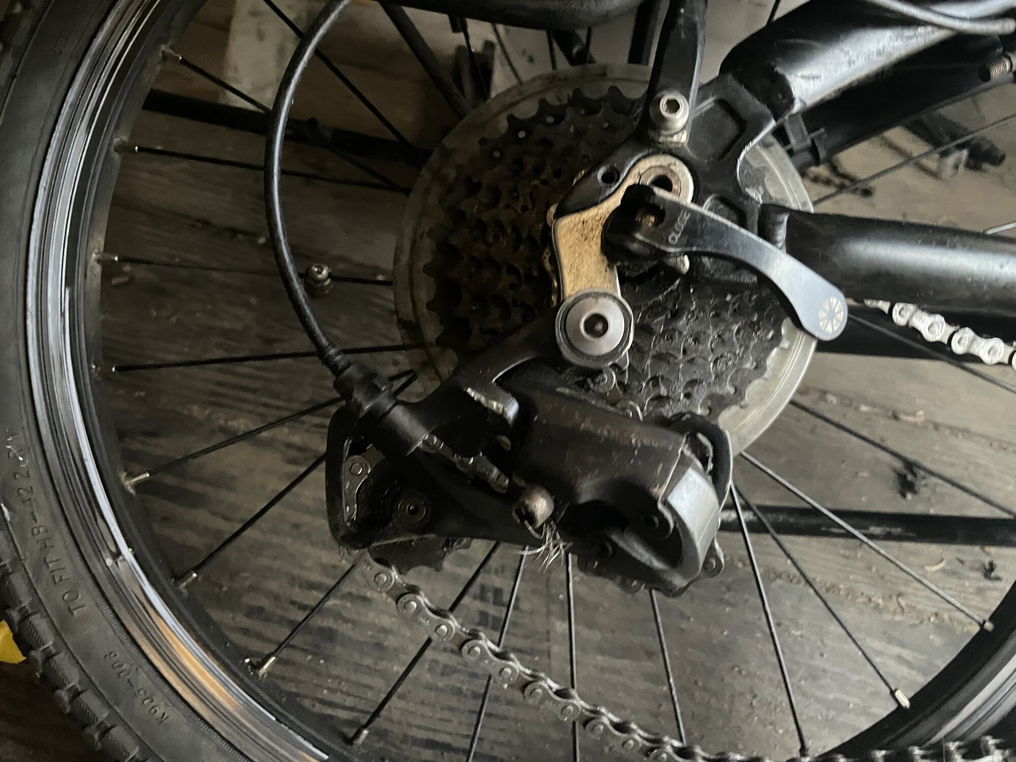

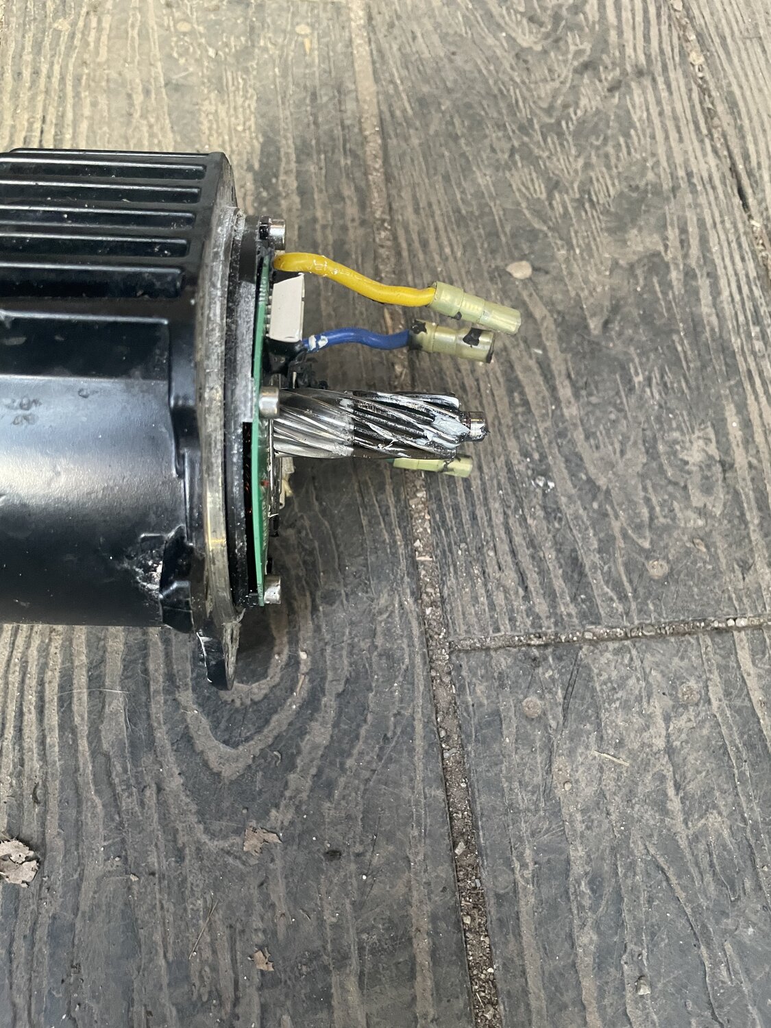

So I bought it modified by a guy from Boston, worked great for a year, (I use it a lot year round)
Here is the gear and other pics I took

This bike is a Bbshd mid drive.
All the gears look great.
New clutch, new chain ring, new controller, and the bike shakes or skips when I hit the throttle, and the chain falls off if I put weight on it (It runs smooth if no weight on the bike) . I’ve taken this apart. To the core.
Any suggestions?
Why does weight cause it to skip/shake/ chain falls off?

Your chain is entirely incorrect, or too long could be the problem.
Give me a close-up photo of the numbers on the chain links and master link, I'll tell you what's up.
(After you've made sure your derailleurs' contracting correctly - clutch is on, etc ....), post photos of your chain (set on middle cassette cog),
showing the area from the complete derailleur and cassette, to the ring-gear - entirely but as close-up as you can get to just that.
I'll step out on a no BS limb here. This sounds 2 problems.
1. You have a balancing weight on a spinning (motor) part that is missing/ removed.
2. The spider or ring-gear is not true and is wobbling.
That symptom would increase with stress applied.
Eliminating those issues, you'll know what it isn't.
