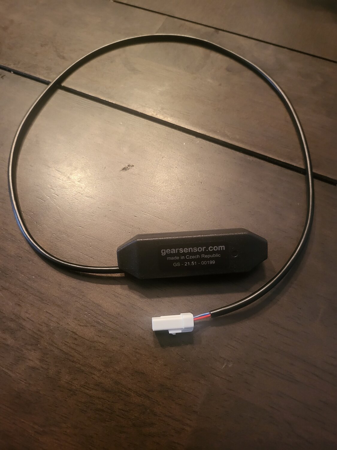

Hi I have a Bafang m620 gear sensor and was trying to mount it up near my shifter and run the cord through the frame with the rest of my wires but the cord doesn't reach , does anyone know of a extension adaptor I could use for it ?

Sorry, can't help you with the extension. How are your soldering skills? Maybe splice in a section long enough? Or maybe mount the switch to the rear of the motor?

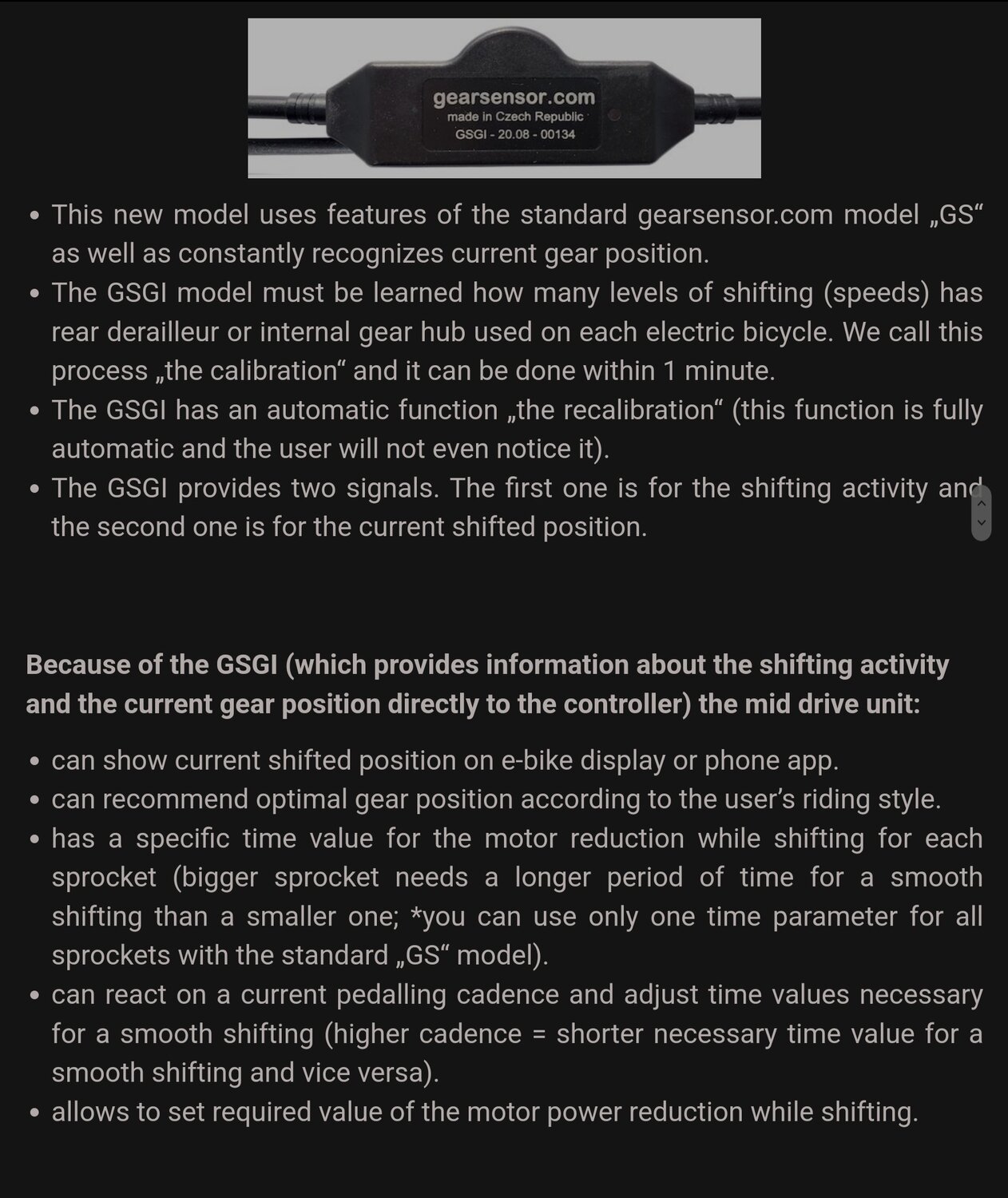

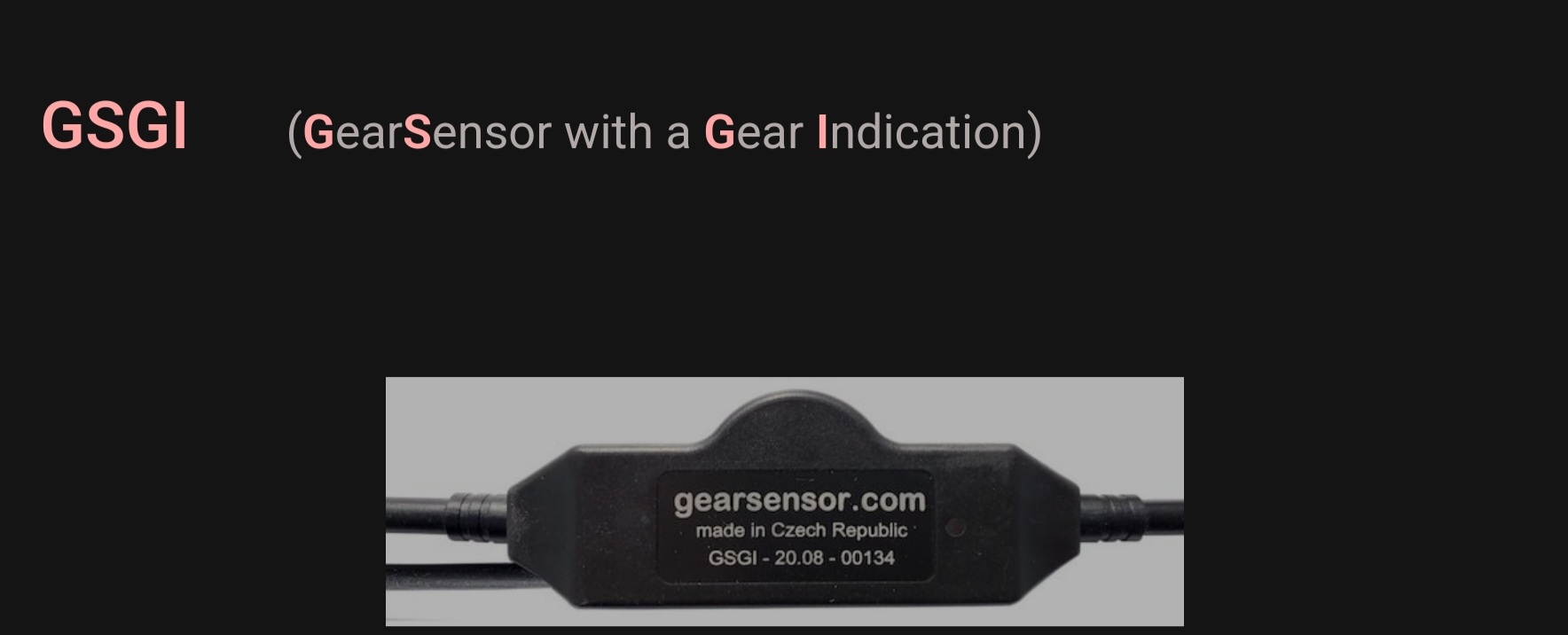

I think your meaning something like this ? They do make them if so I just had no need for it only the shift sensor part

Wow, if that thing does have the ability to be a gear indicator, it would be the first I've read about anything with that ability. I'm not sure how that gear information would even be displayed on any of the Bafang displays I'm familiar with? Would need to see a little more info about it to believe that's not a misprint or the result of a misunderstanding...
Both the controller and display would need to be compatible.
That said, it would be nice but perhaps a bit of overdesign for a mostly non existent problem only introducing further failure points.
It works like a shift sensor so I don't see a further failure point as all it's doing is having the shift cable run through the sensor housing , if the sensor fails the shifter will still work
