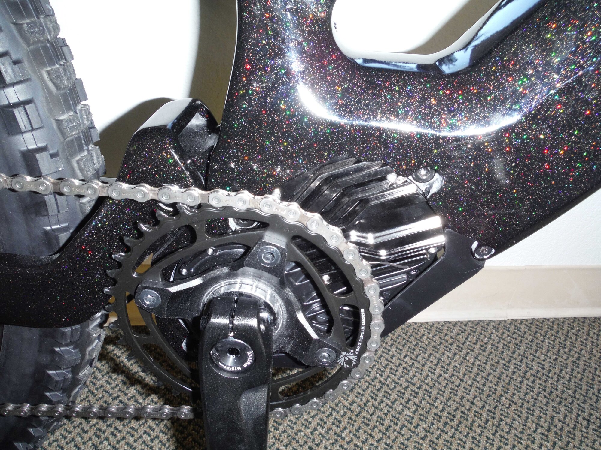

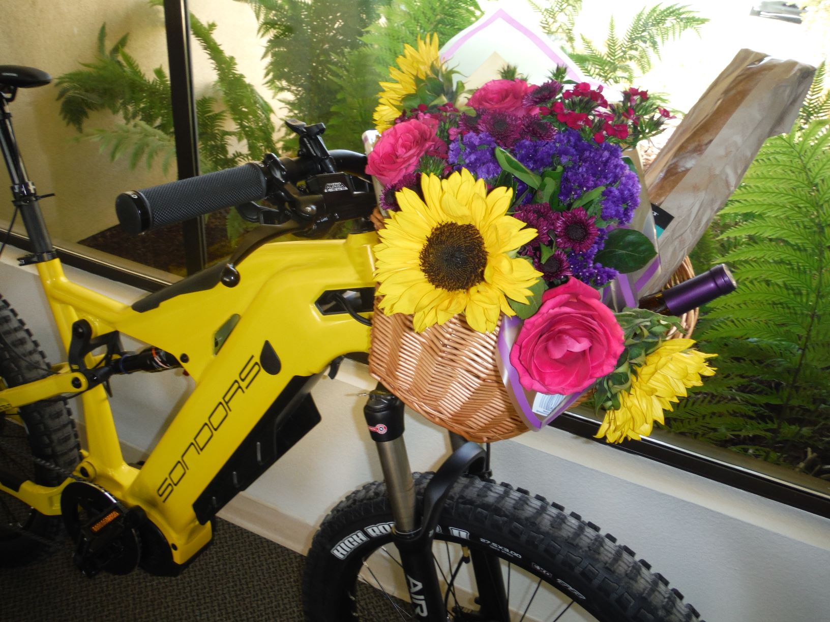

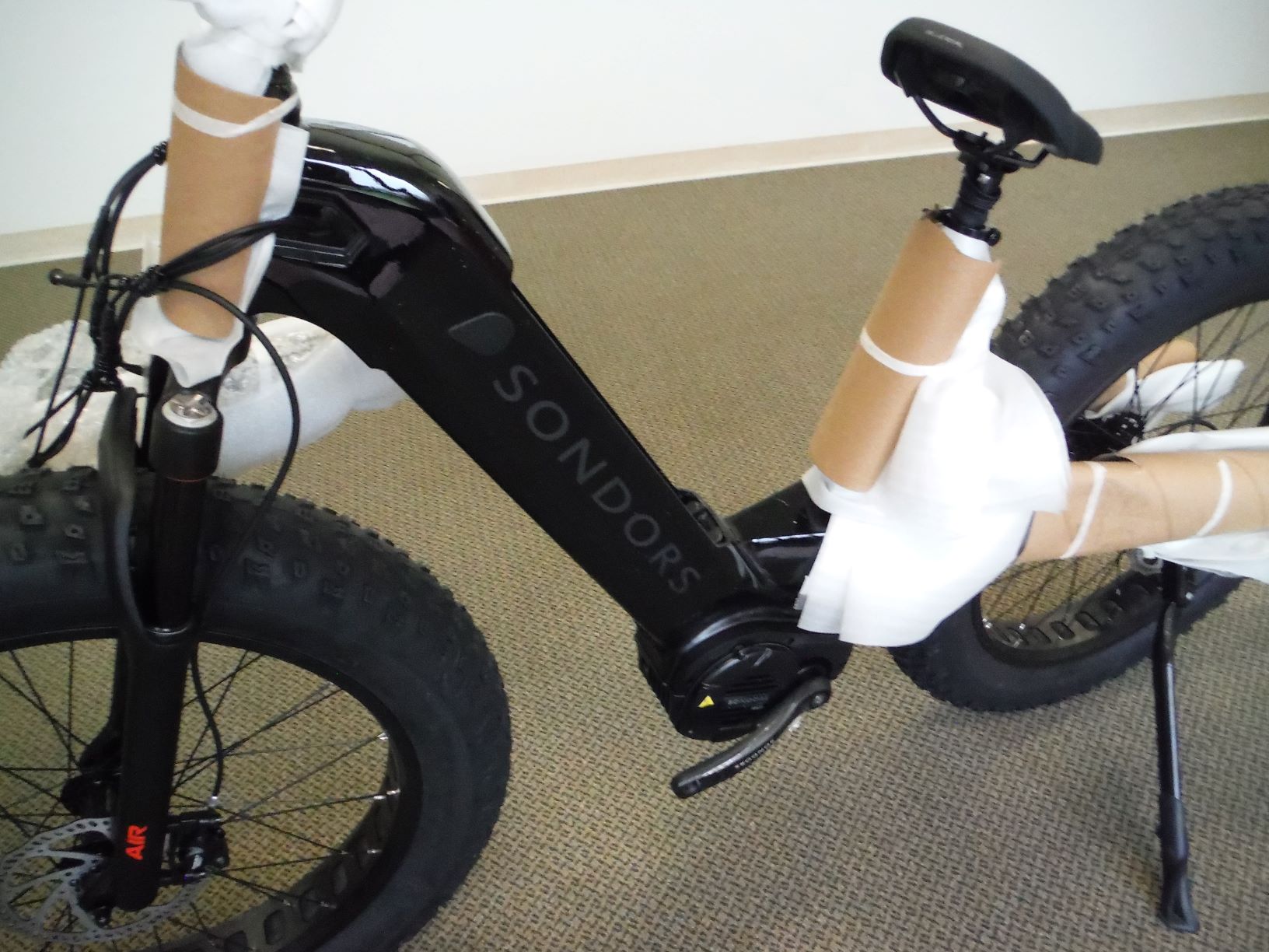

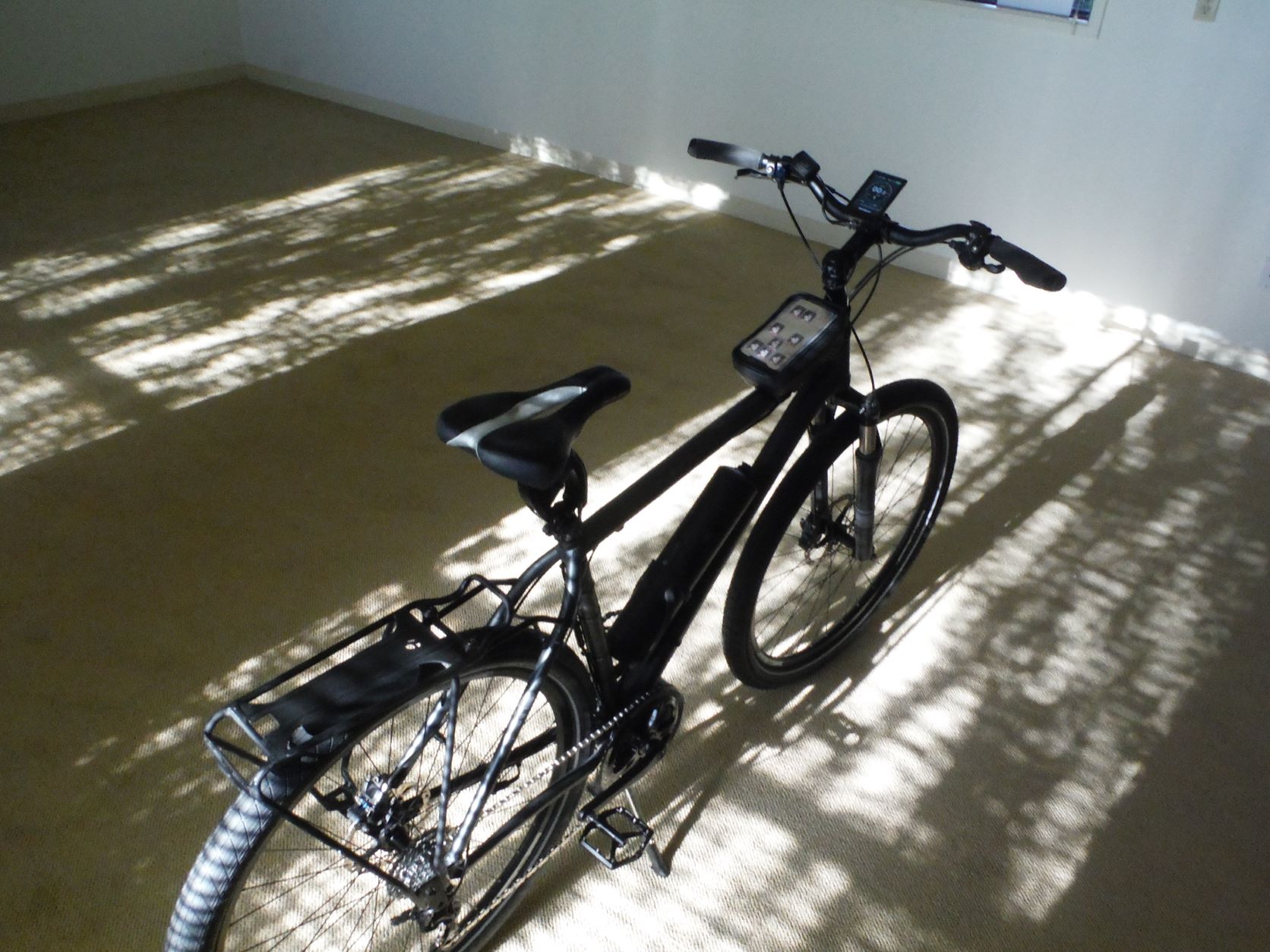

These first two have the gear sensor burried in the bottom of a pit under the battery. I upgraded their cassettes, derailleurs and shifters. Those gear sensors were a pain. I do Bafang builds sometimes. They just are not very interesting to me. Over run is to make for a smoother ride. I find it imprecise. I like real time action and control. That is me in the fourth photo. The last two are a BBS02 that is cleaner than most. No cutouts & no gear sensor. I love the basket on the Rockstar! Oh, check out the phone apps photo.
