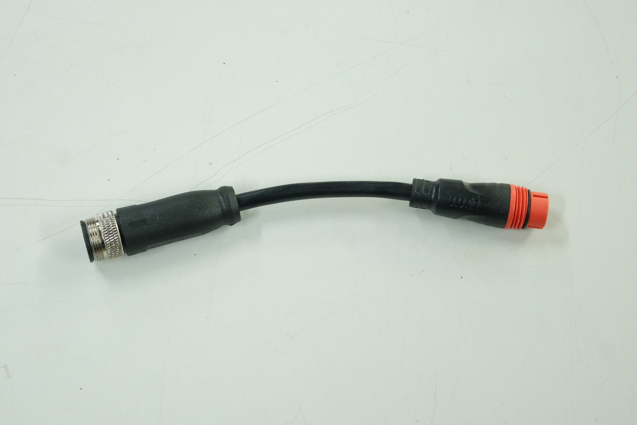

So if the motor side has an L1121 male end on it, then I'll need a female L1121 connector to ? for the Baserunner L10 adapter cable?
All controllers have female on the controller side, right? Because all hubs have male connectors on the hub side, right?
Baserunner/Phaserunner L10 (left pic below) seems to have a female L1019?
So I guess that means I need a Female L1121 to Male L1019 adapter cable?
This it? This look right? I think that's it.
