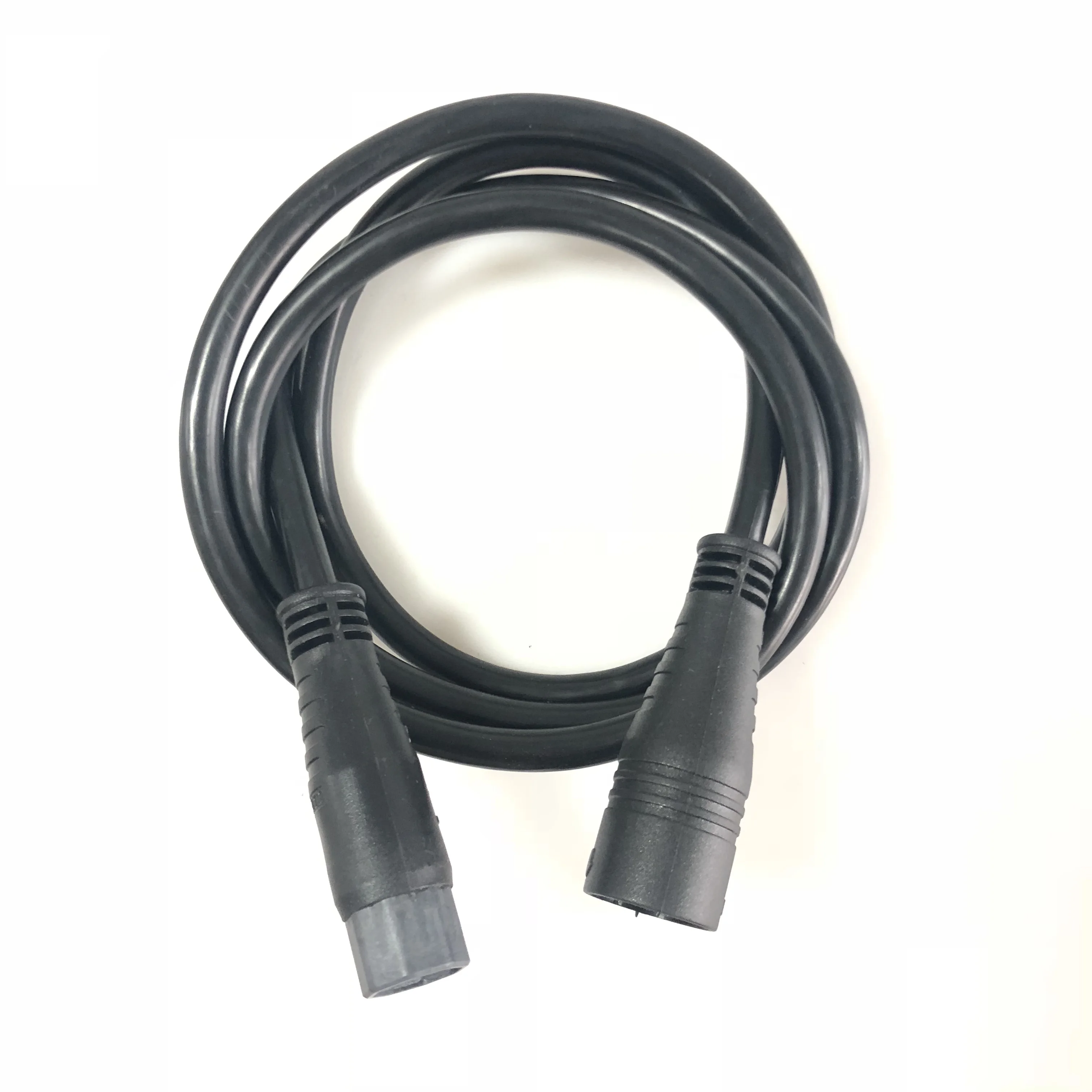

The only extension I could find was a bloody 44inch extension also from electrobikeworlds website. That was ordered on 7th July and still hasn't even left the damn country of origin (You guessed it, CHINA!) Plus the website owner who replies stopped replying when I mentioned about it taking so long and he tracking not moving for a couple weeks.
So finally my question to other Bafang experienced owners, where do you buy your spare parts and cables from? Also if an extension cable is not available have any of you had experience cutting the motor cable and soldering a length of extra cable to it? I will literally need to cut the plug off, cut a section of my old cable off and add it to the new motor cable , then finally solder the end plug back on.....In theory that should fix my problem but wondering if anyone has had to cut and solder cables on this motor and did they have any similar issues?

Is this the one you have on order?
Yes that is the motor extension for the high-wattage 750w motor.
I used to converse with one of the owners of that site and she special-ordered those cables. Used to have much shorter ones and I kick myself for never having socked one away while they were available.
Here is one only 100 cm long :D. I have seen them shorter and Isuggest looking on this site for an alternative. Particularly the HIGO extension sellers who often have a motor cable extension tucked in with their many pictured options.
Yes mate that's the one! It's taking ages man! Probs going to splice some cables before it arrives

I managed to take the controller unit off my bike to give up some slack to test the new motor - It works. Also when I took my old motor out of the box and pulled the polystyrene out there was a god damn cable under it I didn't see that plugs into the motor cable and runs up to the controller unit HOWEVER my controller unit can only be removed from it's protective casing, the unit itself is a bloody sealed unit!!! Such a shame as the cable was long enough and would of reached the motor cable! I wouldn't of needed the extension or to splice cables BUT as I said the unit is sealed with the chipboard being sealed in also so I can't get access to changes the connectors over :/
So I've decided to cut the controller unit cable and add the spare controller cable to make it longer as it will be cheaper to replace a controller than a motor if I f*ck the splicing up. Also I managed to get hold of some extra small crimping connectors and shrink wrap so I will give that ago instead of soldering first as I have to do it while the cables hang of the bike.
I'll post a few pics and vids if it successful on sunday.
Until then have a good weekend!
Finally got my bike going again. Watched countless soldering technique videos and crimping. I started crimping but was having issues so decided to solder!
I ended up soldering the wires, wrapped them with heat shrink and electrical tape. Can't believe it worked! Only thing is I have a huge lump where all cables were soldered lol! Thanks for the replies to give me the confidence to give it a go. I only have a photo of the cables mid solder but I will get one of the finished job when I next go round to where my bike is stored while it's been off the road.
