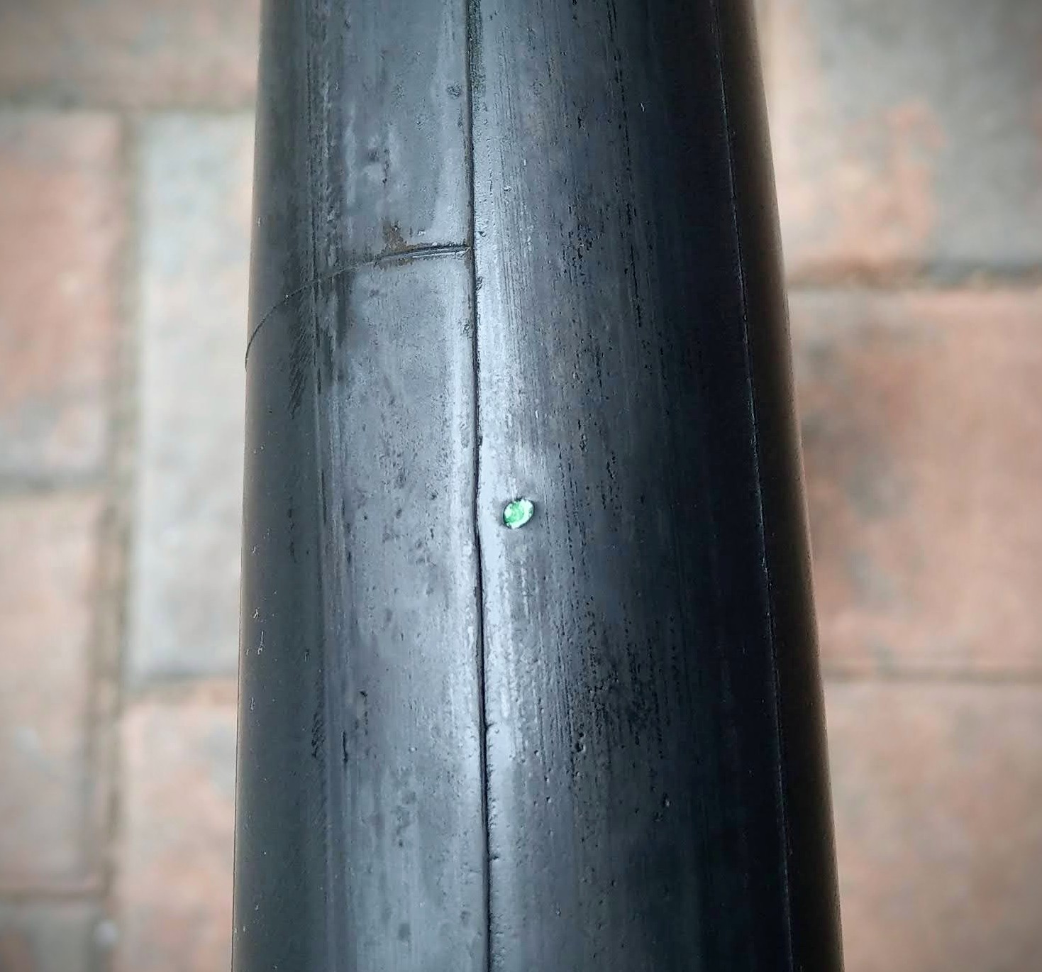

  • Slime varies. I'd say the 2 year number is a pretty good approximation. The stuff I have seen dry becomes almost like mashed potatoes. (usually a tube gets so many holes over its life that the Slime never has a chance to dry out... I'll get something I can't patch and then its time for a new tube)..
The slime never dried in this tube but that was only because Hole #7 happened on a seam and neither Slime nor a patch could seal properly over it, even with sanding and shaving.

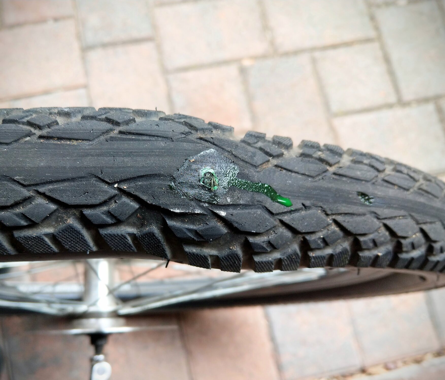

I ran over a jagged piece of metal half buried in grass yesterday about 8 miles from home.
It was about 3pm on a very hot, sunny and humid day. +90° / 70° dew point... and with a lot of hills between me and home.
It was on the rear and the tire deformed feeling like I was running over an acorn with every tire rotation... but for fear of a leak I kept about a 15mph return speed. Not only did the tube hold air all the way home... But it was still full this morning.
Thanks Mr. Slime.
I was able to patch the tube but the tire needs to be replaced. It was just about due anyway.
