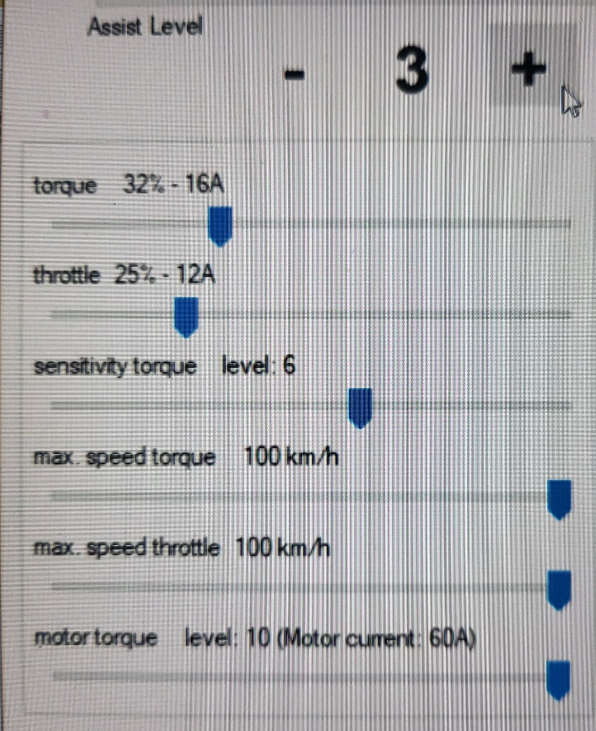

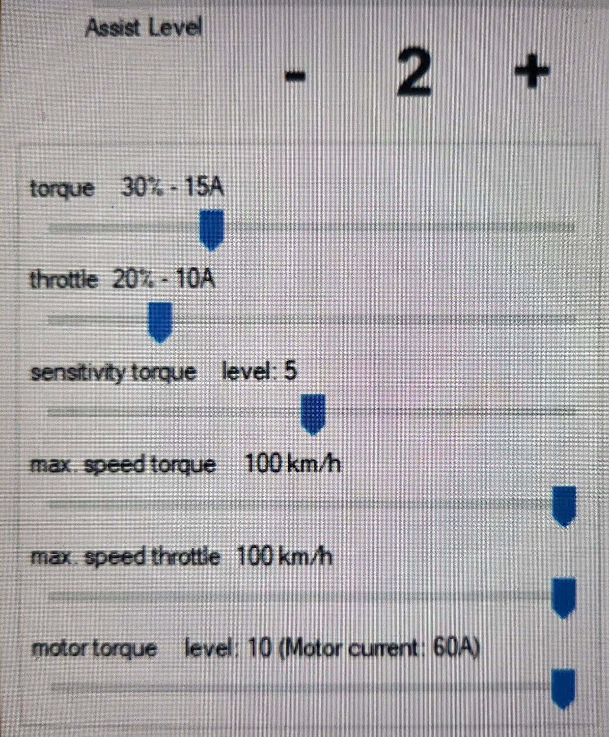

This is eco 2 and 3 from with X1 from Watt Wagon factory setting.

As I understand all the available settings are the same for any firmware as long as you use the same program to setup.
I use Kindernay XII gear hub. I use it with 44T Bafang steel chainring (the biggest one fits to my frame) and 14T SHIMANO CS-MX66 DX steel cog (the smallest one fits Kindernay gear hub). I use the biggest possible chainring and the smallest possible Cog to reduce the torque and stress on the gear hub (the most expensive part of the drivetrain). The chain is KMC X8 EPT, it may suffer from stiff links after some mileage at such big torque (squished chain links cylinders on some links jam the links walls) but after treating the stiff links it wears out over time and works OK after that initial period.
That's helpful. So, firmware is stepping up the Current - while in an 'off/on switch' throttle mode and cutting off at 4.0v.
Do you have access to 'Throttle Mode (Speed or Power)' and 'Start Voltage', 'End Voltage' settings?
It's been reported Start Voltage is 1.0V and End is 4.0V.
I don't like to ask others, show me, show me when I can do it but I'm too timid to test this cable at the moment.
For that I apologize.
For my domino SP settings should be:
  • Throttle Mode: Speed
  • Start Voltage: 15 (=1.5V)
  • End Voltage: 45 (=4.5V)
Our standard firmware could be different from yours, but our SP modes should be the same.

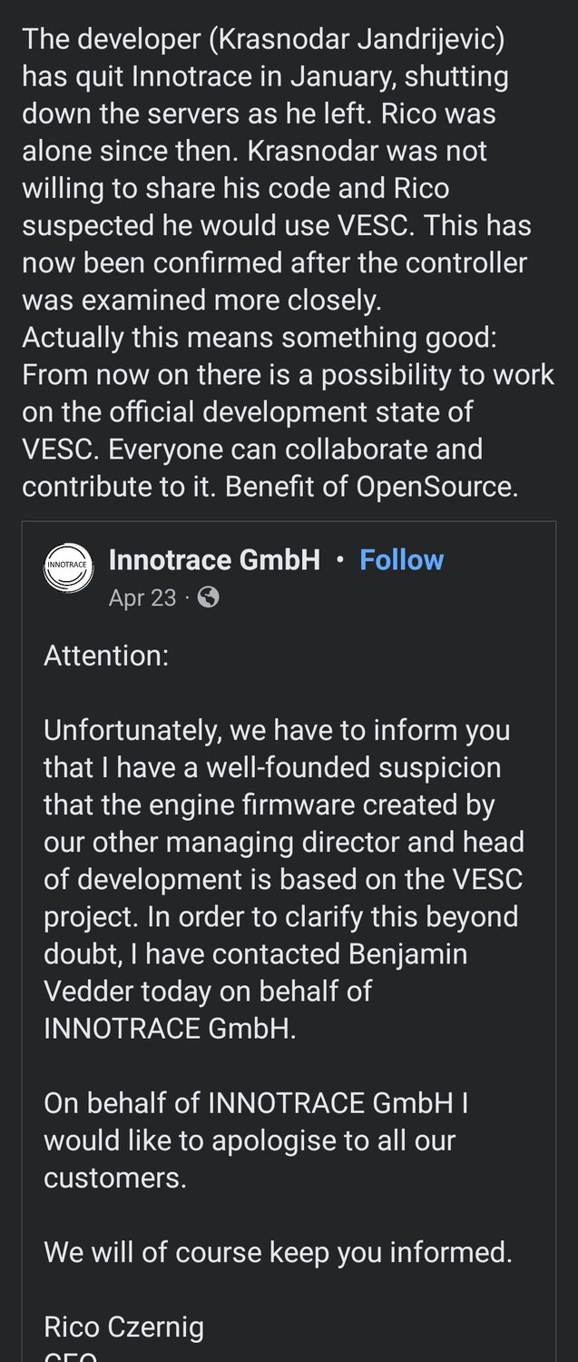

Someone is now posting on a Facebook group that apparently worked with Krasnador and Rico and is claiming a VESC app like the Luna Ludacris one is in the works
You mean Krasnodar and Rico work on Vesc app for Innotrace X1 or that person works on such application?
Not Krasnodar. The post from 'someone' was from whomever is remaining at Innotrace, and makes sense.
The biggest question is whether or not they will be paying Vedder (VESC founder/lead) to do the work for them, they will be picking it up in-house, and of course - timelines.
Depending on whose idea it was to charge 'subscriptions' to updates (which I haven't seen many, the Innotrace UI seems to not have exposed anything new over time/hasn't changed much from what I've seen), well - that model won't work any more as it will become open source. They would be able to charge for 'support' which some people may take them up on, but it's unlikely the 'server login' requirement would continue IMO.
They could probably of course, still upcharge for setting the bits for max power or something, or possibly lock some portion of settings with an encryption key, but hopefully it becomes 'properly open' like other VESC-based systems, and short of encryption of specific settings, the source code will be available which could unlock further options and improvements in the future.
This could potentially have a reasonably good (for owners) outcome, although of course, someone or greed could still get in the way, and timing is anyone's guess. It's possible new firmware might need to be flashed before a VESC option might work, which would be inconvenient, but not insurmountable.

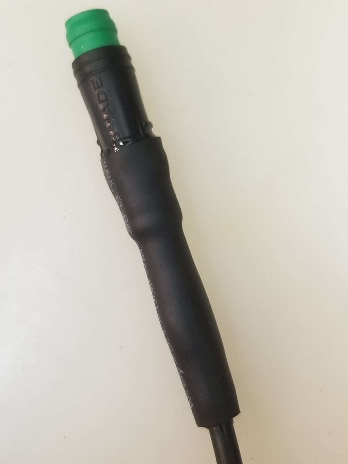

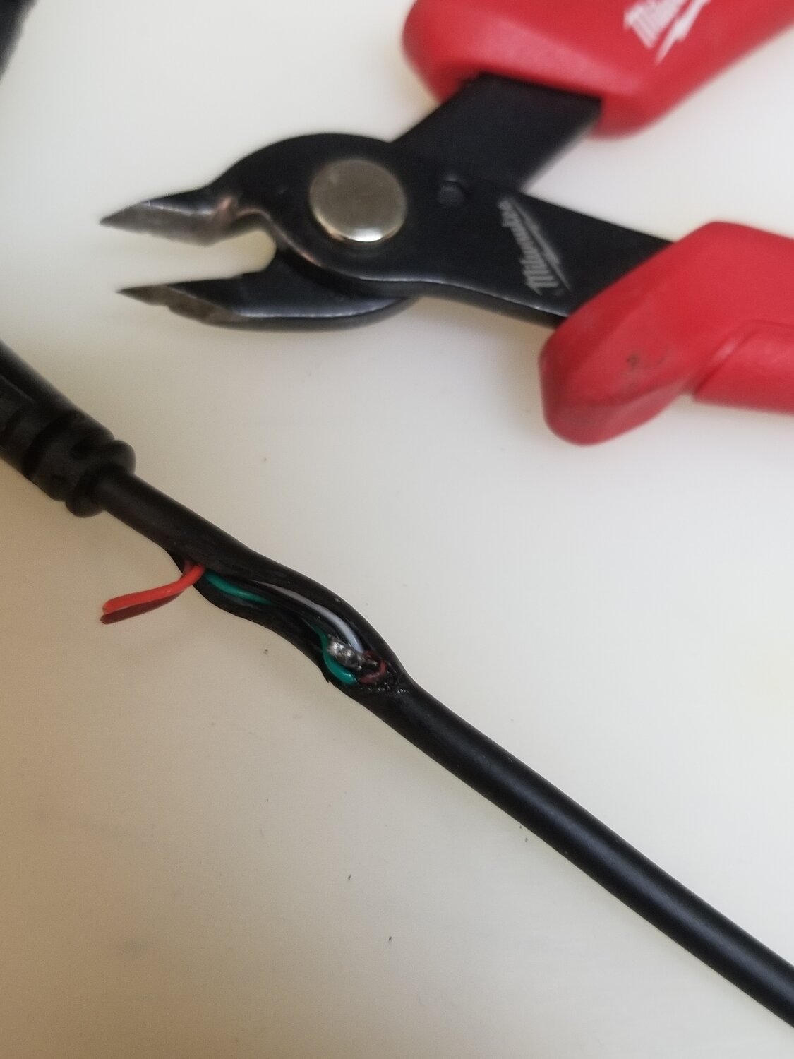

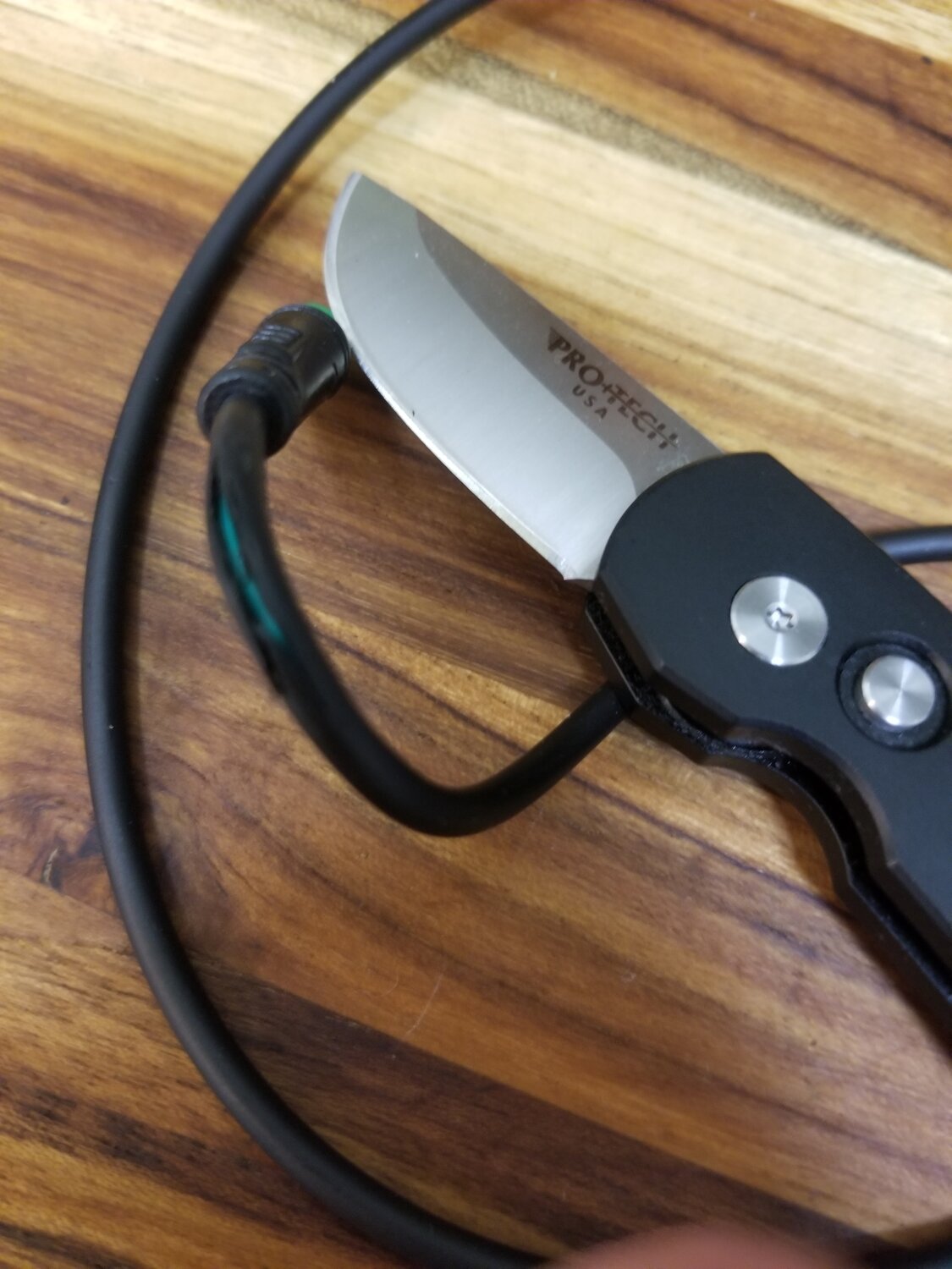

At 38", the FEANTEEK's cord is pretty long.
Even that, noting the distance between the display to my LT, I anticipated needing an extension - where Yellow and Red are shorted and no need to fiddle with the dongle. Universal, it won't interfere with previously shorted types either.
Hope they're not needed, but I made sure I have a couple FEANTEEK's (one I modded - per instructions) and I thought I'd try this idea going forward.
I put a slit in the cord's insulation; Snipped the (in this case) Red and Brown leads, soldering the two outgoing (from the dongle) leads together. I have Red, Green and Black - so if other two vary in color I'm good.
The incoming wires (to the dongle) are snipped staggered; the area tightly wrapped with electrical tape then covered w/ 3x shrink fit.
Now the interchangeable extension's also a jumper cable, w/ no need to mod the dongle, 'short' possibilities eliminated.
I have 100cm (39in), w/ 5-pin M/F Julet plugs from these guys. Cost for 3 x cords was $15.00USD total.

A member posted a screen shot of the Voltage Settings - set incorrectly for my purpose.
The 'Unicorn' icon. It was in a throttle thread - a bored Member had posted something like: "Should I use a throttle or not" as the title - to watch the chaos.
By "Master software", you mean the firmware ?
I think Frey has those settings available for the Ultra. They are fairly common.
View attachment 152912 View attachment 152913 View attachment 152914
'Scuse my flux on that rubber and solder joint. Ugly, but harmless and hidden. lol. Under magnification the insulation isn't burned. The wire's thicker copper than most types.
I'm waiting until 'June/ July' - failing, I hack by whatever means - but good to have my aux hardware kit in order.
This squabble is ruining so much. "I won I won" from a mound of ashes rings so damn hollow, but it's a great way to win - I guess.
Just a simple idea to share.
Fn'F
For the X1 the master accounts have more settings available
This video from Watt wagons shows what extra tabs/settings they have available.

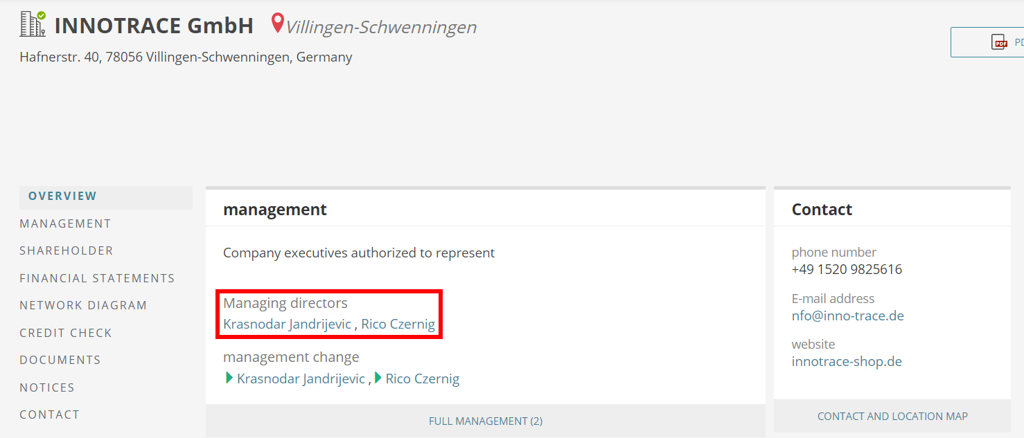

This all doesn't make sense. I don't quite get it. Why would some FW be "hacked" or "from unknown source" and the other not? How big was Innotrace even? Somebody told me recently that it was only Rico and Krasnodar, which can be looked up online:
I know that Rico was mainly for sales and managing orders. He also did aftersales-support a few times for me and answered questions.. He seemed always busy and behind shipping orders.. I highly doubt he was capable to develop his own "hacked" firmware without telling the co-CEO Krasnodar about it, who's responsible for the technical part in first place?! In fact, in a GmbH-company this would be illegal. From whom was this FW, if not from Krasnodar the "developer of Innotrace"?
The FWs about which Krasnodar states they are "illegal" or "from unknown source" do match with the versioning of past versions! Maybe the fuzzy serial- and controller-numbers from TPEHAK in #225 are from the not responding backend server, but why was their server pingable the whole time? I traced the HTTPS-calls and regularly pinged the server www.xembedded.de, since it has been seemingly hacked in January.
And why is Krasnodar avoiding answering the question, when he will enable the servers again? Or providing evidence against the elephant in the room: Whether he uses VESC or not?
