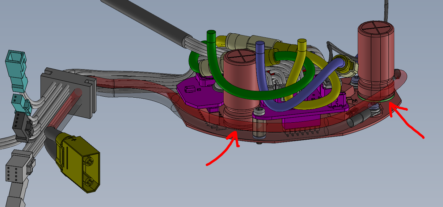

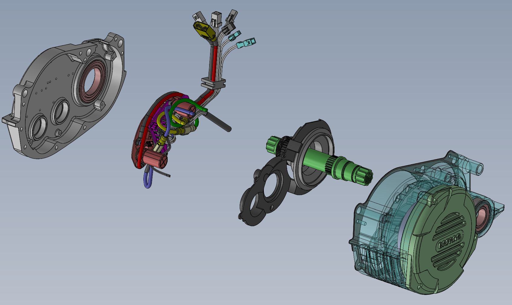

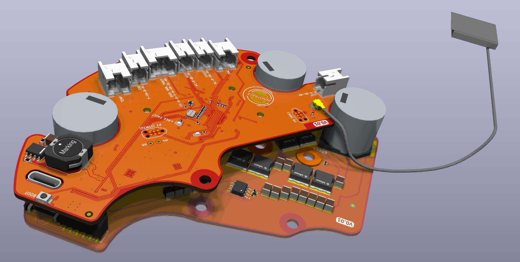

The motor with controller CAD model can be downloaded or checked on the GrabCAD
You can use it for reference to see the cables connections and proper cables routing.

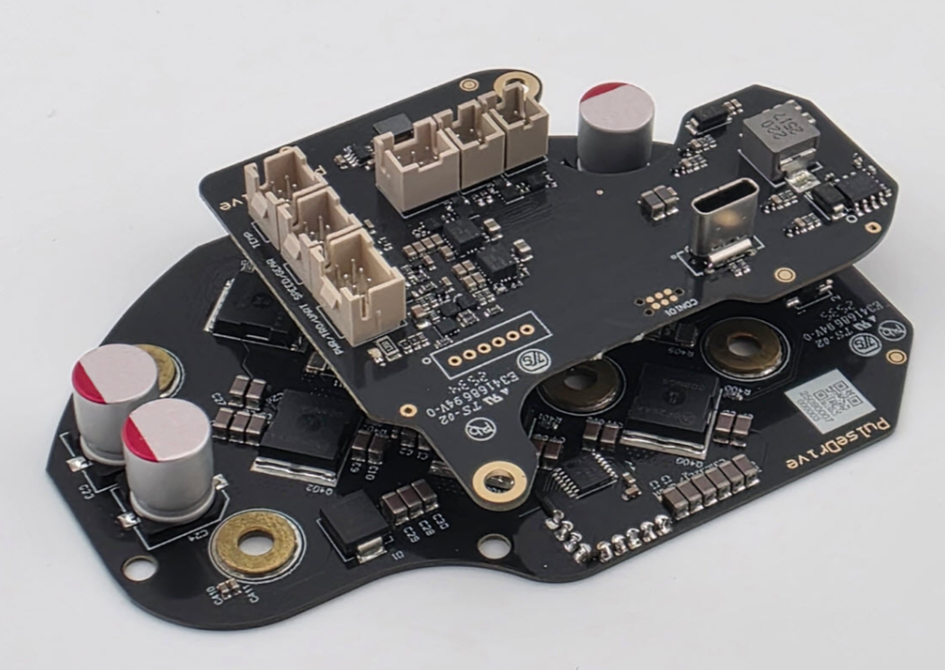

The motor controller area is precisely reverse engineered and can be used as a reliable reference.

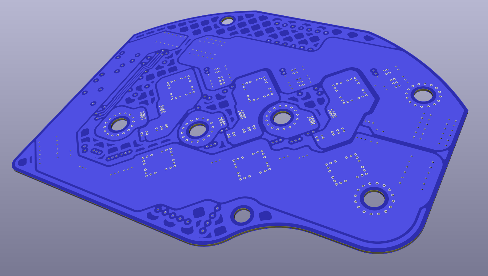

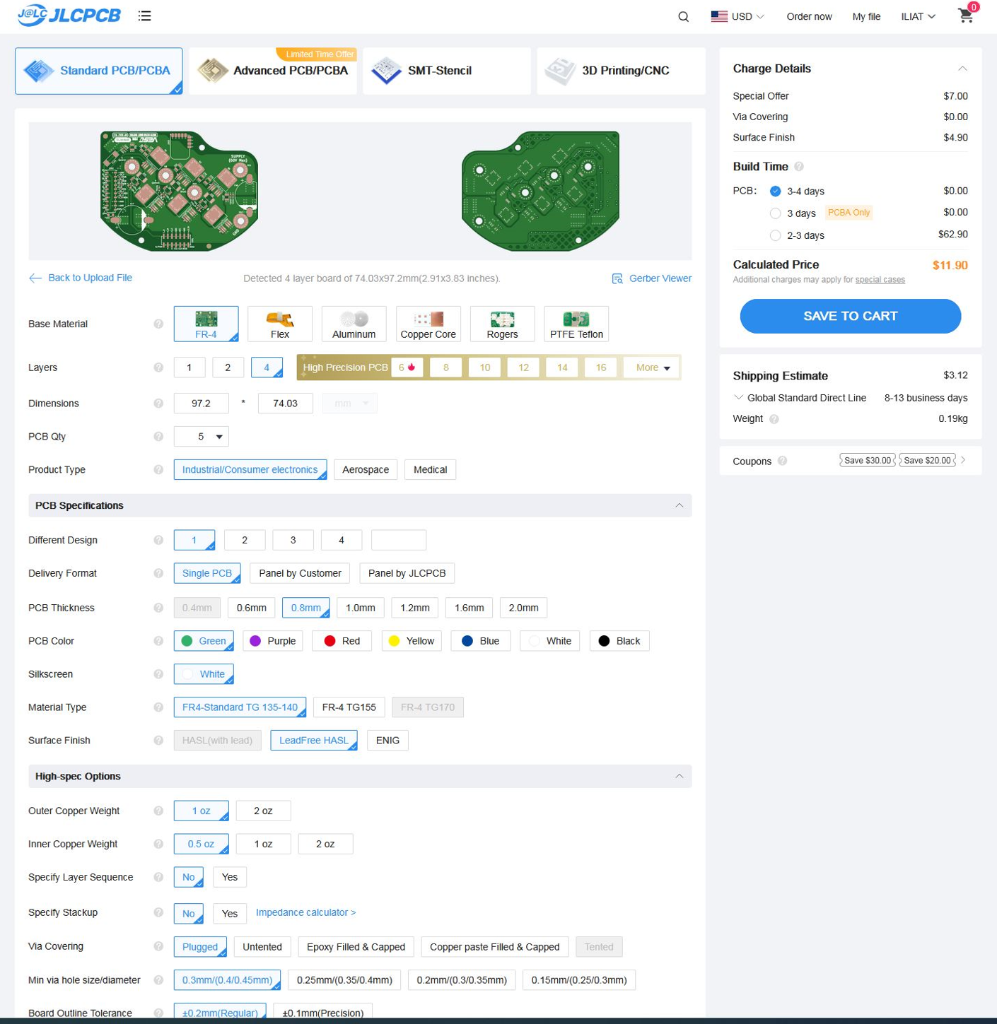

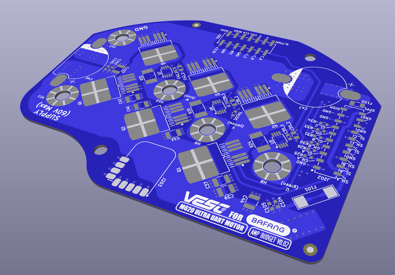

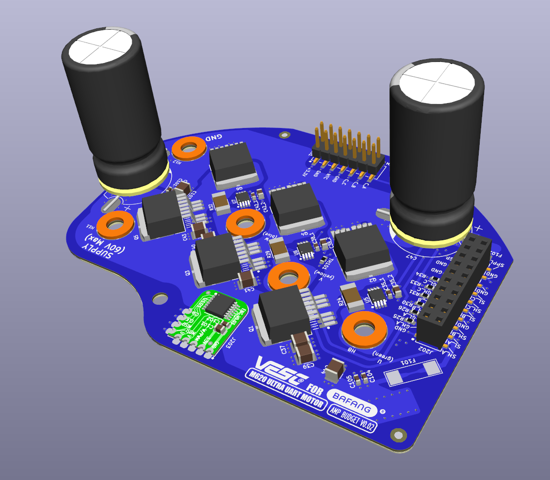

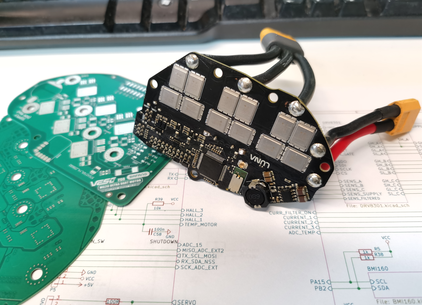

I designed a cheap version of the AMPLIFIER board for regular copper weight (1oz) and regular through hole vias (the original design of the AMPLIFIER board with heavy copper and blind vias is quite expensive) and this cheap version it is about $2 per PCB if you order 5 of those on JLCPCB website. I have not built it yet but I uploaded the files in the updated archive with the PCBs
Two other PCB boards of the controller are even cheaper and are good as is.
This board should to be 0.8 mm thick and you have to cut and glue 0.4mm thick isolation layer on the bottom of the board after soldering the components. The isolation layer can be cut out of 0.4mm thick fiberglass board and glued on the bottom of the AMPLIFIER board with high temperature epoxy glue or potting compound.

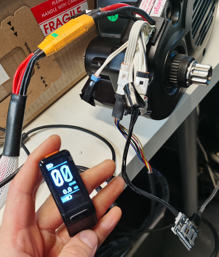

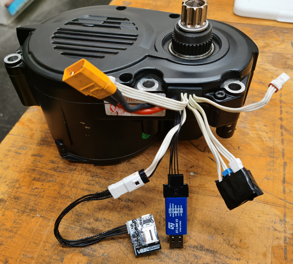

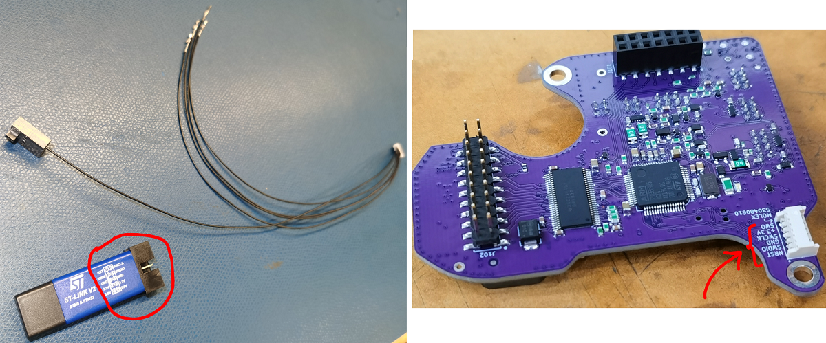

I played around a little bit and was finally able to connect via VESC Tool to my Innotrace X1!
First I made connection using a simple USB to CAN adapter (e.g. canable) and tried to send common VESC CAN commands (VESC CAN-Bus Communication). I got no response and assumed it has been either completely disabled or hidden.. Its known for manufacturers that they wanna hide the fact, that they are stealing code: Here is another example, where a Torp TC500 controller has been torn apart. I gave it a try and brute-forced, by sending every combination possible... It took a few months, but one day, when I checked for my logs, the controller started talking back, because of one specific message I sent: 00D431FF # 14 78 00 00 00 00 00 00. It appears to be a "magic message", that enables usage with VESC Tool, once sent:

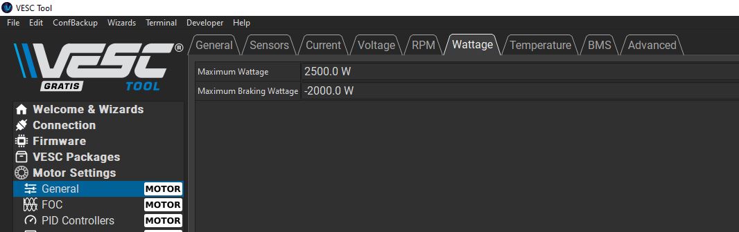

For connecting I used CAN-Forward on a VESC-Express. You can do the same thing with any VESC controller. I used a VESC-Express which is simpler, because it's powered by USB-C. It pops up as secondary CAN-device out of nowhere and it's possible to read and write motor parameters like maximum wattage, motor current, ...

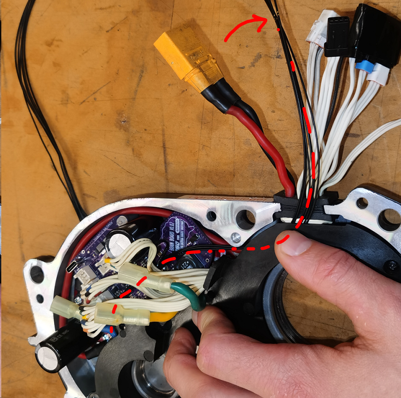

CAN-connection is already available from the outside! Here is the pinout for the black connector (04R-JWPF-VSLE-S) of the M620-motor:
Code:
  │   │   │  ┖> x not used
  │   │   ┖───> H CAN-H ───┐    green
  │   ┖───────> G GND    [120Ω] is already in place!
  ┖───────────> L CAN-L ───┚    yellow
Here is the exact instruction:

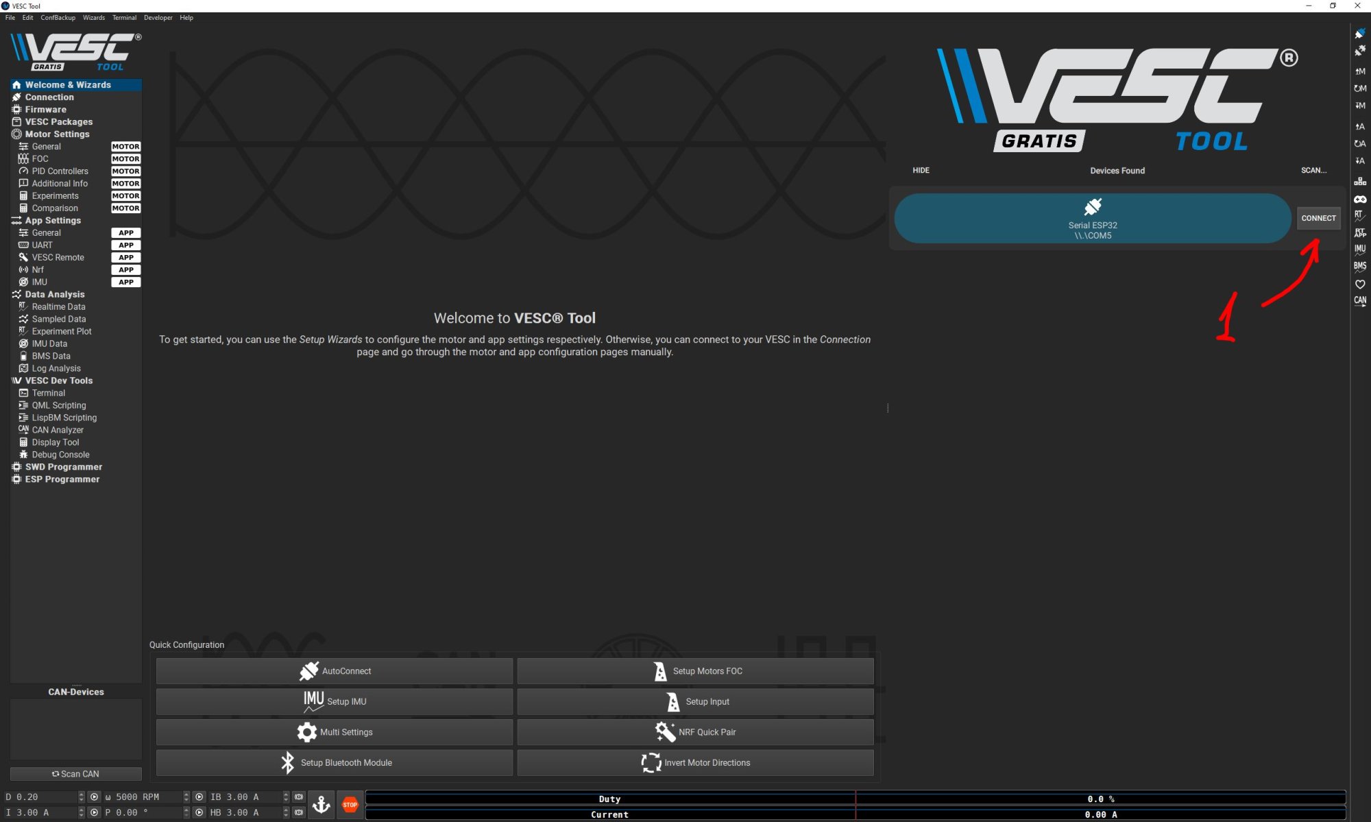

- Download and install VESC Tool program on your computer
- Obtain VESC Express dongle
- Connect the VESC Express dongle to the black connector (04R-JWPF-VSLE-S) of the M620-motor (Please note the VESC Express dongle requires 5V power source also to work so you might need to figure out this additionally)
- Connect USB cable to the computer and to the VESC Express dongle as Dedo posted earlier
You can make a cable also for convenience
The display with wiring harness should be connected to the motor too (to be able to turn the controller ON)
- Connect the battery
- Turn the display ON (to power the controller)
-Launch the VESC Tool program on your computer and make sure the VESC Express is supplied with 5V power.

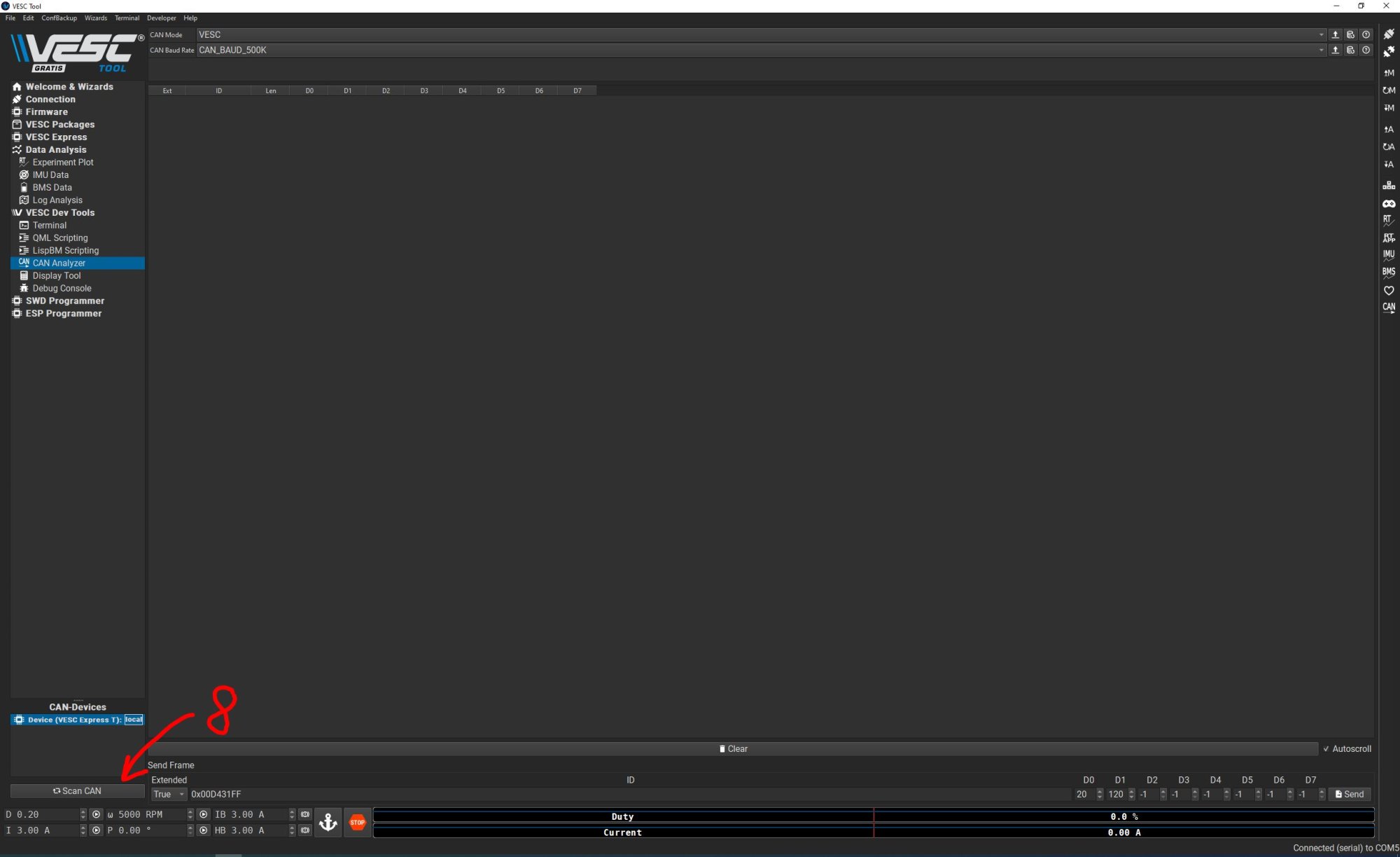

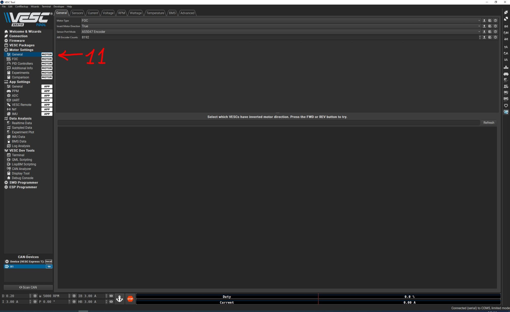

-Follow these steps:
1) Press "CONNECT" button in the VESC Tool program. Make sure the VESC Express dongle baud rate set to CAN_BAUD_500K (can be checked and adjusted in the "VESC Express" menu in the VESC Tool application).
2) Select "CAN Analyzer" in the menu. Make sure the "CAN Mode" field is set to VESC and the "CAN Baud Rate" field is set to CAN_BAUD_500K
3) Select option "True" in the "Extended" field
4) Print 0x00D431FF in the "ID" field
5) Print 20 in the "D0" field
6) Print 120 in the "D1" field
7) Click "Send"
8) Click "Scan CAN"
9) Select "X1" in the menu
10) Click "OK" on the appeared message

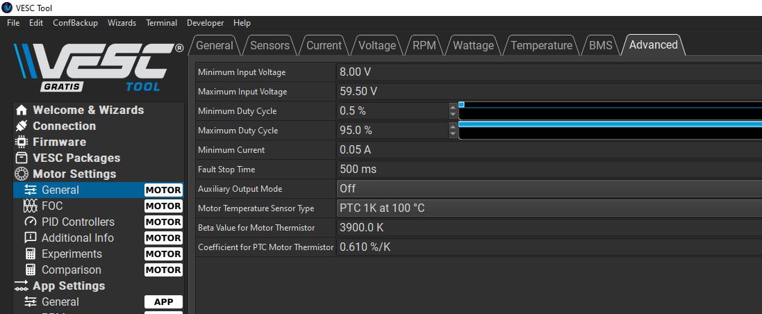

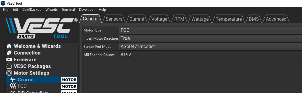

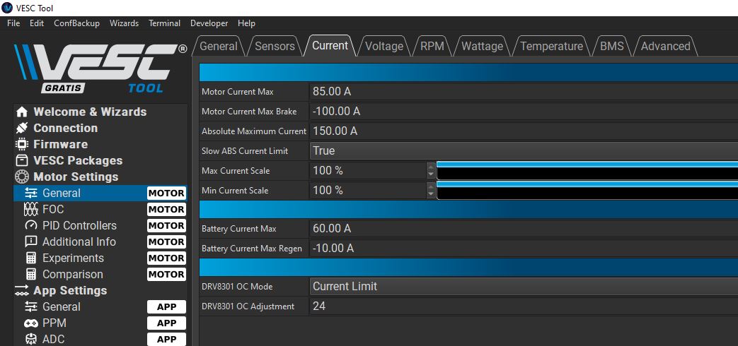

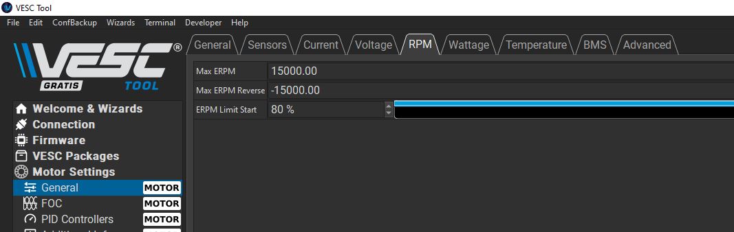

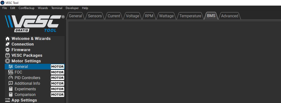

11) Select "General" in the menu under the "Motor Settings"
Now you can change the motor settings.
Please note the Bafang display has time set after which it will turn the controller off if it is inactive. You can press + or - buttons on the display time to time to prevent turning the controller off while you work with it in the VESC Tool program.

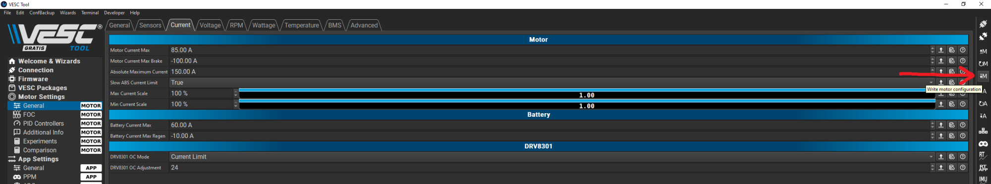

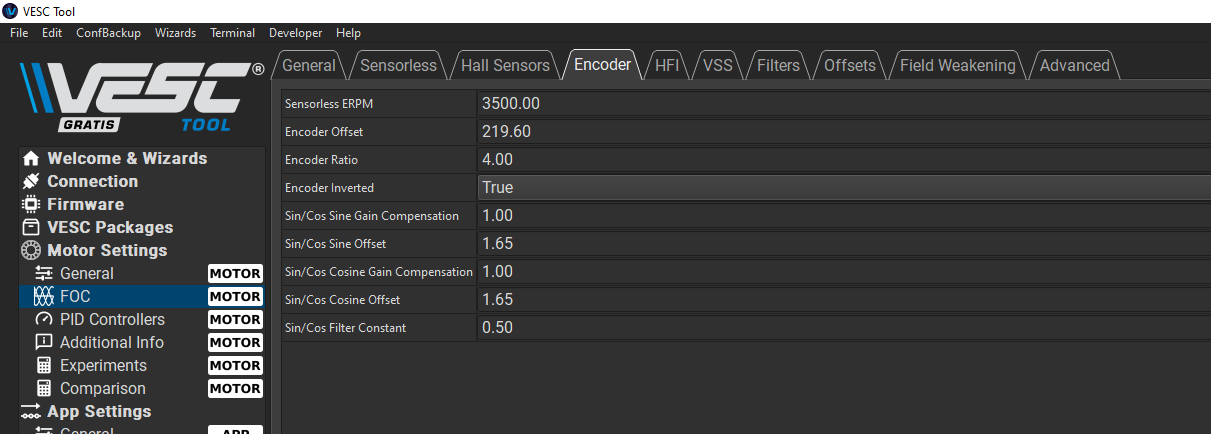

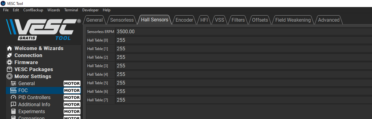

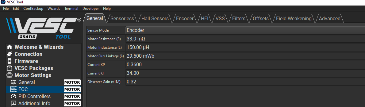

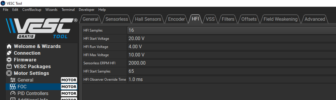

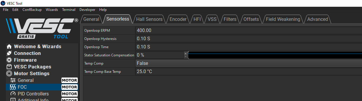

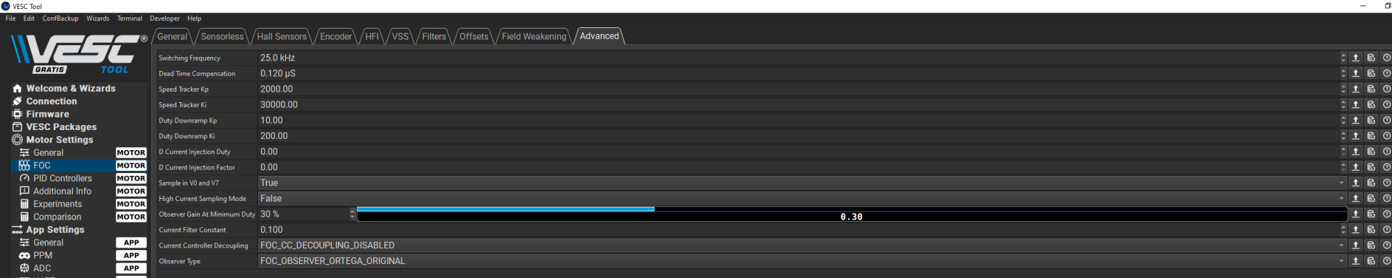

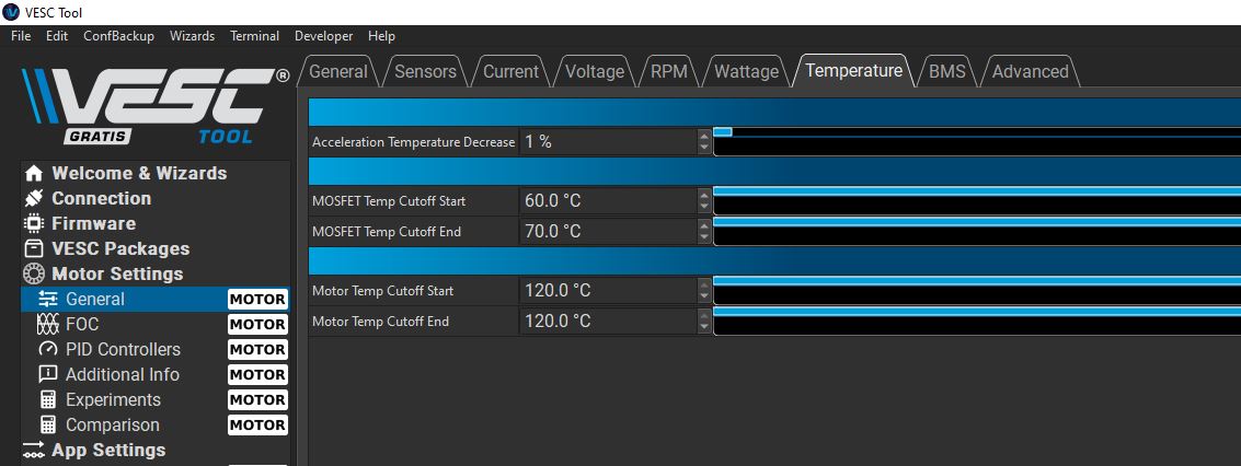

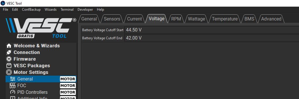

Here are the settings for 14S 52V 60A battery you can start with
After changing the settings click the write motor configuration button.
Do not change the settings if you do not know what you are doing because of you can damage your motor or your controller.

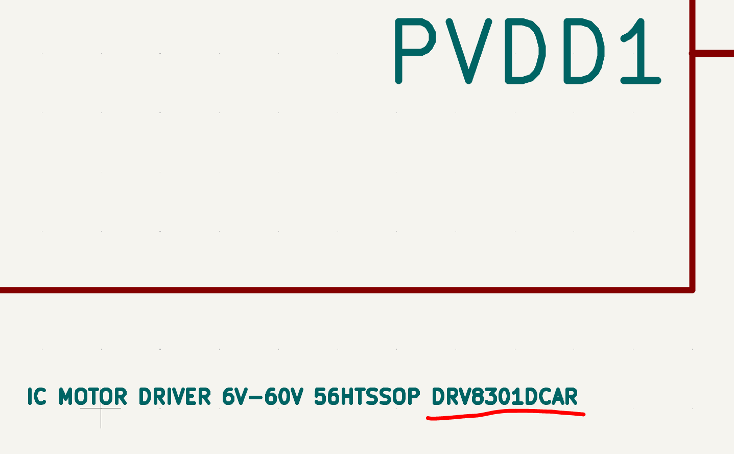

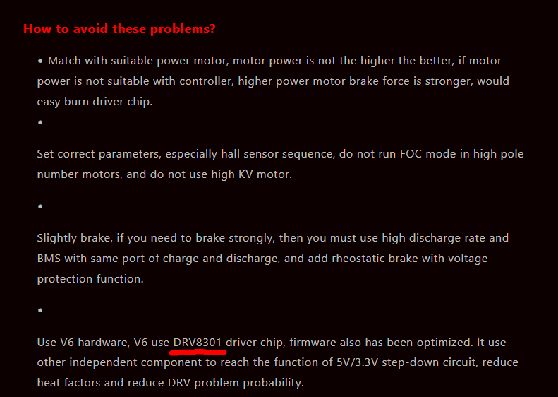

That's an interesting article. The VESC for Babang controller uses DRV8301 chip as recommended in the article to avoid such issue. Plus it has improved not standard footprint for soldering, this footprint maintains better contact with the cooling pad of the chip and evacuates heat energy better. So as long as we can optimize the firmware that should be fine.

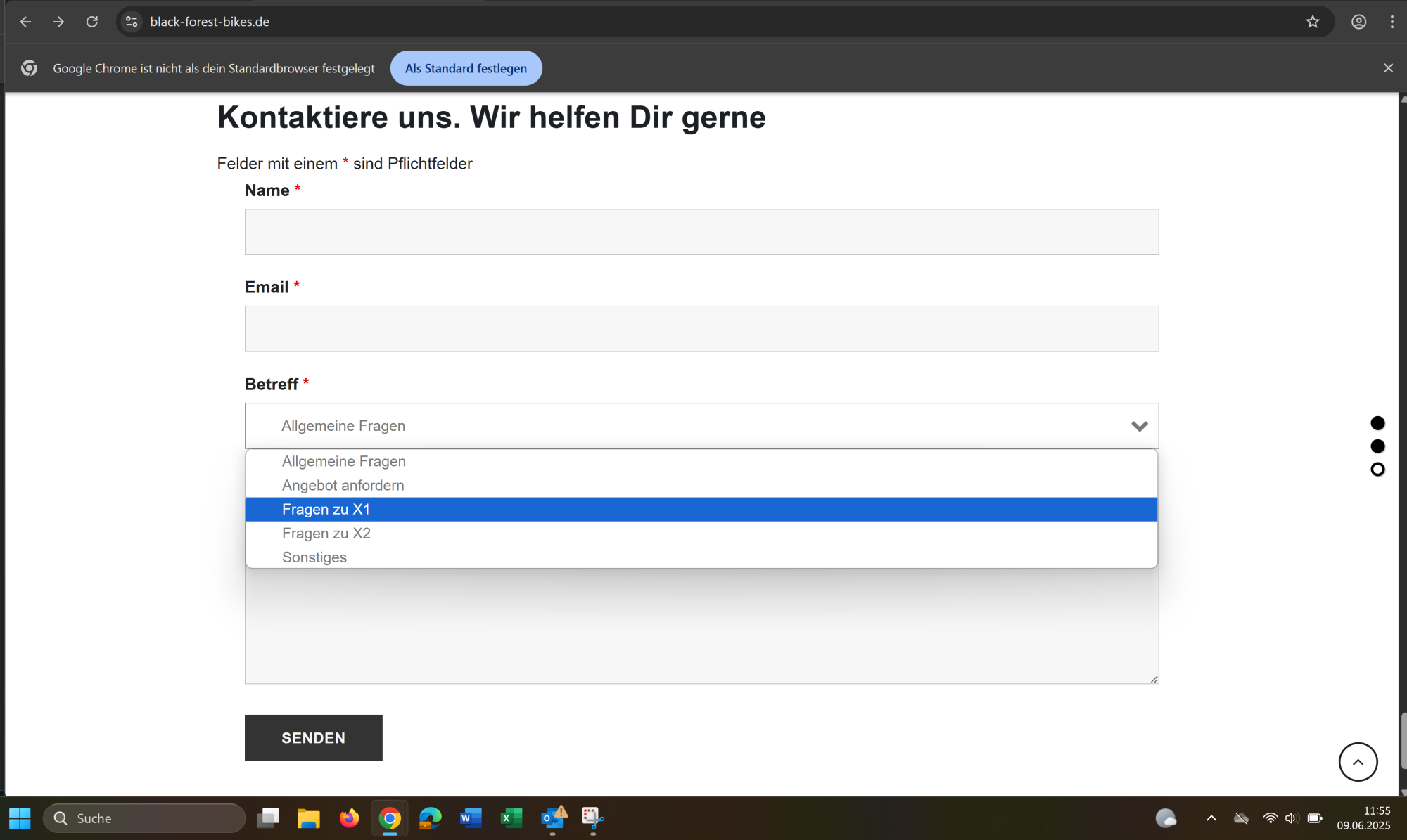

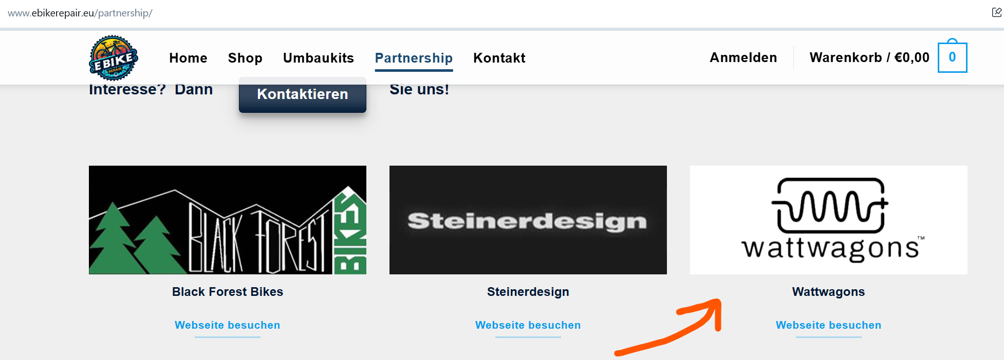

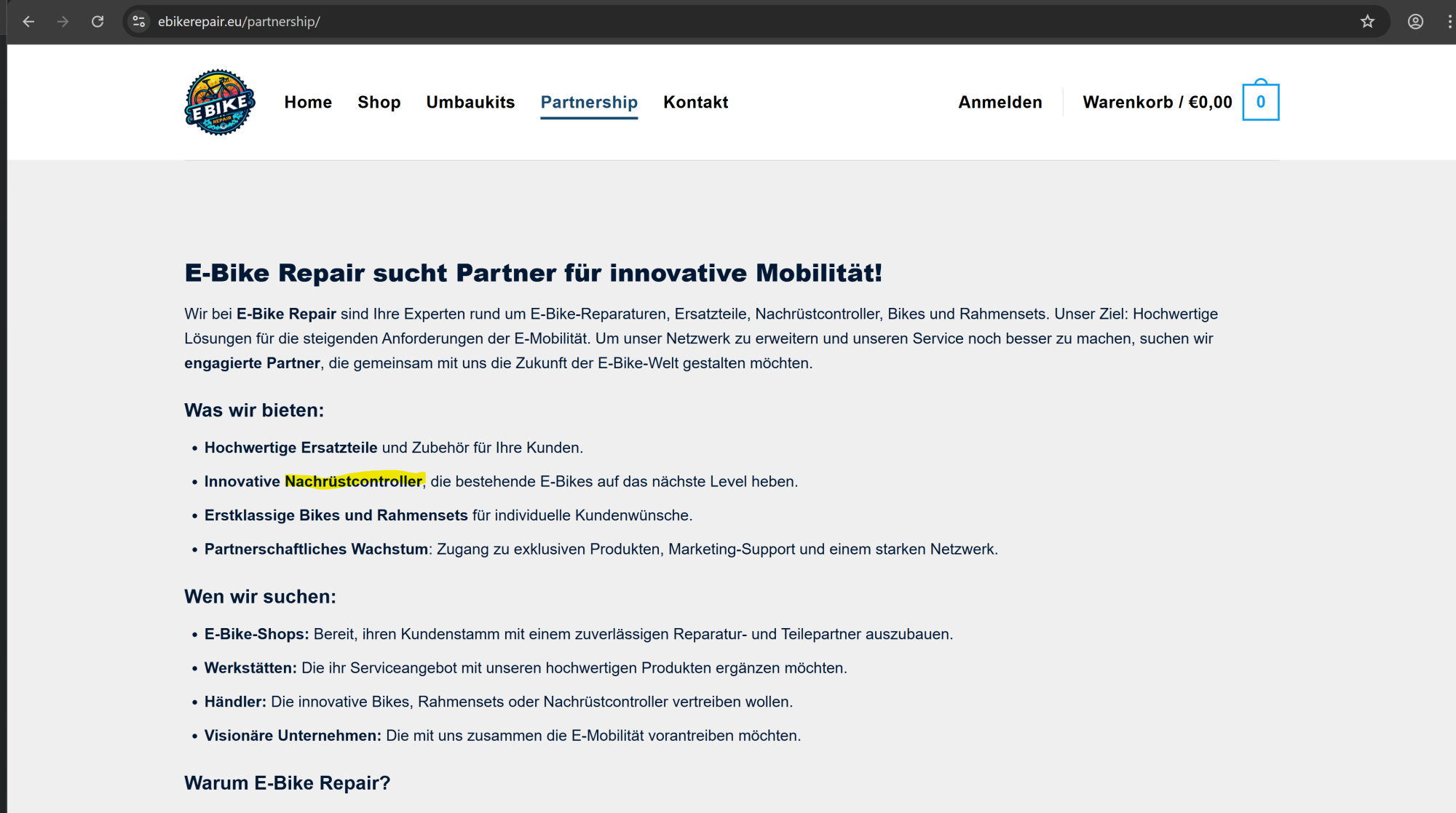

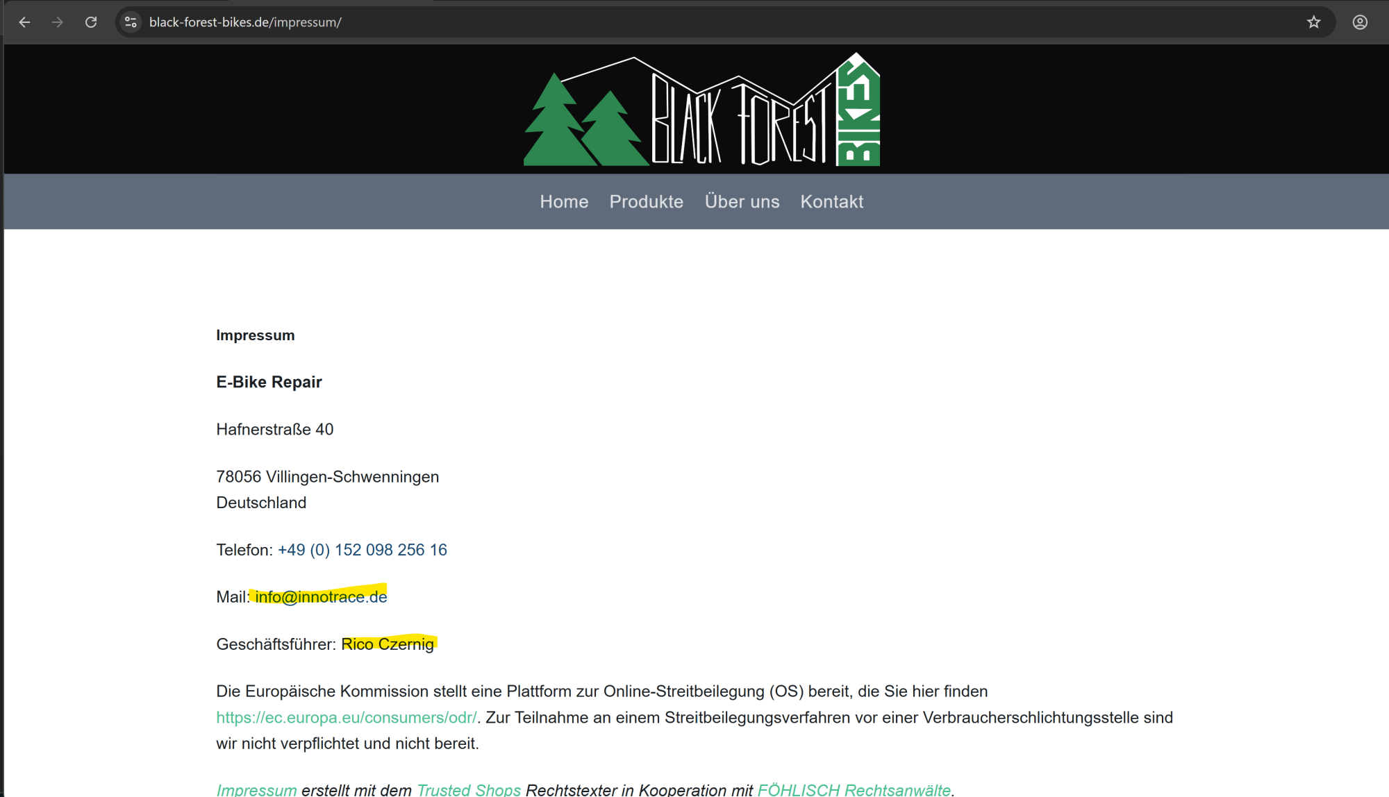

So Rico is the owner of ebikerepair.eu ? I see some Innorace artifacts on that website and WattWagons links
As far as I know Rico works for SSP

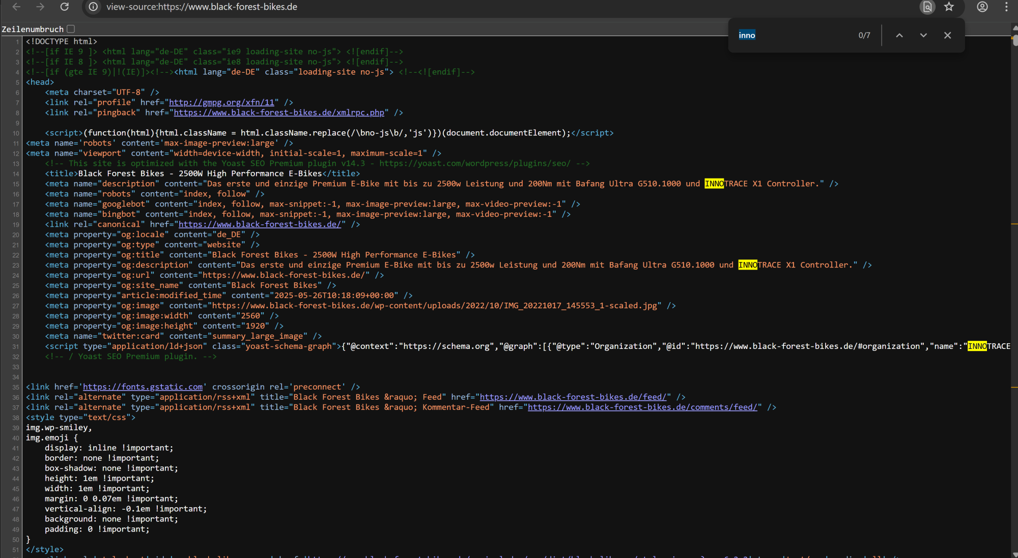

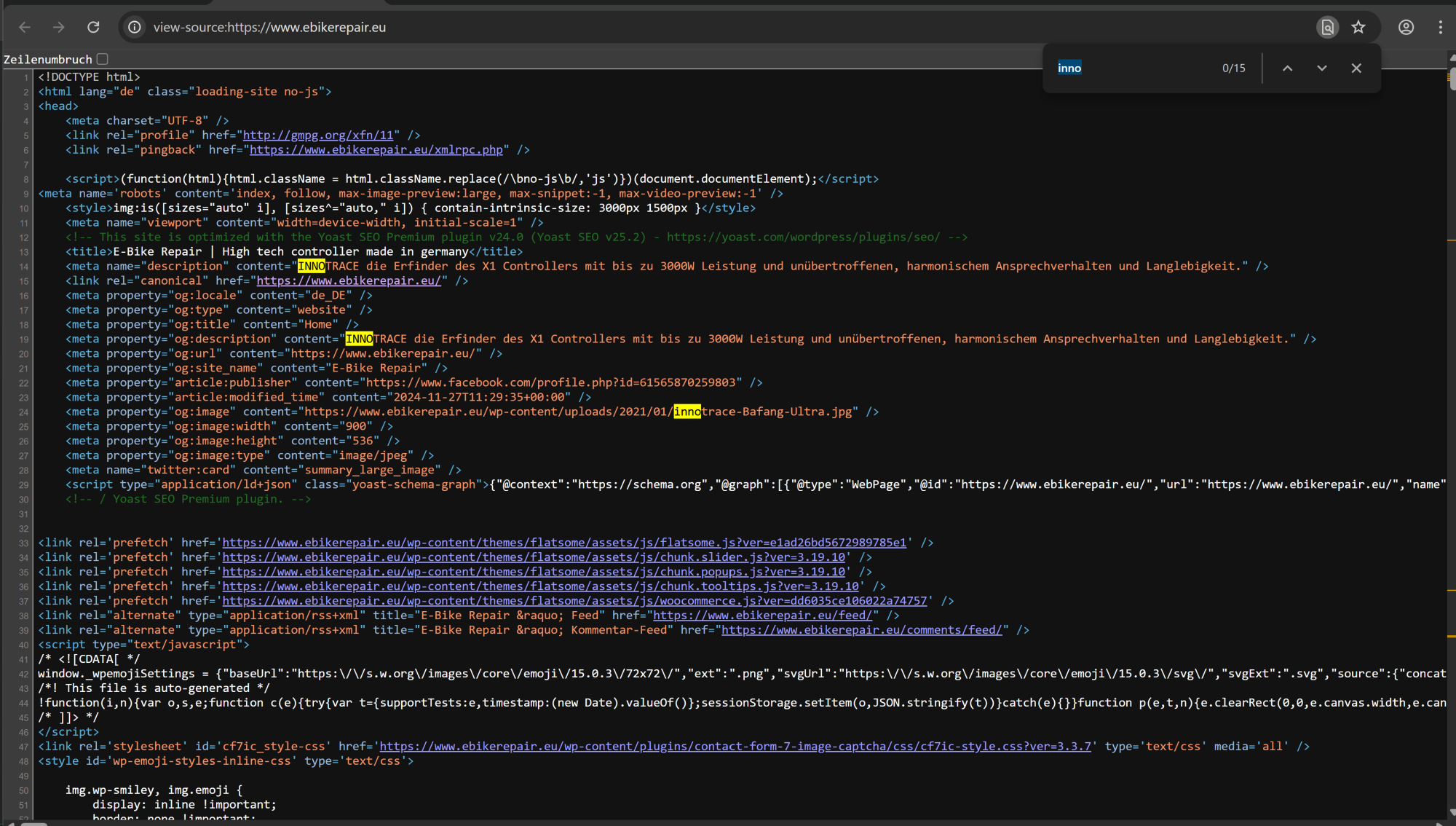

In any case, both homepages are those of Innotrace. Look at the source code of the pages

I have finished reverse engineering of the PCB and posted the files on the forum so anyone can try it. The next step is to assemble the original controller back and see if it works (I did not use it so I do not know if it works. If it works we can assemble the reversed one and see if it works too).
