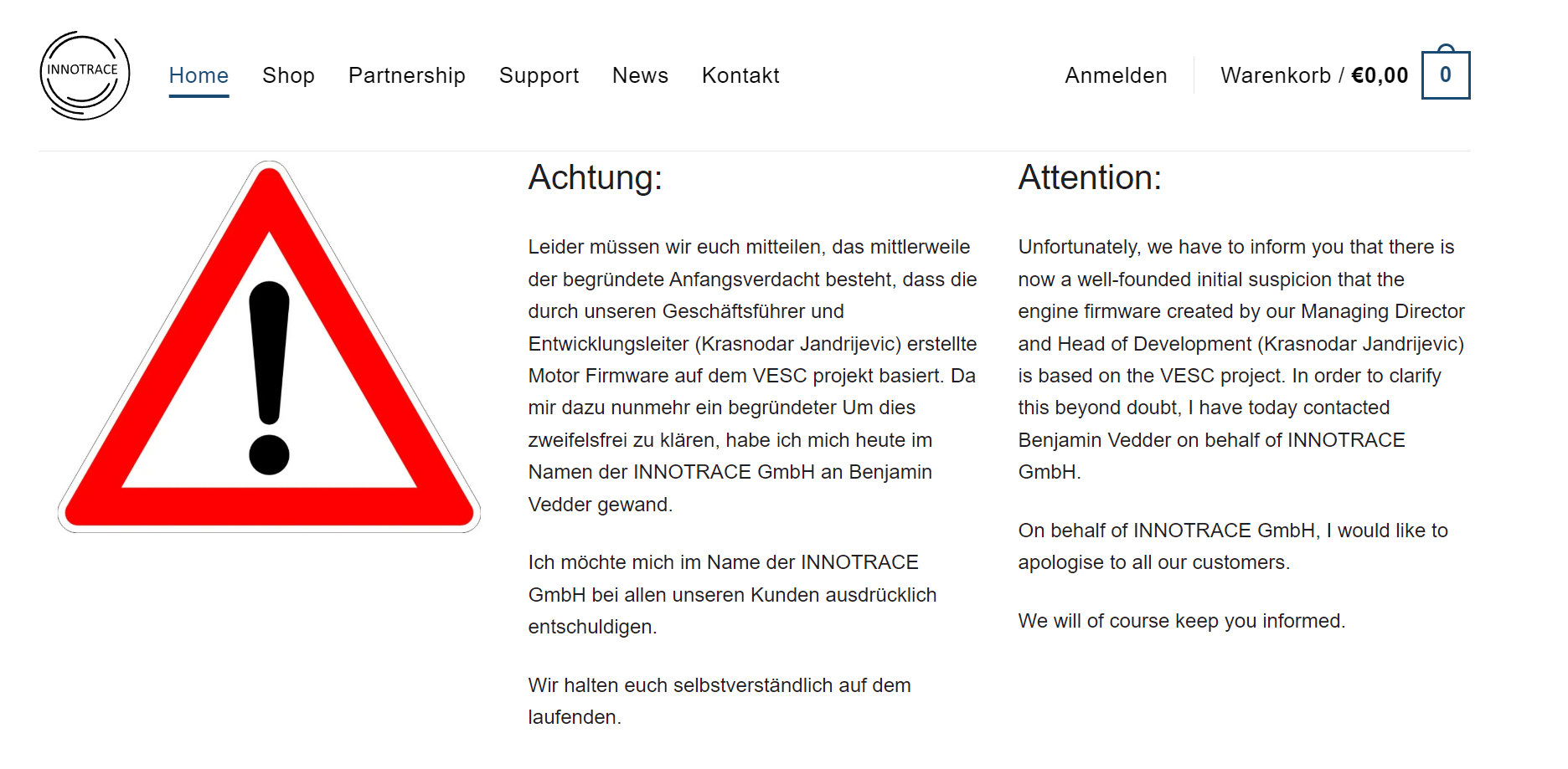

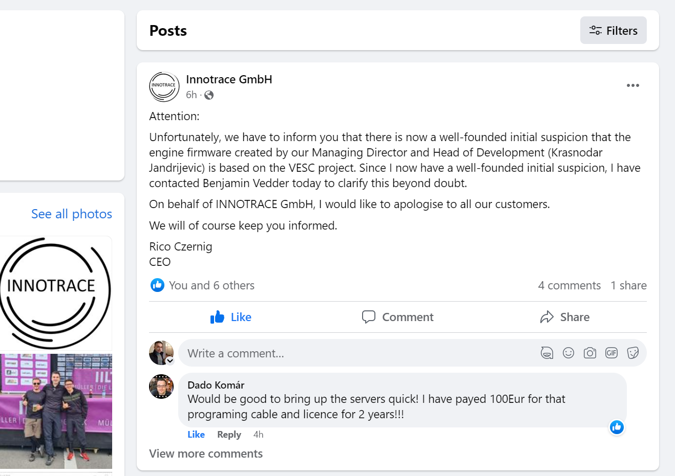

Alright, more action is coming. Innotrace informed, that the Innotrace (Archon) controller firmware is probably based on the open-source VESC project motor firmware Krasnodar probably used. I am not sure how it will affect us the users of the Innorace X1 motor, but I hope this is the way they want to work around the X1 Tool software or maybe it will help to bring the X1 Tool registration server back in working order. Maybe Krasnodar will have to help them to bring it back to avoid legal consequences or something?
Maybe someone smart here can use that information to unlock the Innotrace X1 controller?

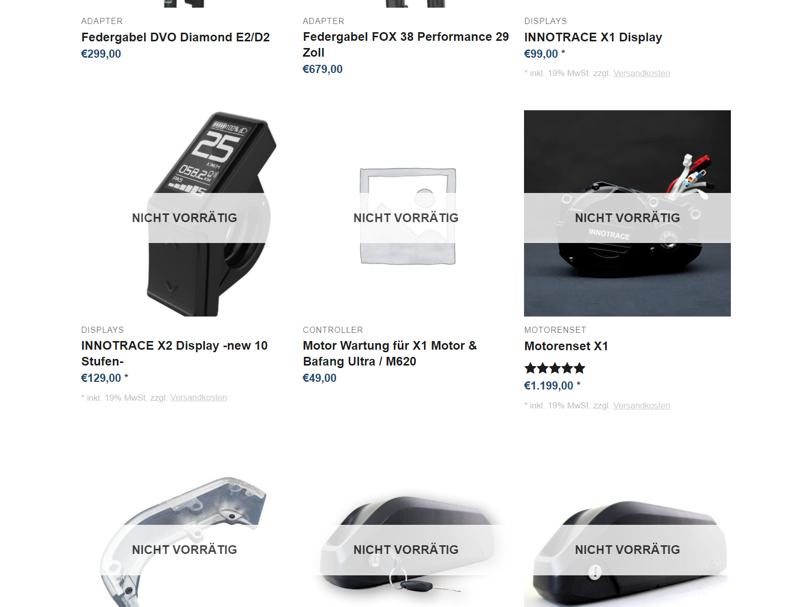

They also closed all sales on their website. Is this something we have to start worry about?

Well, this may have taken a turn for the worse… VESC Tool is GNU GPL3 licensed open source, which could certainly put Krasnodar and/or Innotrace in some legal hot water, as creating a derivative non-open-source work is completely disallowed under the GPL, while they are required to make source available if using any GPL code.
At this point, I’m wondering who did the hardware design, or if it too is a VESC-based controller or based on a VESC reference design..?
If X1Tool is indeed VESC-based, it’s possible someone in the VESC community, or perhaps the VESC author/lead (Vedder) could be persuaded, although I’d expect him to charge Innotrace if so. There could wind up a surprise silver lining if VESCTool were ported to the Innotrace controller - desktop and mobile apps, etc.
