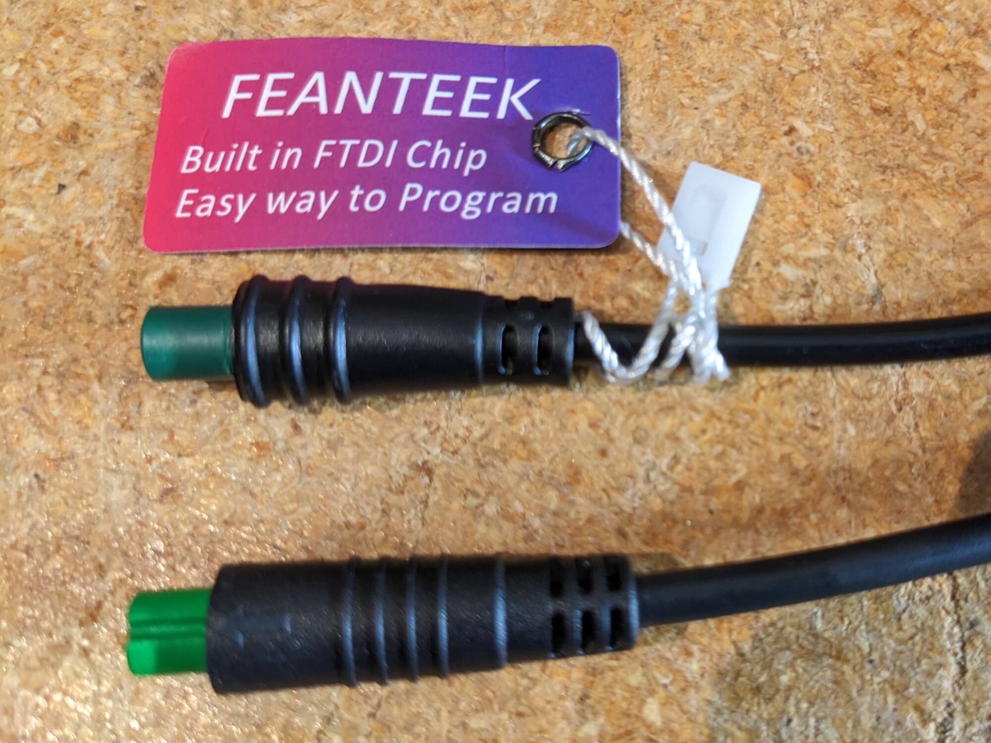

I have successfully made an X1 programming cable.
First you must start with a genuine FTDI FT232R USB to serial adapter. The counterfeit chips cannot be reprogrammed. I purchased this cable. You can also build your own with instructions found elsewhere on the Internet. SparkFun and Adafruit sell genuine FTDI adapter boards.

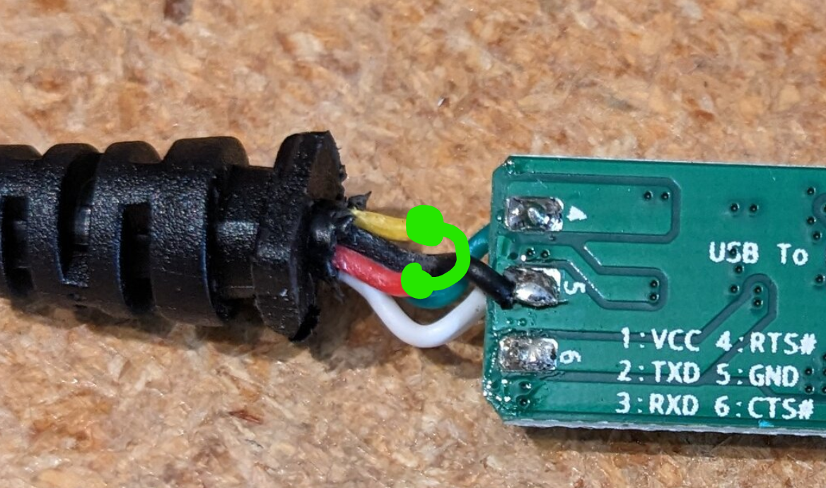

That Feanteek cable gets a 1 star review because it does not power on the motor. This is remedied by prying open the case and soldering the red and yellow wires together. Insulate the solder joint so it does not touch the circuit board. There is main battery voltage on that connection!
To reprogram the FTDI chip, download and install FT_PROG. Also, install the FTDI drivers if you haven't already.

You can cut the waterproof boot off the connector to make it easier to insert and remove. Innotrace does this with their programming cable.
If you need a programming cable and this is beyond your skills, send me a message. I will do a group buy of cables, modify, test, and ship them out. I will charge $50 USD + shipping which is less than what Innotrace charges.
Wow, thank you! So the guy from other forum who told me that I can use Bafang programming cable for Innotrace X1 was right. I did not pay attention what he told me because of saw an information that X1 cable is unique but he probably meant this procedure.

Just want to confirm. You soldered the yellow wire and the red wire together like this?
Yes, I just stripped those wires, twisted them together and soldered. These are the P+ (Power positive) and PL (Power Lock) pins which must be connected to enable the controller.
