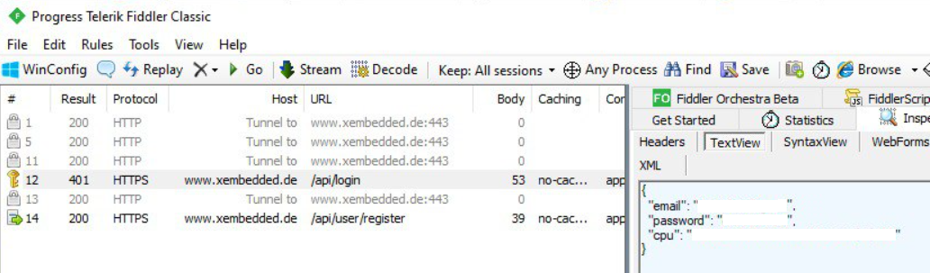

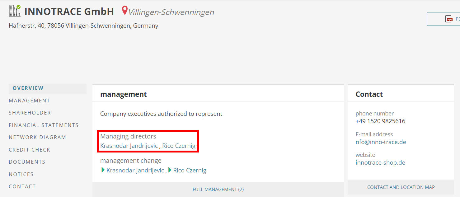

This all doesn't make sense. I don't quite get it. Why would some FW be "hacked" or "from unknown source" and the other not? How big was Innotrace even? Somebody told me recently that it was only Rico and Krasnodar, which can be looked up online:
I know that Rico was mainly for sales and managing orders. He also did aftersales-support a few times for me and answered questions.. He seemed always busy and behind shipping orders.. I highly doubt he was capable to develop his own "hacked" firmware without telling the co-CEO Krasnodar about it, who's responsible for the technical part in first place?! In fact, in a GmbH-company this would be illegal. From whom was this FW, if not from Krasnodar the "developer of Innotrace"?
The FWs about which Krasnodar states they are "illegal" or "from unknown source" do match with the versioning of past versions! Maybe the fuzzy serial- and controller-numbers from TPEHAK in #225 are from the not responding backend server, but why was their server pingable the whole time? I traced the HTTPS-calls and regularly pinged the server www.xembedded.de, since it has been seemingly hacked in January.
And why is Krasnodar avoiding answering the question, when he will enable the servers again? Or providing evidence against the elephant in the room: Whether he uses VESC or not?

I also think it's over with Innotrace. From my experience Rico is still reachable, but it's not possible to buy parts anymore..
Eh. Very easy for the server to be up, but if someone truncated the database, deleted services required for app operation, etc. the server is up but the service/app is unusable.

Krasnodar is probably the only one who knows how accurate that program calculates the low voltage power reduction based on the battery capacity value and how it affects the battery behavior when the battery starts aging. Maybe there is a reason Innotrace does not ask anyone what the battery capacity they have when people order the motor and sets it to 14Ah for everybody and maybe it is better do not touch it.
