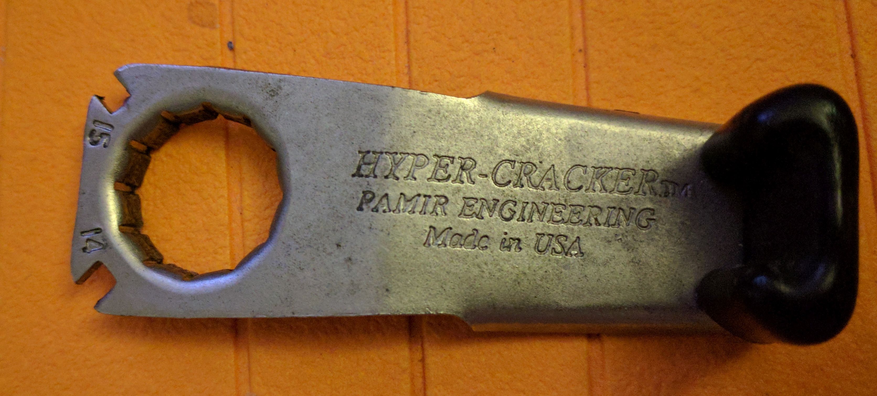

Cassette removal tool I just remembered I had in the bottom of my bike tools
http://www.woollypigs.com/2011/10/meet-the-hypercracker/
I've used it on my older bikes, wondering how it would work on the RadRover & RadMini...
From the article, it looks like there are a few other touring style freewheel lockring removal tools:
Found one on Amazon: Stein Mini Cassette Lockring driver 30+ bucks

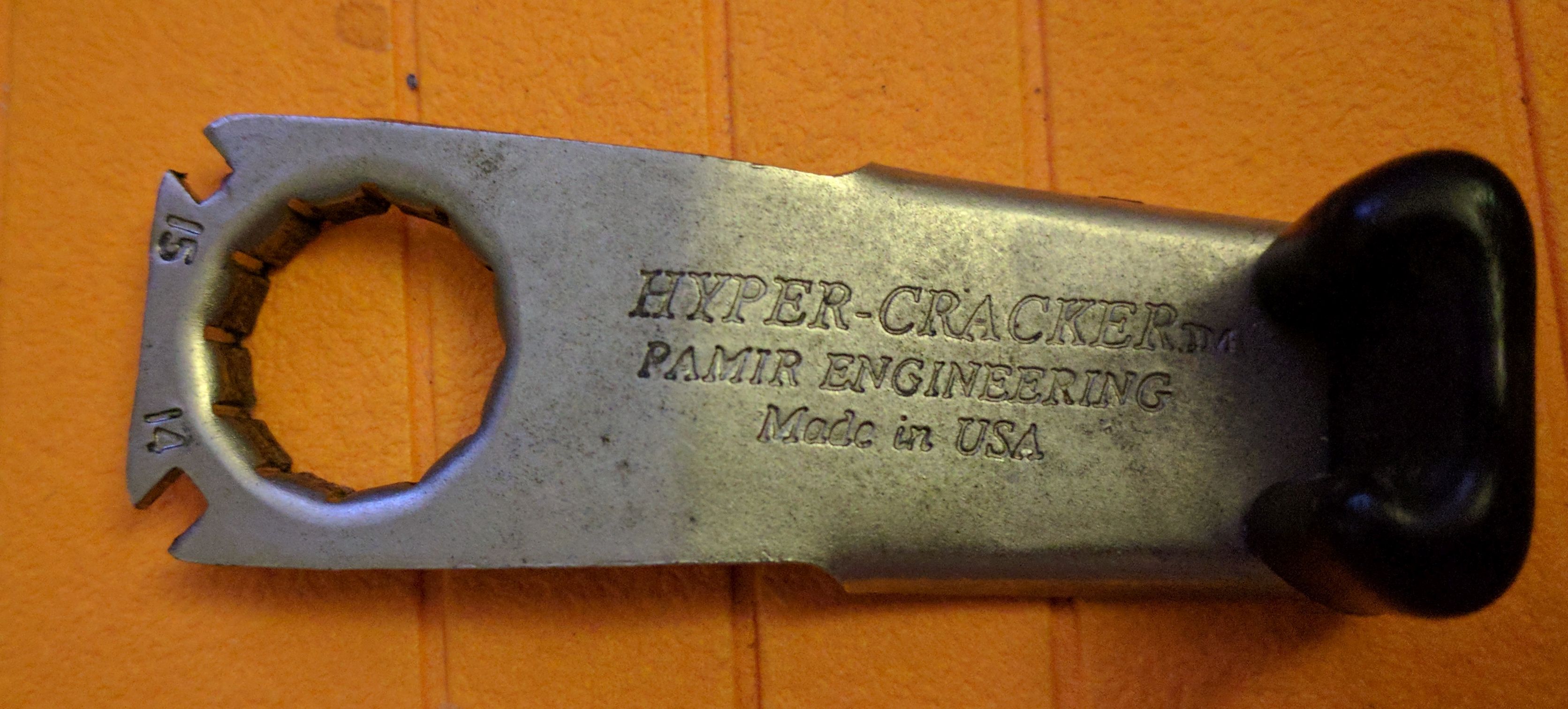

Damn, I totally forgot about those types of tools. Just the ticket for those with the wire in the axle. Well done!

Shimano cassettes and freewheels use the same tool. It would be a matter of finding one of the older style tools that go deep enough to engage the splines of a freewheel. This type of tool has been used for a long time by touring cyclists.
