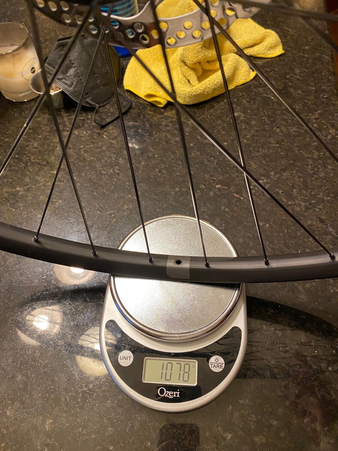

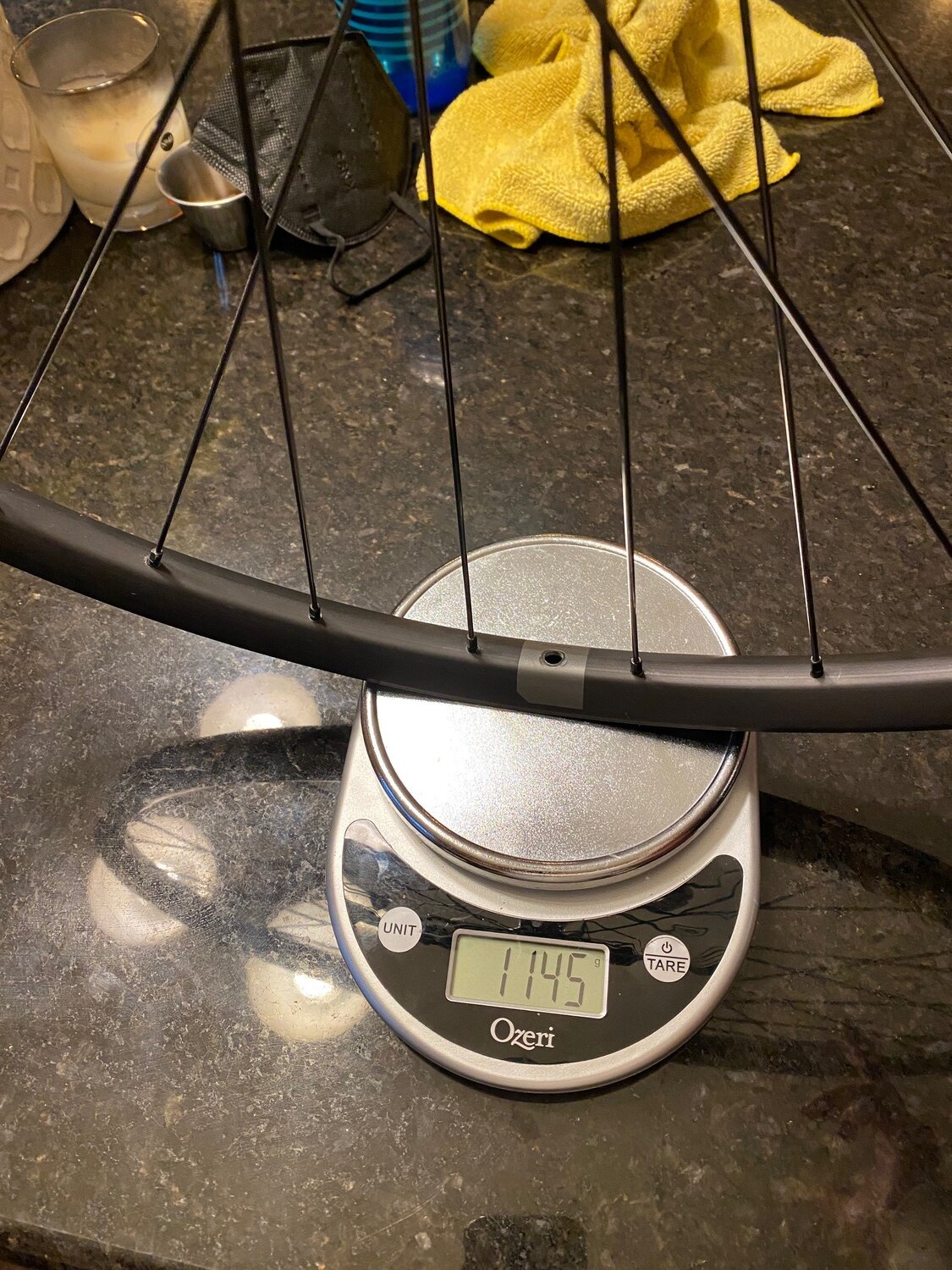

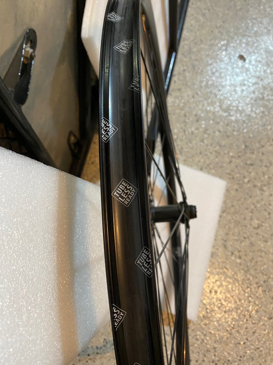

So what was the original weight before the changes? And is that a small or a medium?My wife's Tero 5.0 has been put on a diet; my goal as stated previously is 40 lb or less without the battery. So far I have swapped out the rims for Roval carbon (thank you LBS for the 20% discount!), and tires for Mezcal Vittoria XC Trails. On my hanging scale it is now about 40lb 8 oz. I have a RockShox SID on order, which will drop 1.5 to 2 lbs or so more from the total weight. Since adding the carbon wheels my wife loves her bike even more! Off-road hills that she had to walk up while riding her Vado SL 5.0 are now ridden; the power of this bike is incredible. I'm 6 years her junior, and it's a challenge for me now to keep up with her on the climbs on my Levo SL Expert.

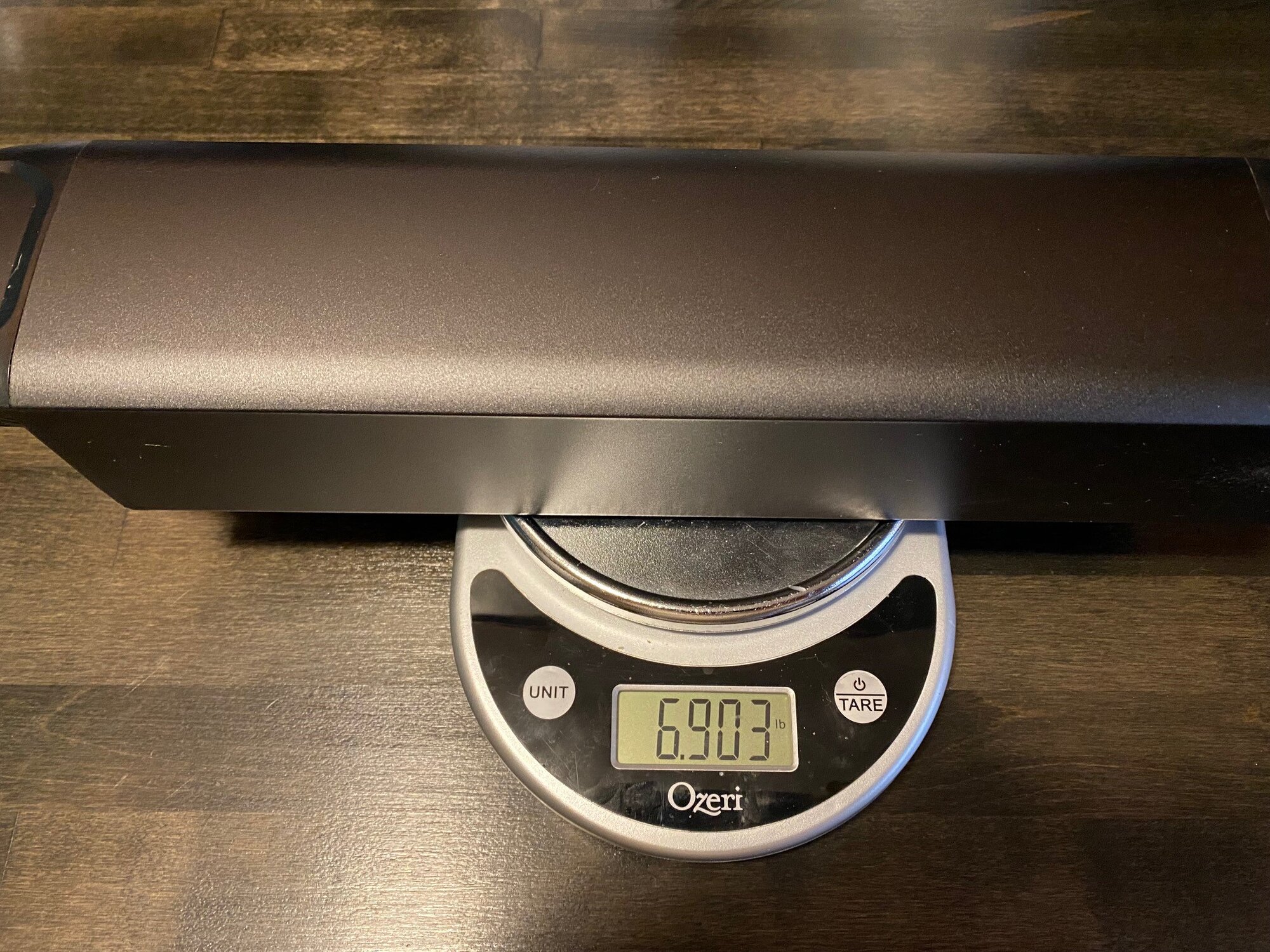

Y'know, I never gave any thought to the difference in weight between her 710 wh battery and your 530 wh battery.If you really want to save some weight I'll swap my wife's 3.0 battery for your wife's 5.0 battery and I'll pay for shipping for both batteries. I've never wife swapped before![]()
It's a medium, and without the battery the original weight was 43lb 1 oz on my digital hanging scale. I also upgrade her cassette to an XDome that saved another 6.8 oz.So what was the original weight before the changes? And is that a small or a medium?
Your calculation is about right. By the way Hammick, I apologize but I decided against getting the replacement fork. I learned that the adjustments are basically on or off; locked out or doing its thing, with no further adjustment. I may end up going with something from Fox in the future. If I do, I will let you know about her oem fork.I just weighed the 530wh battery from my wife's Tero 3.0 and it's 6.903 lbs. So by my calculations the 710wh battery should weight 8.6 lbs.
