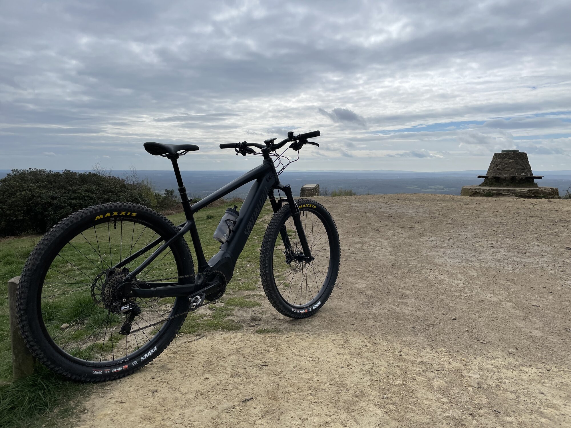

My Tero 4 out in the Surrey Hills today.
I also managed to get 3 strava cups 😎.
