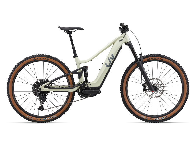

If anyone else is curious, the main competition before I sprang for this bike was the Giant Revolt e+. Most of what I do is gravel, so that aspect of it would have been fine. I do prefer drop bars over flats, and it does have a range extender to boost it's 500kwh battery. But there were three main factors for why I didn't go that route. 1), I've already got a road bike and it made more sense for me to go a bit more mountainy with this one, so there was less overlap, 2), the battery extender would take out a mounting point on the rides when the mounting points are most valuable (long rides), and 3), I couldn't friggin' find one in my size anyway (XL).
