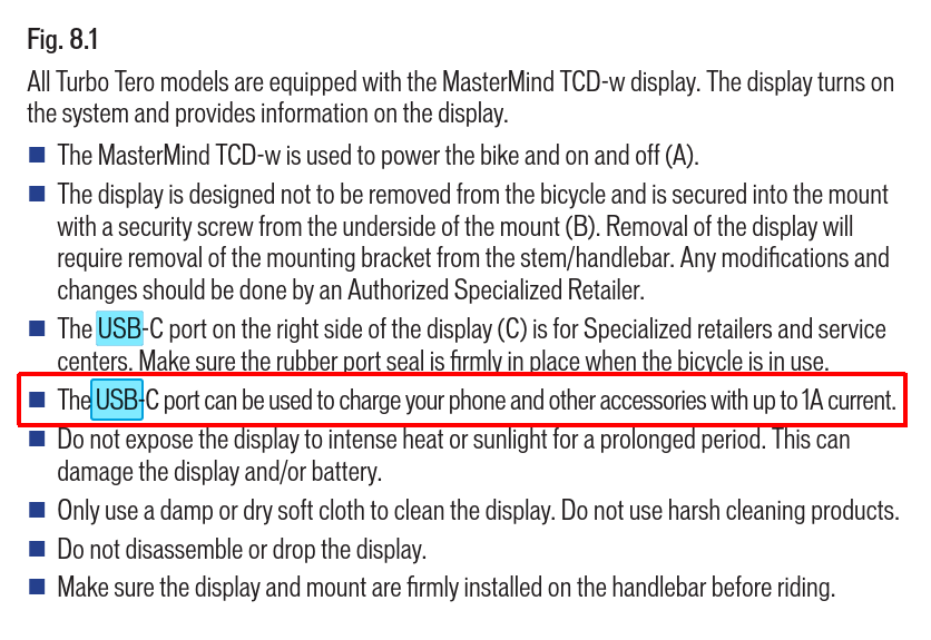

Thanks Stefan. Where did you find this spec? My shop told me the same thing. I can't think of any modern smartphone that doesn't want at least 1 amp. Specialized needs a new firmware that limits the current draw from the USB C output.
My dealer has other bikes with the same display so I will see if they can charge my phone.
It is in the 2022 Tero User Manual :)

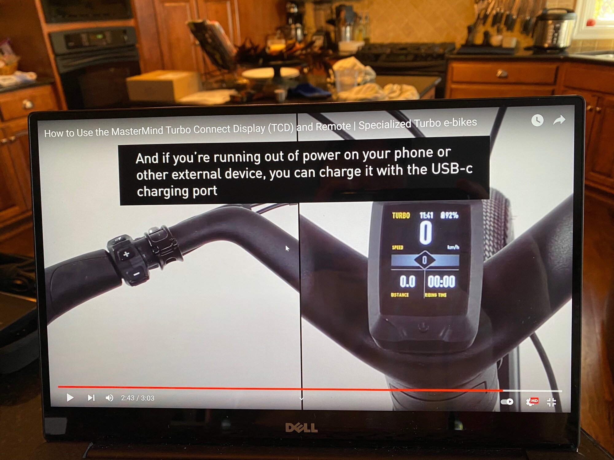

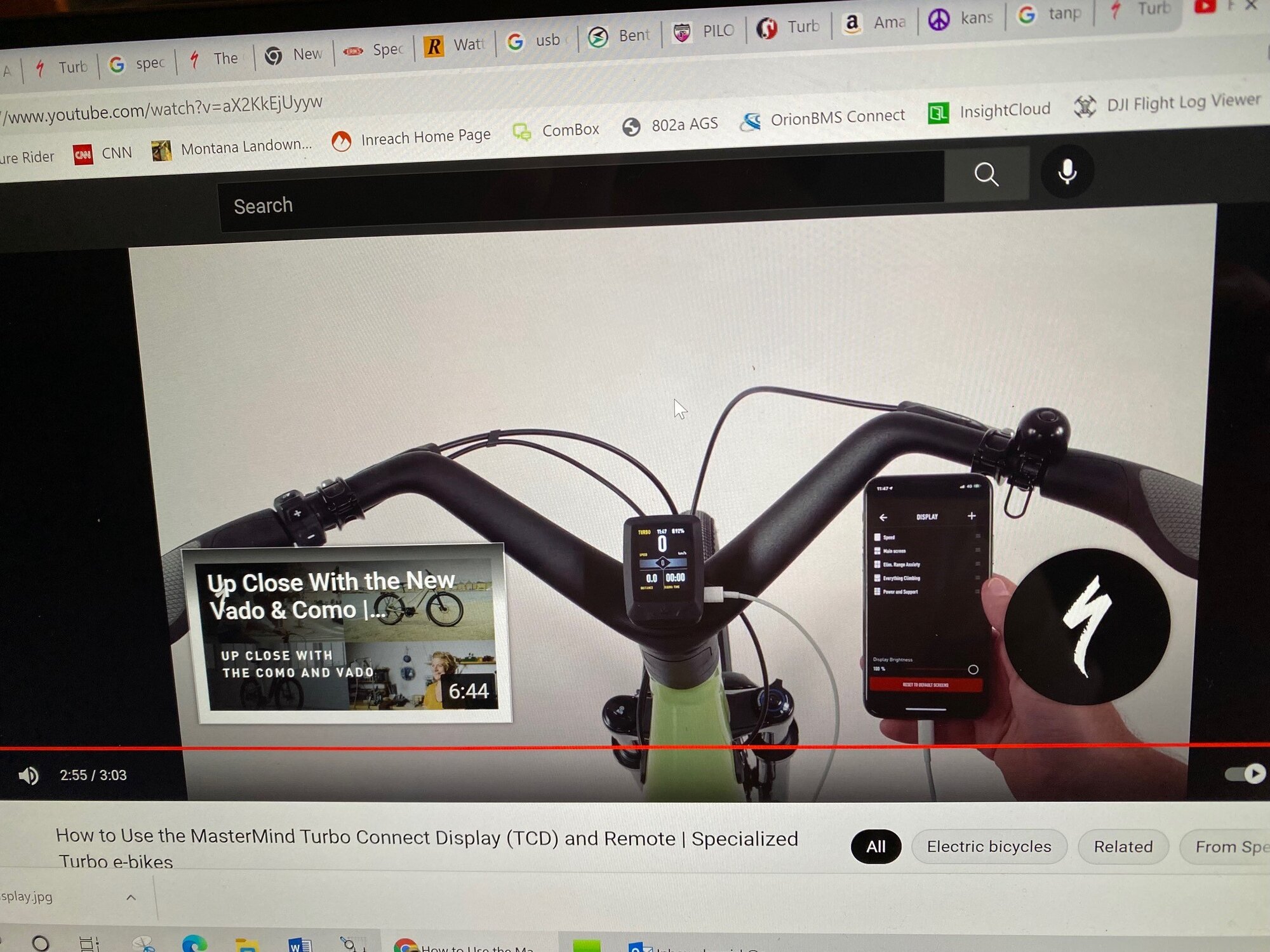

I was just at our dealer picking up her bike and tried my Iphone 11 Pro on their 2022 Tero 5 and it was the same. Charge for a few seconds and then stopped. Specialized support spoke with my dealer today and said the USB-C port is not for phone charging. I guess they didn't read the manual either or watch their marketing videos. That looks exactly like my phone. 🤣

I was just at me dealer picking up her bike and tried my Iphone 11 Pro on their 2022 Tero 5 and it was the same. Charge for a few seconds and then stopped. Specialized support spoke with my dealer today and said the USB-C port is not for phone charging. I guess they didn't read the manual either or watch their marketing videos 🤣
