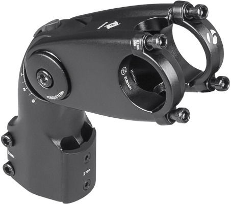

BTW, just remember that there is also a Bontrager adjustable handlebar stem (part #5264268) that your dealer can order that can help you sit more upright. We put one on my wife’s Allant+7 and it made all the difference.

BTW, just remember that there is also a Bontrager adjustable handlebar stem (part #5264268) that your dealer can order that can help you sit more upright. We put one on my wife’s Allant+7 and it made all the difference.View attachment 94731
Also, do you need to get a new (longer) stem bolt to fit this? Ta! (I'm assuming stem bolt goes down through a hole top left in picture)
Dallant, that looks like an interesting stem. Would it fit an allant+ 8? I'm getting hand tingling and neck pain if I'm on the bike for more than about 90 minutes, and I think higher bars would help. I've tried a Ritchie adjustable stem, but it doesn't raise the bars as much as this would.
Incidentally, I see the 2022 Allant+ 7 bikes all come with this type of stem as standard (here in the UK, anyway)
It should but I’m not positive. Your Trek LBS has to order it as I could not find it to order anywhere. Best of luck!

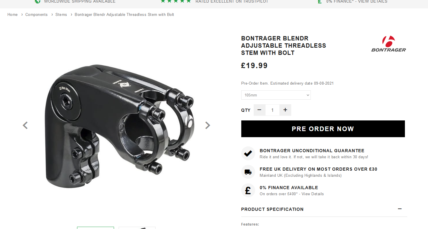

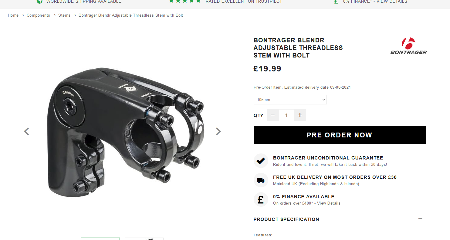

Hiya... Thanks. Yes I know I could fit a stem extender, but I'm not such a big fan of them. The stem that dallant showed is interesting, because unlike most variable angle stems it has an incorporated riser section first. It looks like dallant's stem actually replaces the steering tube cap that the stem bolt holds in place. Sorry I'm not explaining it very well!
Looks a bit different. The one we have has the cable management part in front and bolts up in the rear.

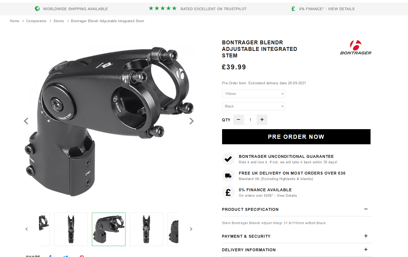

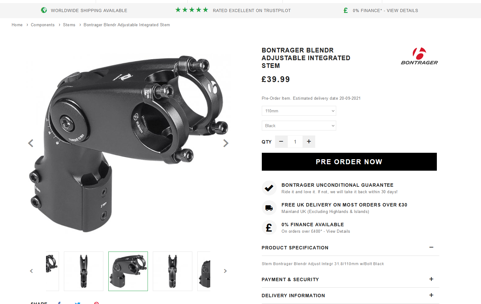

Ah, well spotted. This must the one you have - twice the price and not available until the end of september. I don't need the cable management, as on the allant 8 the cables come out above the forks, so maybe I can get away with the cheaper one...
Yeah, we don’t even use the “cable management”. I’d buy the cheaper one if it fits. I’m a bit PO‘d that there is a cheaper one and that you have it available to order. I never knew. BTW, what’s the part number for the cheaper one?

Sorry, none of the sites I've visited give a part number! For me, searching for 'Bontrager adjustable blendr stem' finds it, wheeras if I add the word 'integrated' I find yours.
