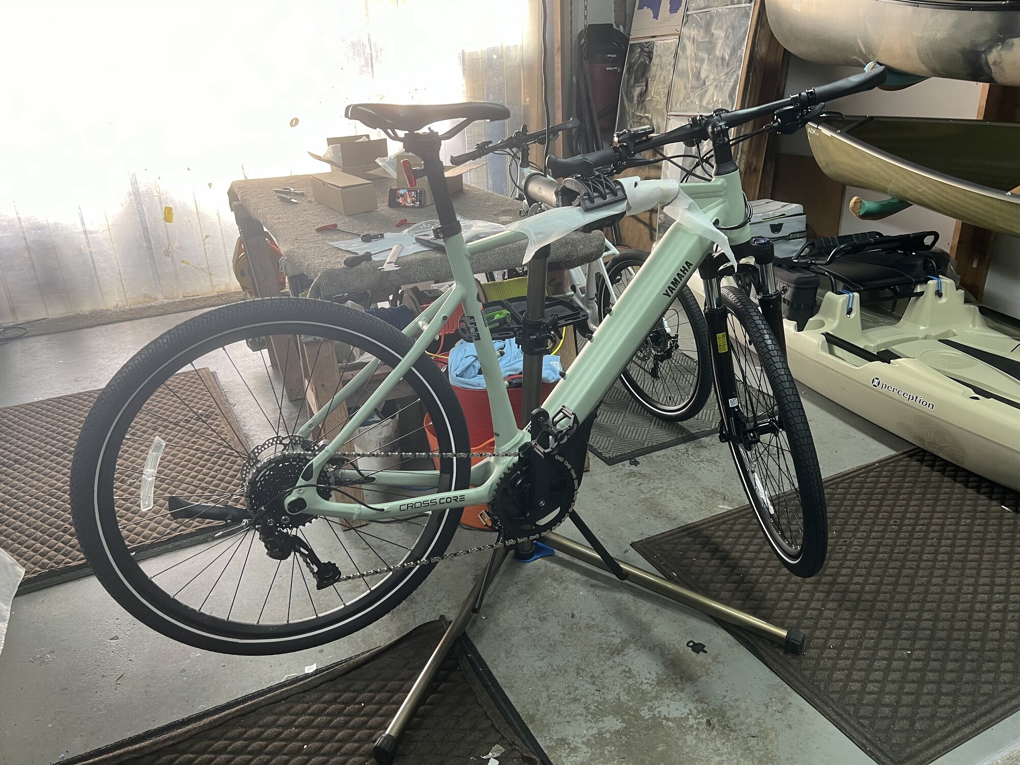

So, dropped by the outfitter canoe shop in Saint Pete, Florida and Tom was setting up a couple of large crosscore RC bikes. He had just finished building one and allowed me to sit on it as well as prop myself on the seat with my left hand on a bench.
Was surprised I could then straddle it flat footer (butt off the seat), granted my family jewels were resting on the top frame but still…my feet were flat on the ground wearing Birkenstocks sandals. He did feel, based on my body layout that a medium would be too small for me so got luckly on size I ordered it seems.

1. He suggested maybe a 2” stem riser as I indicated the bars were too low for my liking. Figure it would then still be very low bar height somewhat; maybe more so then my revised Summit bars/riser (it now uses a Giant Lafree handle bar (sort of a raised pull back beach bar somewhat).
Does anyone know what size bar stem, diameter size, to order (if that is the right name and specs I am asking for it)? I could order from Amazon or my local Giant dealer (which if right size might have one in stock) else order tonight if anyone has suggestion. Would like one that allows it to be rotated back a bit as well.

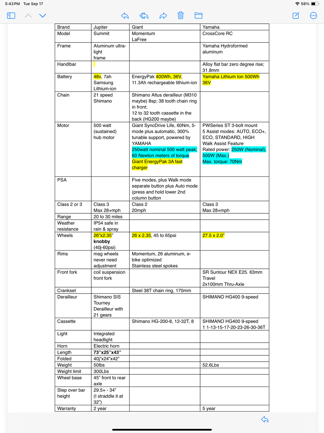

It seems, from the limited details I tossed in a chart there is not a lot of differences per say between my Summit and the Crosscore RC (well the summit does fold and has a throttle as well). The folding part really caught my eye and was part of reason for purchasing it used from a lady. Plus I think the Summit frame design is sort of cool, including orange’ish coloring a bit :). Guess you can guess I like orange.

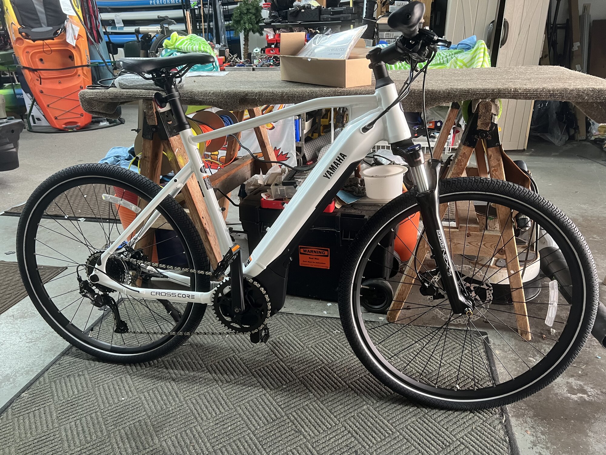

The white and green RCs at the shop were nice and likewise figure my burnt orange will be just as nice (told him not to take it out of the box yet). They did have that other model, Wabash RT in Large at the shop though on the Yamaha I no longer see it for sale at a sale price.

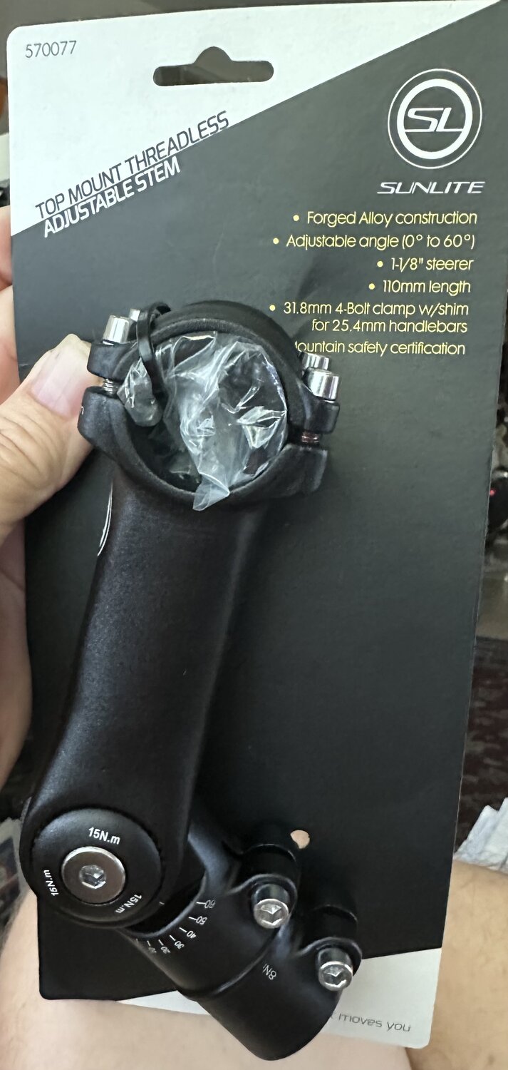

I did purchase attached top mount thread less adjustable stem, my Giant shop said it would work on the RC so can at least take it down to eye how it might look on an RC they probably have built in the shop already. Yamaha said more rear fender in stock in a bit.

You might want to make sure that you have enough slack in the cables to accommodate the stem riser and width/type handlebars that you want to use. I was only able to use a 90mm adjustable riser on my gravel bike because of the cable length limitations. The picture that you posted of the white bike doesn't look like there is a lot of cable slack.
Regarding fenders and rack, the bike frame/mounts look standard so it appears that you shouldn't be limited to the Yamaha specific accessory.

Well, I did it. The shop said any bike they get cannot send back to Yamaha plus cannot pay the discounted selling pirce to Yamaha. Thus I took the bike.
Thought the guy that puts them together was going to be there today so I could show him my handlebar stem extenders but the bike was already built. Figure I can Google how to change it out. I did get a short one as well in case I need it instead of the longer one.
At any rate, I find it unbelievable, not that they told me that Yamaha would force them to retail it at the prior higher price, Rather, I infer their shop would likewise have to pay a higher price for bike received If one did not want it.
I could have gotten that info wrong though if true not very fair to a bike shop trying to sell bikes. Granted it is not their bread and butter. Actually during covid, by selling bikes, they were allowed to stay open in Florida so it saved their business actually :).
A win-win event :)
If anyone is considering the Yamaha line that is on sale you can put the bike in your cart and enter your zip code. That will let you know whom in the area sells them and maybe you can drop by and check them out if they have some customers bikes. Then see what the colors look like plus maybe sit on one or two to determine best size.
I probably should have checked to see if they had a medium to stand over but hoping the large size will work out in the end. Plus hope my orange color is not over the top…well guess it is mostly lol. The sage green might be a good inbetween color to go with actually.
Will find out if I can live, and not kill myself, riding with those very short low bars. Seems to be a thing now days so maybe there is something to it.

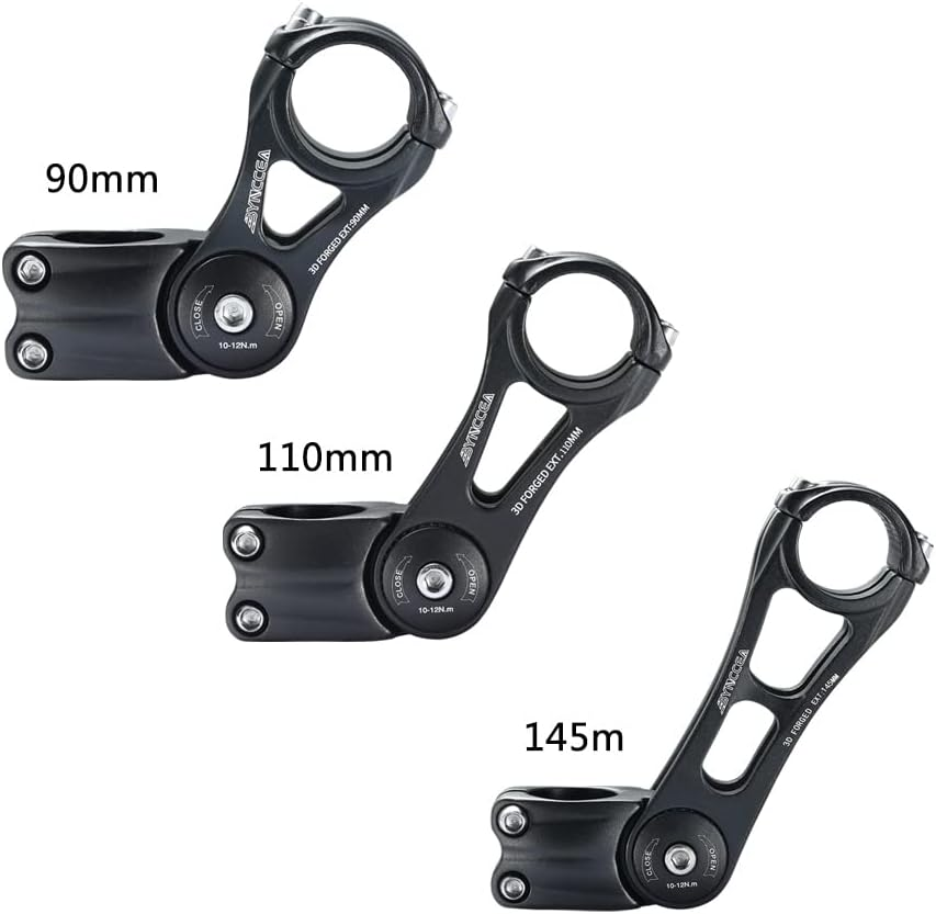

My only chance of keeping this bike is if I can raise those handlebars. There's not a lot of cable slack. I had it shipped from distant dealer for $1200 plus $200 shipping, so returning isn't an option. If I don't keep it, I'll sell it locally.
Has anyone tries any of these? The 110 or larger might help if there's enough cable. Or any other recommendations for the handlebars?
Those can make it work

Which of those handlebar extensions did you end up using on the CrossCore RC? Or change in the handlebars? Did you have to do anything with the cables for everything to reach? The medium frame is too small for me (5'11" & 32" inseam). Standover gives me plenty of clearance, but the handlebars feel too close and low, but there's not a lot of cable slack to come out of the frame. I already have the seat adjusted back to the maximum marker.

Which of those handlebar extensions did you end up using on the CrossCore RC? Or change in the handlebars? Did you have to do anything with the cables for everything to reach? The medium frame is too small for me (5'11" & 32" inseam) and the handlebars feel too close and low.
I got fit. Longer extention and moved saddle back and wider pedals the standover is a little over 32 inches so you should be ok there. Your trick is probably to extend the stem
