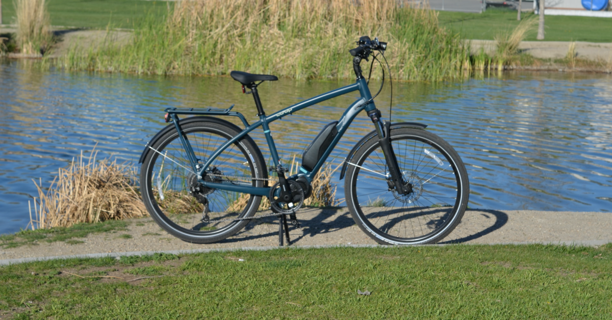

I've been recommending this a lot because it's such a good value w/ so many practical uses, but check out the CTY e2.2. Shimano middrive w/ 60Nm of torque, rear rack that can take 59 pounds, front suspension, hydro brakes, integrated lights and one of the largest and best dealership experiences in the business.
I thought nice bike as a first impression, then I noticed where the kick stand is mounted. That's right out of the dark ages. When down, it will not let the bike roll back more than a couple of feet until it fouls the pedal/crank arm. Everyone else in the world has made note of this issue and moved their kickstand mounts back far enough to eliminate this potential.
Maybe the picture is a prototype that's been changed, but if not, that would be a game stopper for me....
It's a double-sided kickstand, much like the ones cargo bikes use. It can lift the entire rear wheel off the ground. I've no idea if it interferes with the pedal rotation. But I'd honestly take that over the single rear-mounted one I have on my bike.
Yeah those are a big deal in the cargo bike world. I have one on each of mine and they are a HUGE upgrade. Especially when done right. Not sure if the one pictured is one of those unless its an ESGE/Pletscher of Swiss origin and even then its light duty as such things go.
In particular they are needed by parents who have children on the back of the rack and need some attention getting them strapped in. Something considered essential is for a stand like this to be stable as a kid climbs up into the seat. Its common for the less-substantial double stands to let the bike tip over. Hence the aftermarket for the $90 Ursus Jumbo and the $400 Rolling Jackass.
