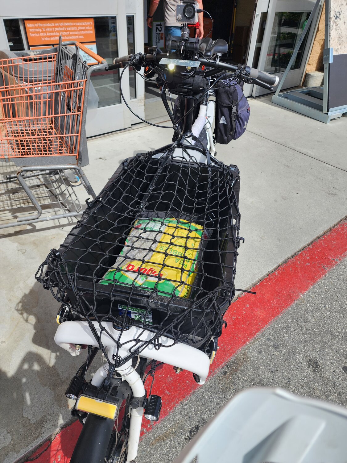

I am, although I do it purely with pedal power. I put the front pedal assist at 3 of 5 because I don't want to break anything. My rear motor gearing is 40T chainring and the 34T rear cog. I stay away from the 40 and 48 because of skewed chainline on a bike with very short stays. I do max out the assist level on my BBSHD in the back but I have my motor de-tuned on pedal assist so it is putting out about 850-950w continuously. My display peaks at 1000 so I know I have more in it if I was willing to hit that throttle and take it to its roughly 1700w peak. But I build bikes to use that keep working so I have no interest in creating a failure by overdoing the power.
You are seeing 100 lbs of gravel. I weigh 250 lbs. 250+100=350. Add in my locking mech at about 20 lbs, and then the bike itself and I am well over 400 lbs. Probably around 450 when you tally in bike, battery and motor. Its only rated for 400 but the engineers @ LvH say the platform hits its weight limit at the wheels and I have had extra strong ones built, with oversized tires. Route is from Home Depot in Marina CA to lets say Trader Joe's in Pacific Grove CA. Use the climb up Prescott Ave. for reference. I actually live a bit down over the top of that hill, not at its peak, but I still have to get over it.
If I was willing to use throttle I could exceed the 12 mph, or if I forget to use the right 34T rear cog and stay in my 28T, I can get up to 14-16, but its really dumb to stress the drivetrain like that and I try to make sure am aware of my gears before I start my climb so I don't make that mistake. I have a front motor which makes this possible, but I could do the same load with my Surly which was rear-motor-only, but of course slower (36T front ring and IIRC 40T rear). Probably 8 mph and I was working pretty hard to get it up that high. The consequences for stopping mid-hill are failure to restart so you pedal hard with force to make sure you make it up.

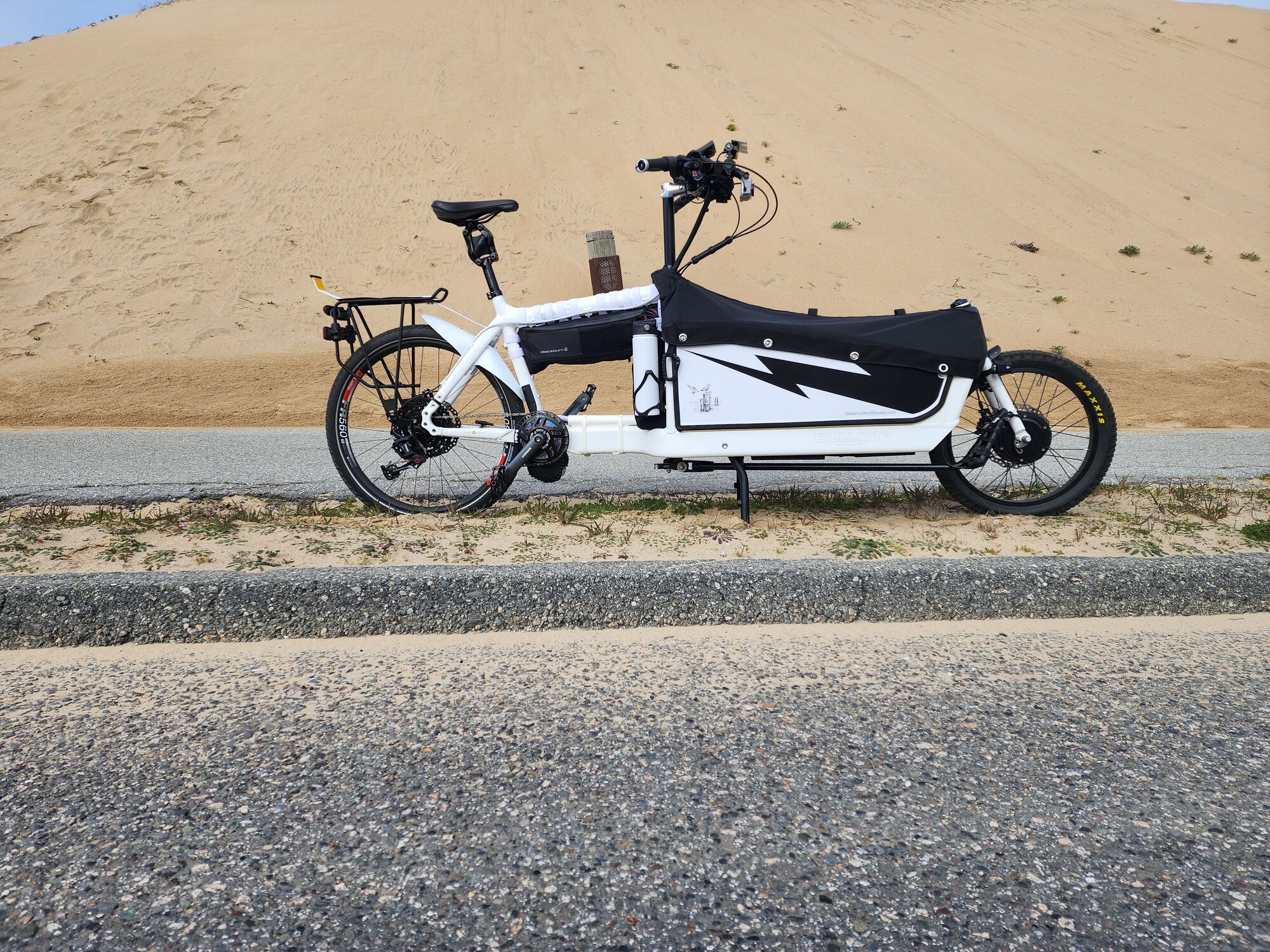

The tests I recently saw on the new Lectric cargo bike are laudable as it is a single hub motor that can get up LA's Eldred St. grade, but if you think a little critically, you see the rider is puffing hard to grunt/assist/inch his way up, and much more importantly, he has no cargo. It is an achievement for a hub motor to get up that hill at all, but it is a stunt and not a measure of actual utility.

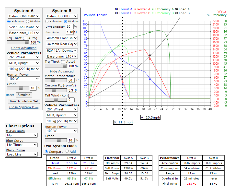

This comparison at grin seems to contradict your claim
https://ebikes.ca/tools/simulator.h...throt_b=100&autothrot_b=false&autothrot=false
With this gearing and speed, the BBSHD requires the rider to ride at 130rpm cadence, going to a slower cadence(90rpm) doesnt make the BBSHD any better than the GMAC.

I would agree with that both from experience and using the grin motor simulator.

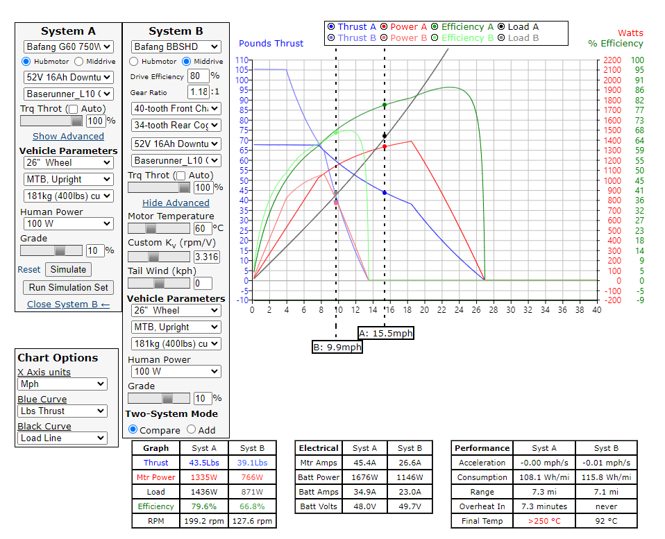

Sure the geared hub drive can go up steep hills, just not for long. I did an exhausting analysis on the grin simulator a few years back and the GMAC10t would start overheating at anything over 6% (at full power). I can do longer 10% climbs just fine as long as I keep the power lower (about 500 watts)
Yeah as respected as the Grin simulator is, if its saying a hub drive is in any way in the league of a mid drive going up hills with a load, there is a variable somewhere that isn't being plugged in. This is one of those things you figure out real fast in real life, on the bike. I abandoned a twin-hub 2wd bike that on paper has 80 nm per axle, twin 35a controllers and a battery well-capable of handling the peak and continuous loads. It was obvious listening to those poor motors groan up a hill (literally, you could hear them laboring) that a bike that was able to live forever and barely warm up on flat ground was out of its league when you take it hill climbing and give it a job. I didn't spend that kind of money on a bike to kill it prematurely when it can liver forever and haul ass in terrain suited for it.
My next move was my first 2wd build with a mid drive in the back and the superiority of its performance made it obvious I was done building bikes with hub drives as primary power.

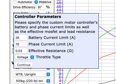

I haven't run these in awhile, and unfortunately, the Grin simulator will not let you use the BBSHD's built in controller for some reason. But picking matching cold Baserunner controllers - you can use one on a BBSHD - and using the Bafang bigfoot 750 as the hub to compare it to, I ran simulations on a 10% grade with 400 lb, 308 lb and a bantamweight 220 lb load. Then I plugged in my own 40T/34T preferred gearing. I used an 80% efficiency rating simply because the G060 has 80% efficiency and I was looking to eliminate that as a variable, but I think the BBSHD has a better efficiency value and these results should improve a bit. I don't see a place to plug in cadence so just tossed it on 100% throttle with 100w added for human power. It pretty much shows what you expect. The hub motor can boil water and overheats. The BBSHD never does (the Advanced options are shown but I did not use them).
In fairness, you aren't going to be going up too many hills that are 7-10 miles long, but that ">250 degrees celsius" temperature is going to have consequences on the nylon planetary gears long before it gets to 250.

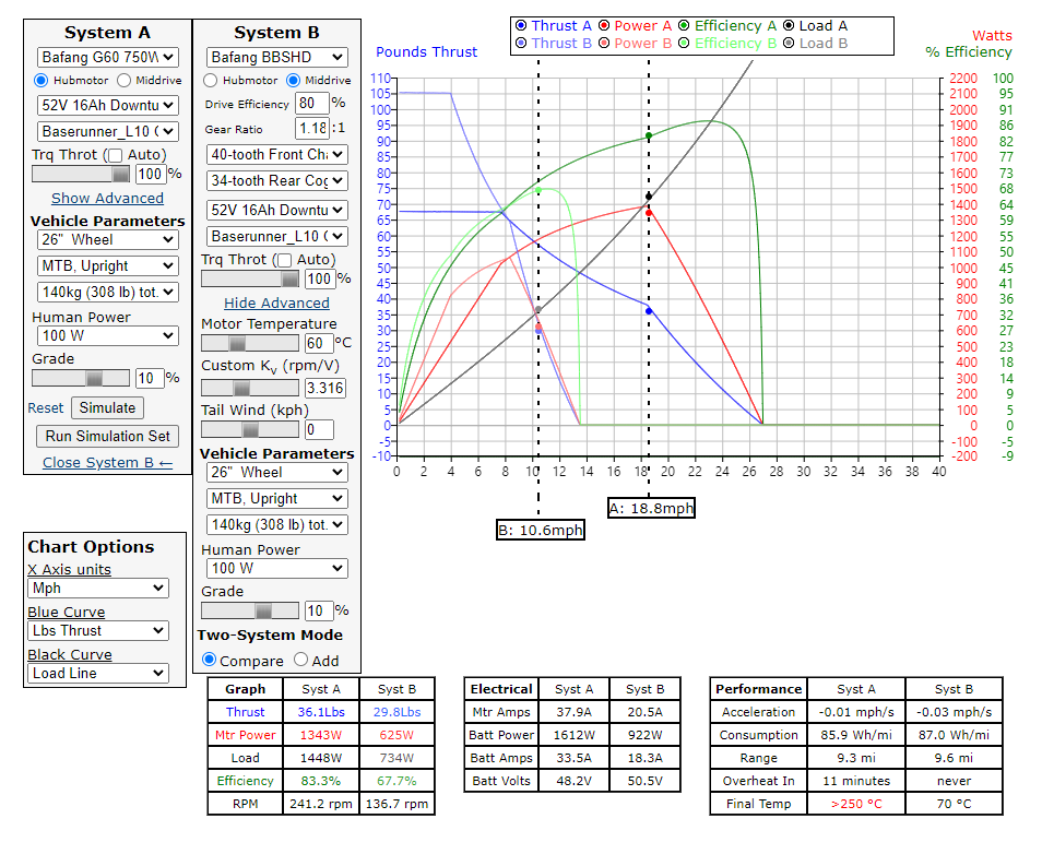

I ran it using the GMAC 10T and surprisingly got worse results. For something like my own bike the GMAC would be the real option since mine is not a fat bike.
