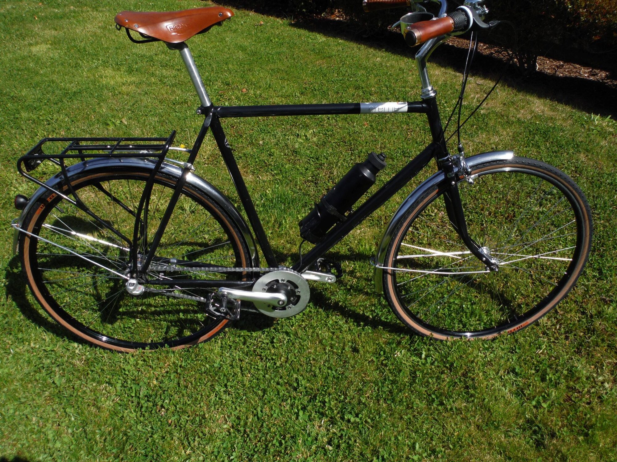

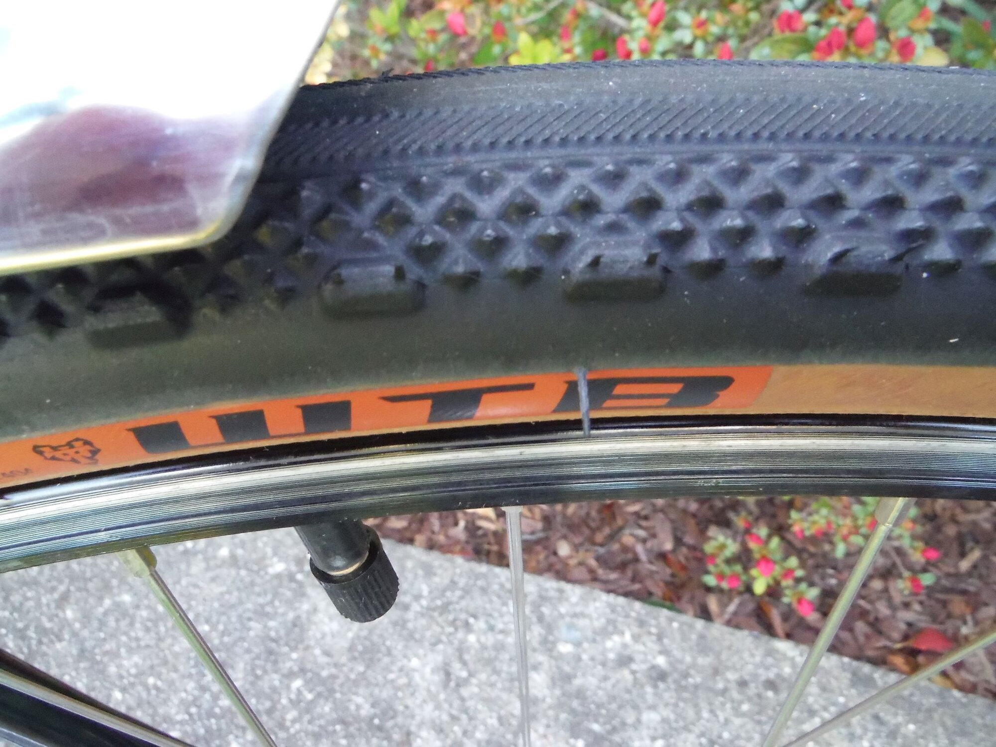

@tomjasz. that particular bike is getting 34mm x 622 WBT Byway tan wall tires today. It will look great in the 2023 Butter & Eggs Parade, where we will feature 40 circulating ridders of all ages as our 'float' this Saturday. It will be a sunny 69 F. Our 'float' is #165. I will ride with a silly helmet that looks like a cowboy hat and with farmer overalls. Tons of kids will join at the last minute. These old tires have hit too many broken, brown beer bottles to be redeemed. As for this thread, it is 85 Nm and a torque sensor mid-drive, coaster brake. This is my go to bike because it is so responsive and fun. I like elegant and simple. It is a three speed that can kick Stefan's rear end on big climbs. A kid once challenged me, he said in the Principal's office that I hurt him, I said how, show me where it is black and blue? He didn't pull down his pants for all to see the purple and orange. Case solved.

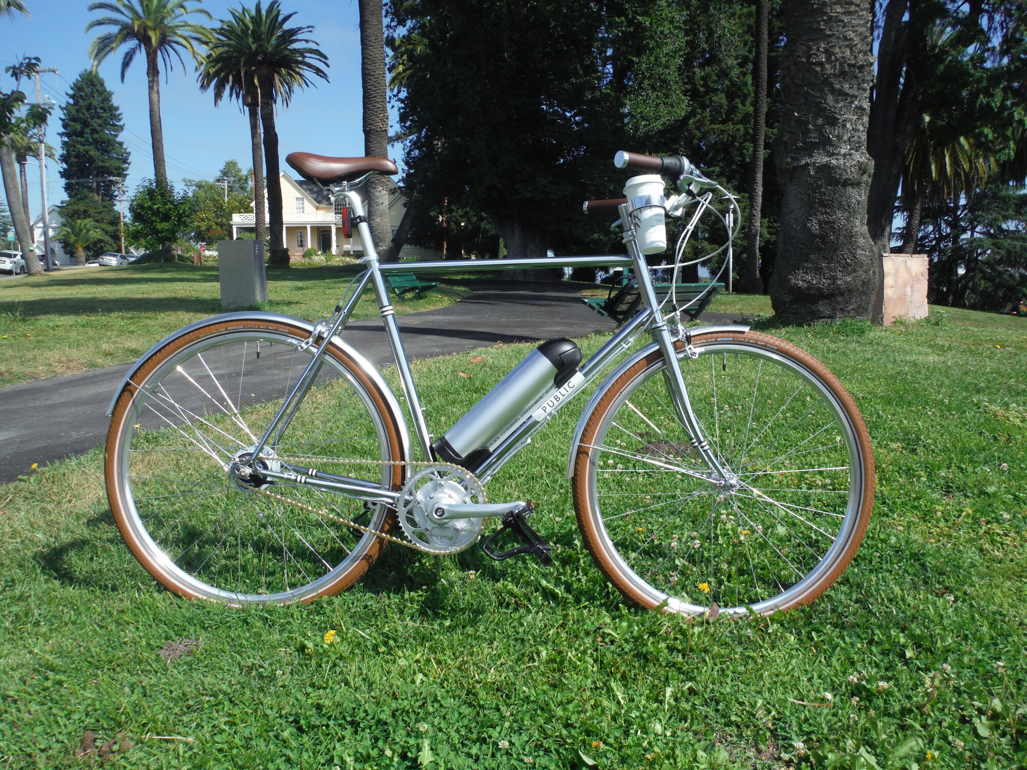

Which make and model is this bike? looks fabulous.

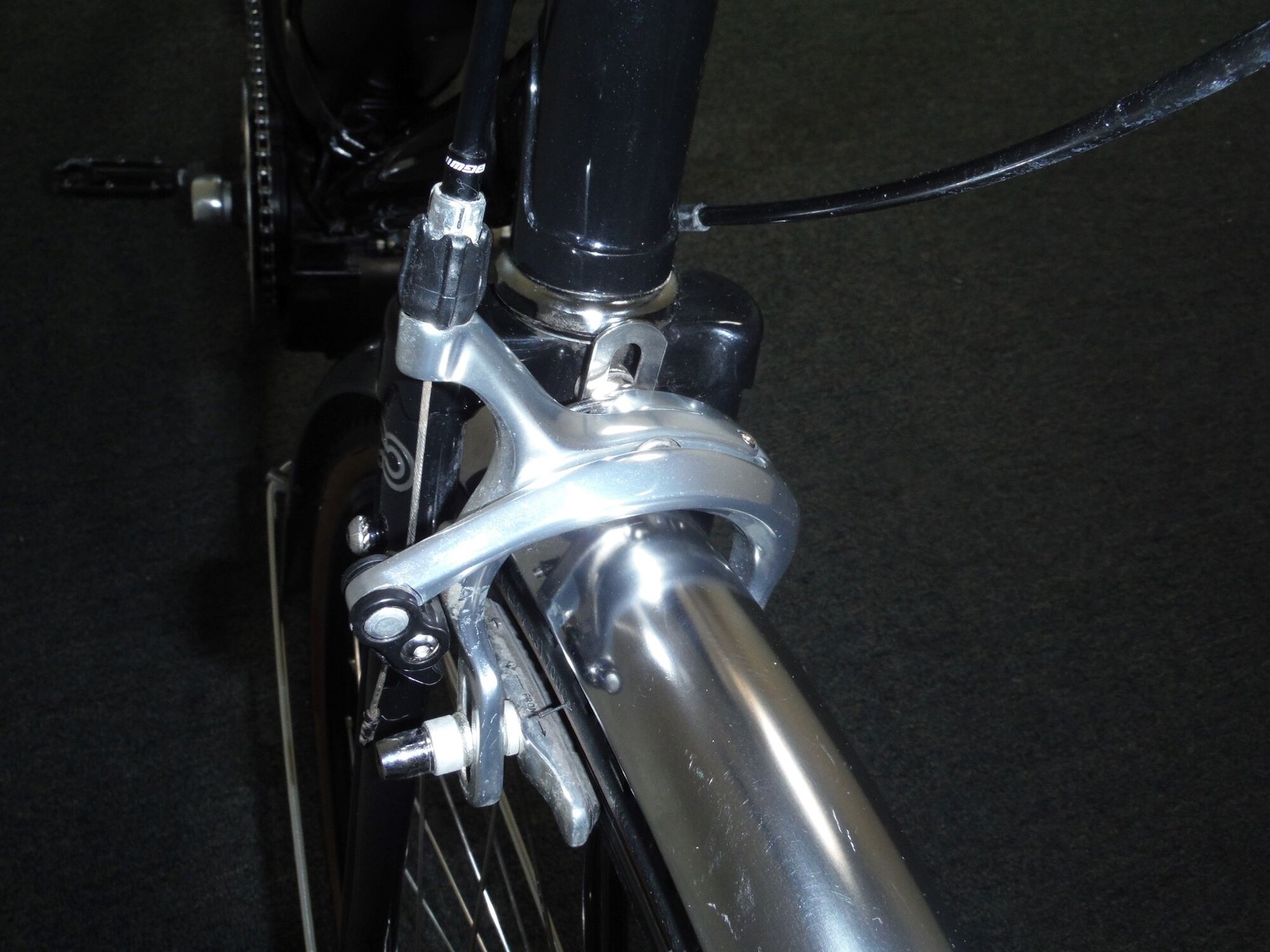

QR skewers, a coaster brake, a V-Brake.

Beautiful bike, as so many of your custom creations are!
Curious, is your oft-stated devotion to ebikes that don't look like ebikes a retro esthetic or something else?

something else

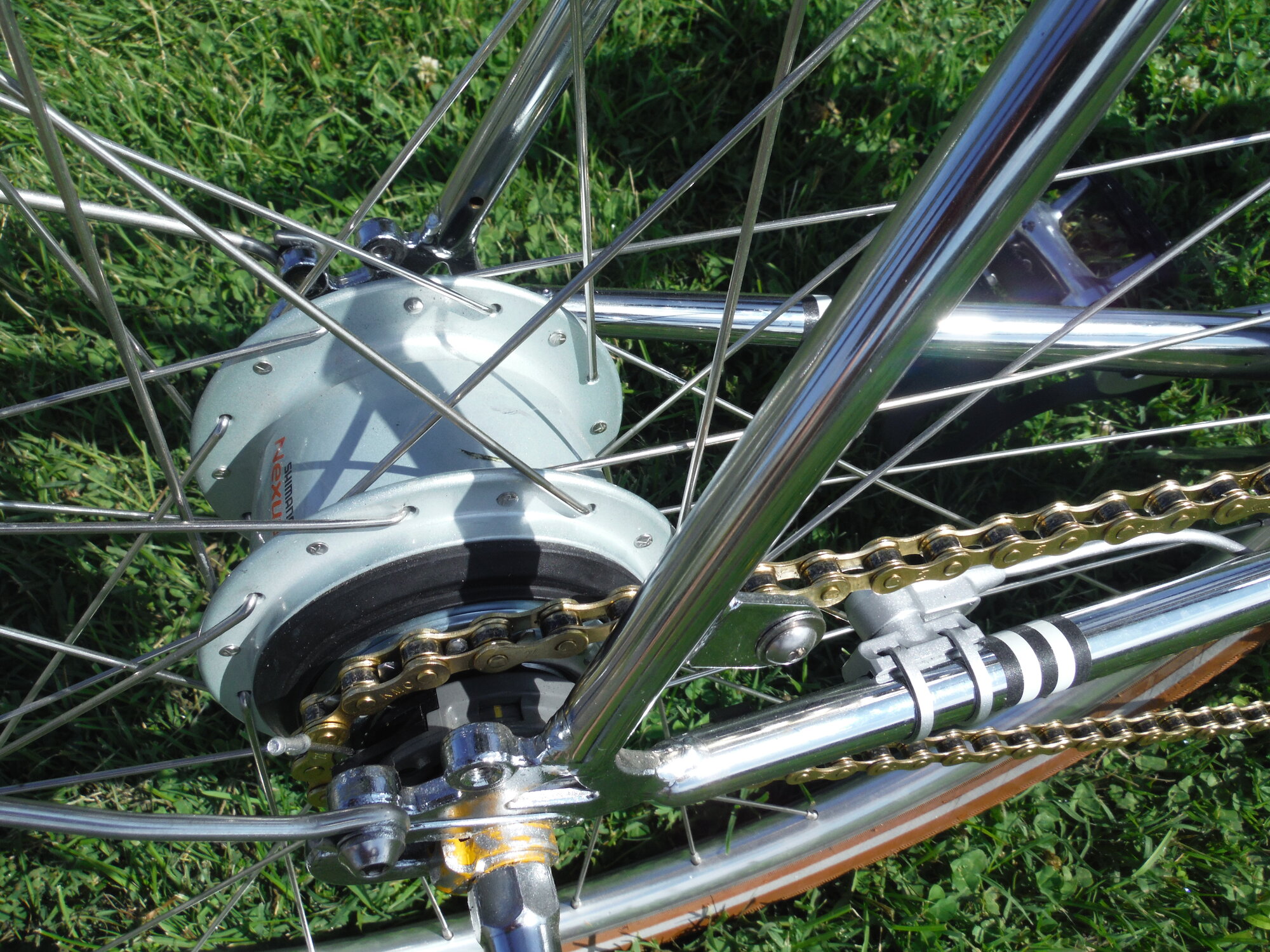

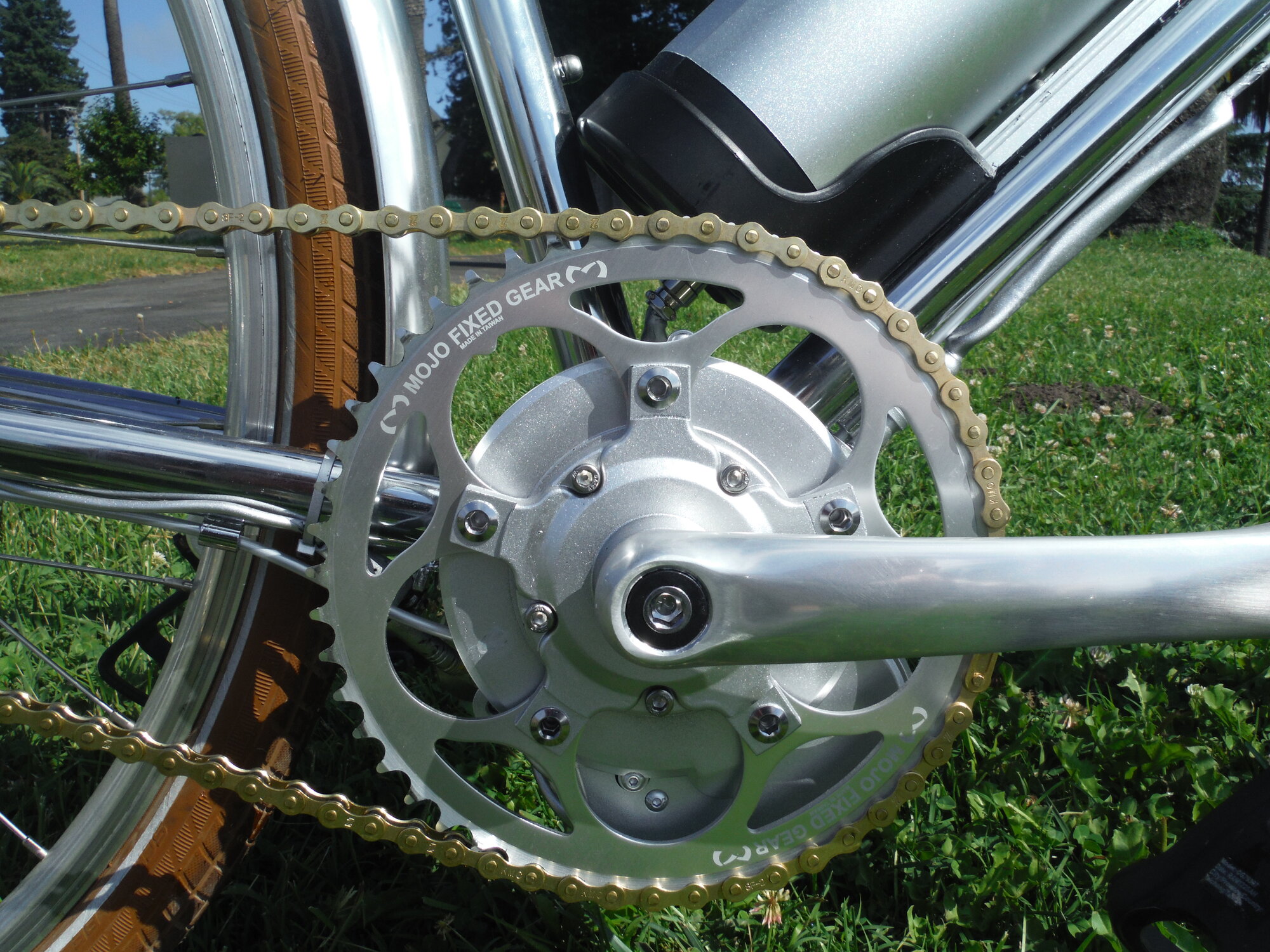

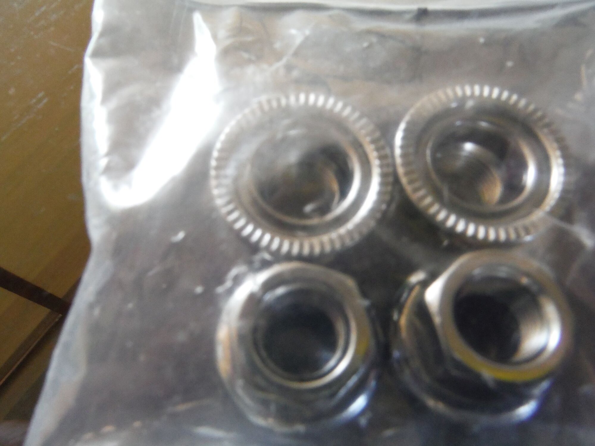

Thanks Jeremy, That 'something else' is how a bike feels. The wheels have solid axles on that bike which are are held on by extra-strong stainless nuts, the outer ring is stationary and the threaded part spins. The special chain is as strong as a belt because it is also used for stopping with the coaster brake. The front brake has extra wide brake shoes and duel pivots. It can lock up. That bike got new Byway WTB tires today. I am going to jump on it right now and go for a ride. CroMo is so comfy. Oh, today it has a larger battery for a longer ride. They swap in seconds.
Interesting mechanical design approach. But I was asking why you're so intent on hiding the "e" part of your ebikes? Is that what your customers want?
I am not embarrassed that they are electric, but non-bike folks can't recognize them in plain sight and that is fun. My first one was like a first pancake you feed to the dog. It was clunky with a big battery, messy wires and had a ghost pedal motor with a throttle. By my twelfth they became more refined and almost all had torque/cadence sensors set up so you get more power with both higher pedaling pressure and higher pedaling speed. My fourth one still had extra-wire at the base of the down tube. You can see it painted silver. But they were getting better and better. Here is that fourth build. It had a chrome frame and an 8-speed IGH. I told the mom of a guy on the design team of Specialized, that it is called Creo Eater when she asked its name.

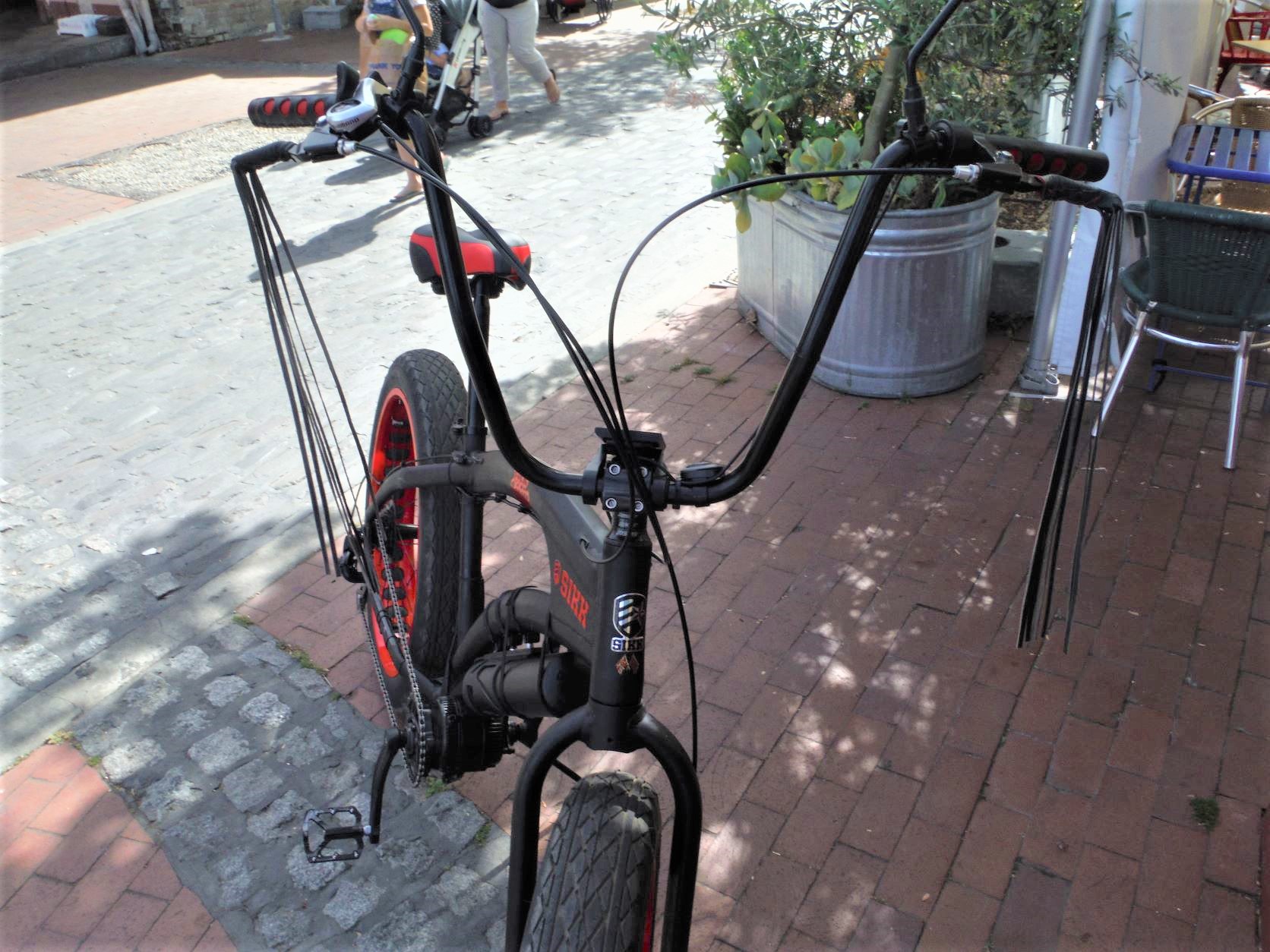

Hey, what about Mr. Rodgers? I think that too many bikes try to hard to look cool and badass. Like someone in a Hawaiian shirt and a black leather jacket with white rimed sunglasses. It is true, I like to undo that and still pass them on a trail. Now is this bike Mr. Rodgers to you? It is an S02 with throttle. That is me in the photo. I normally don't show photos of myself.
Now that's unnecessarily to the other extreme and more like Alice Cooper to me... never did appreciate him much.
