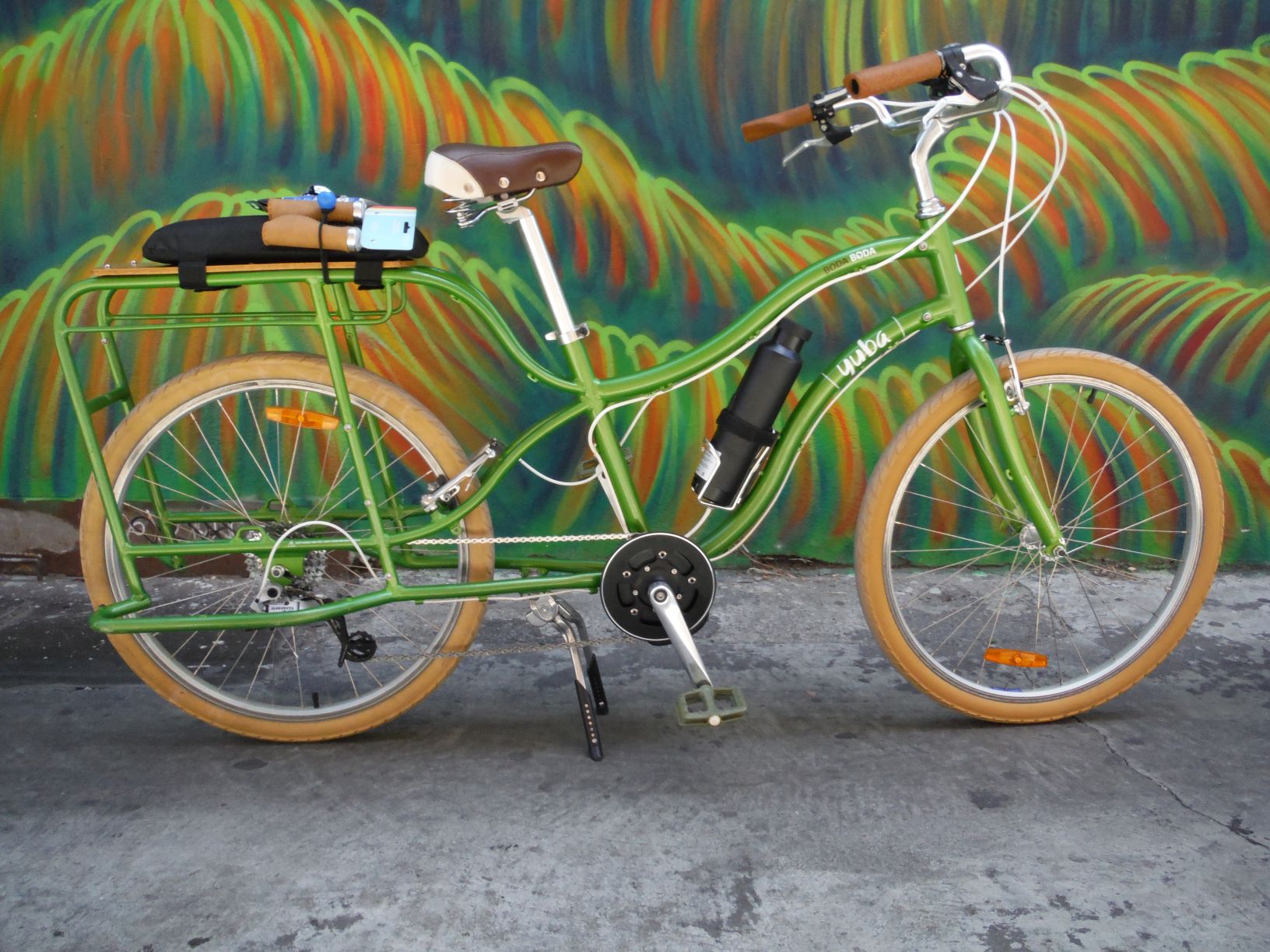

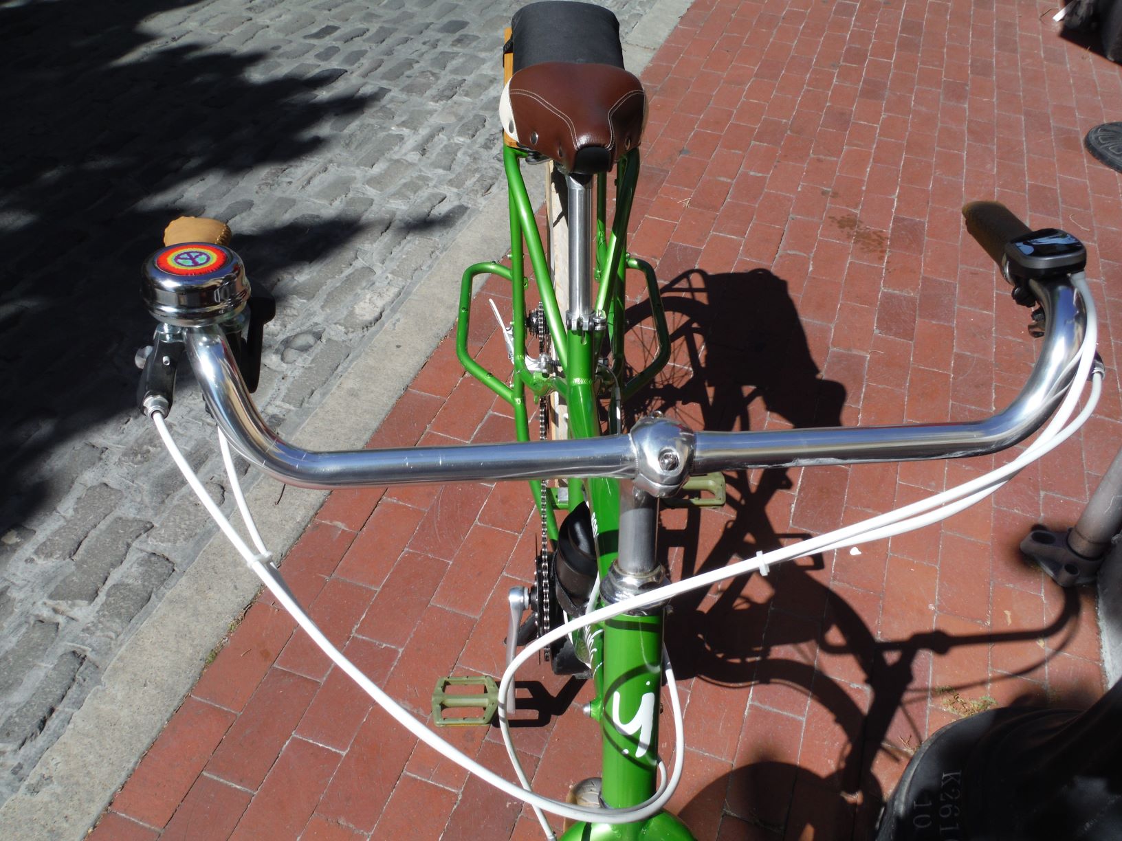

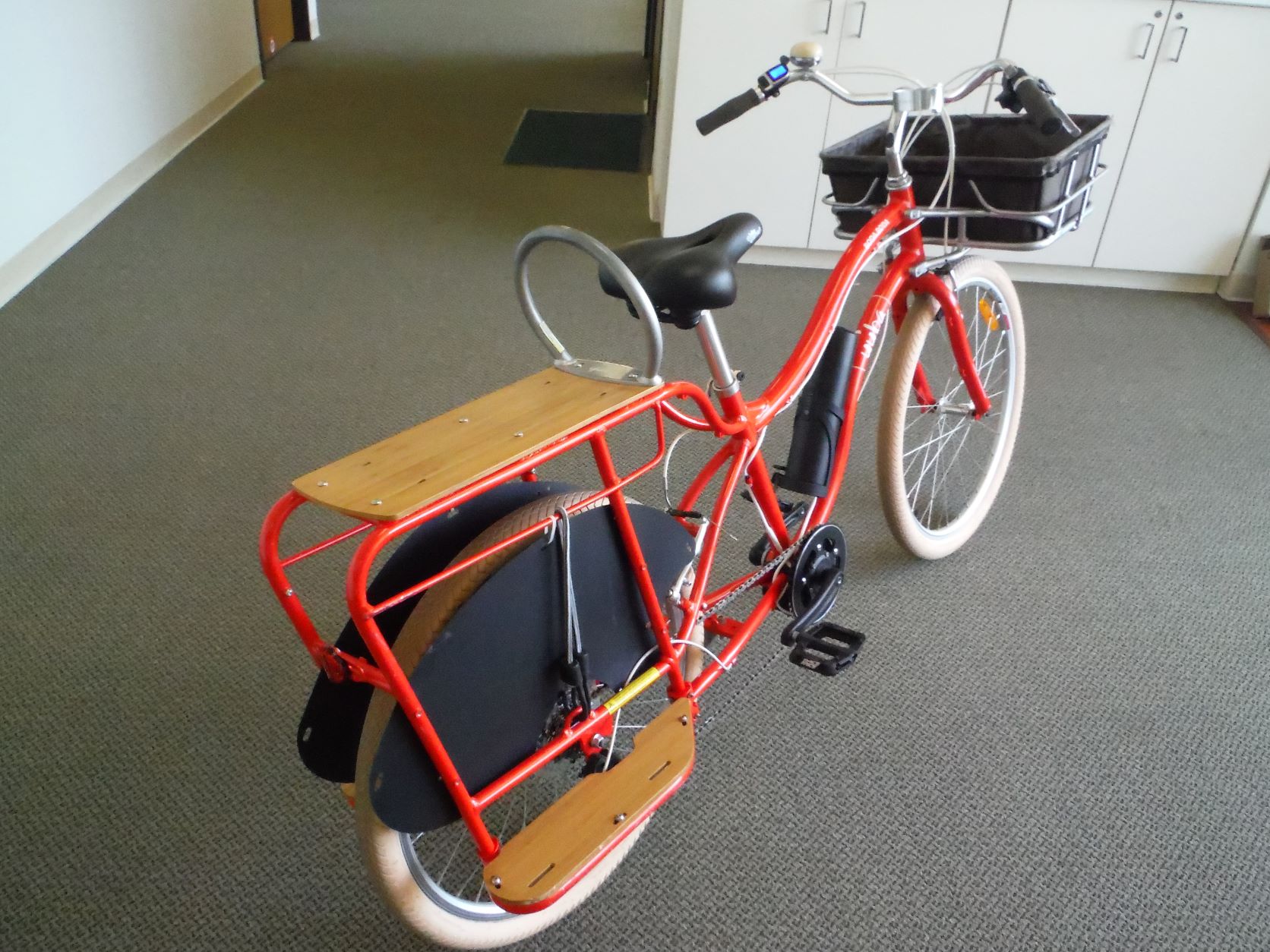

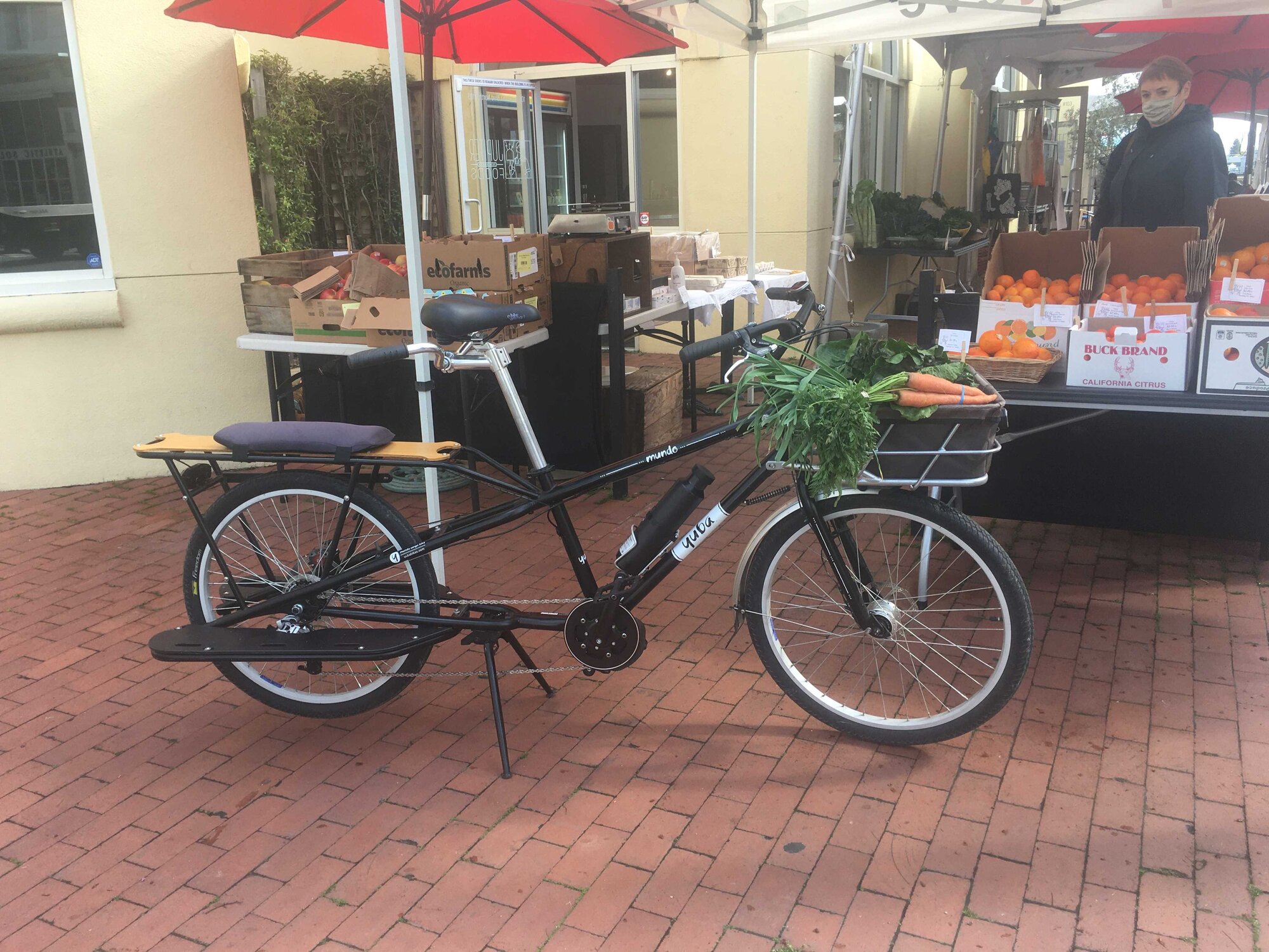

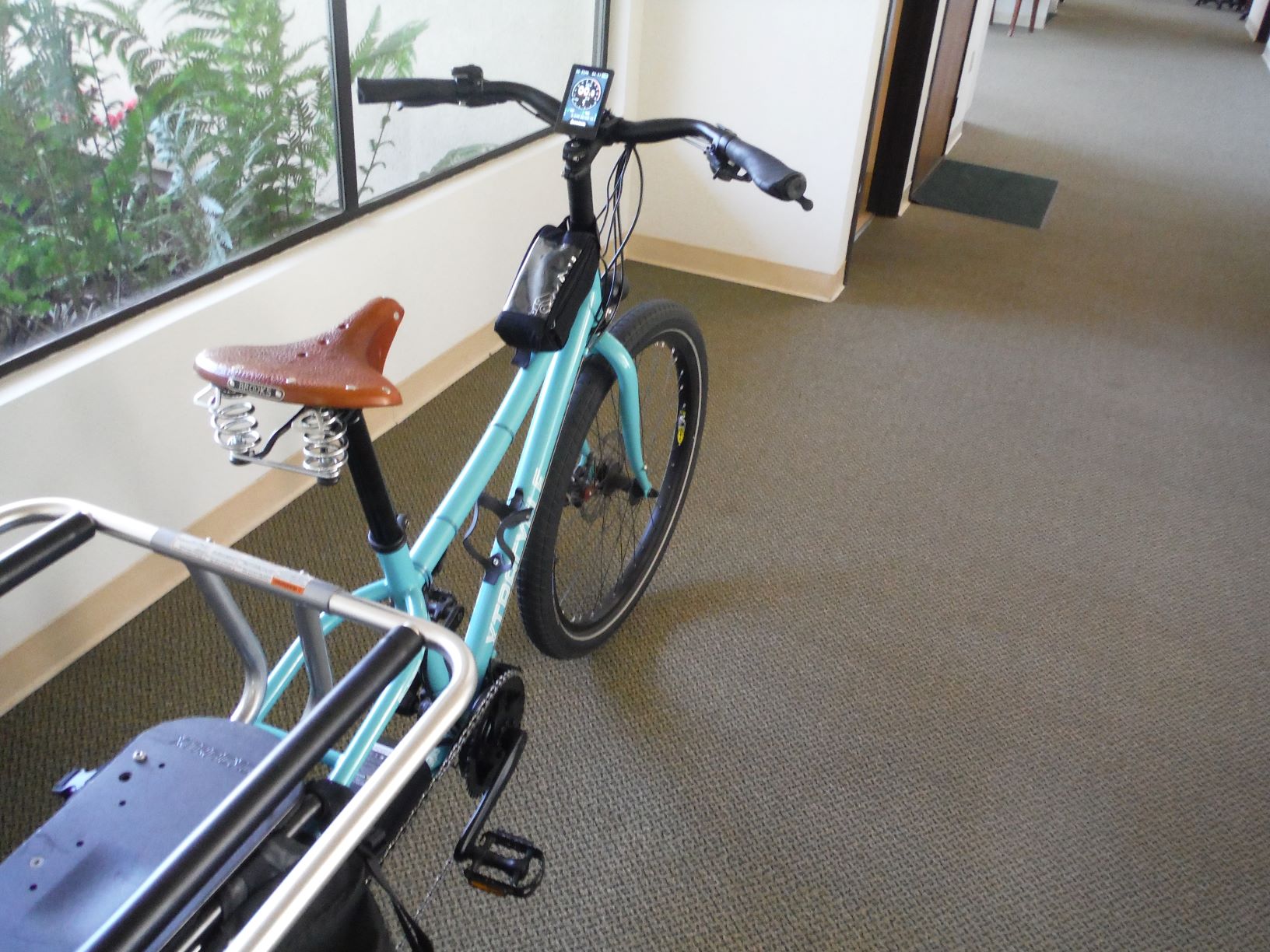

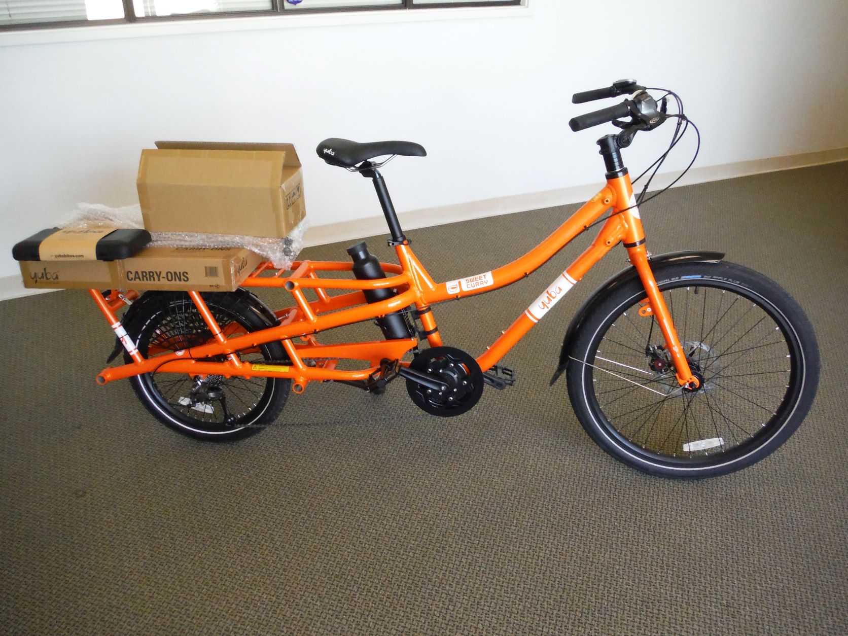

@mainelobstah, Welcome! @m@Roertson is correct. You will want a frame designed to take a kid or cargo on the back and a twin kickstand with a powerful mid-drive. Kids grow. I am in the SF, CA area where we have hills. Last week I purchased a Yuba Boda Boda to convert for $650. These are lightweight and compact for cargo bikes. The rear rack holds 100Kg, 220lbs. I received this comment today from a person who lives on a 12% hill. "Thought I’d update you that the bike is running very well. We use it every day for running our 4 year old to and from preschool." He has a Sweet Curry that I made into a Spicy Curry. It holds up to 440lbs on the back. If you are handy you can put in a mid-drive, save a ton, and get a better bike than the ones online or at stores. The first two are Boda Bodas, the next is that orange Curry. The Boda Bodas are the most fun to ride because they are smaller aluminum bikes.
