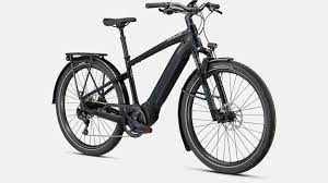

That weight is going to limit you but ill go ahead and recommend a Specialized Turbo Vado, its only 5lbs over your target weight and for sure checks the rest of your boxes.
That would make my LBS guy happy as he sells Specialized. We have another LBS that recently opened and they sell Pedago. So that company is now on my list. I try to buy locally if I can, but sometimes the discount is just too great. After all, I think the LBS make more money on service than they do on sales.
