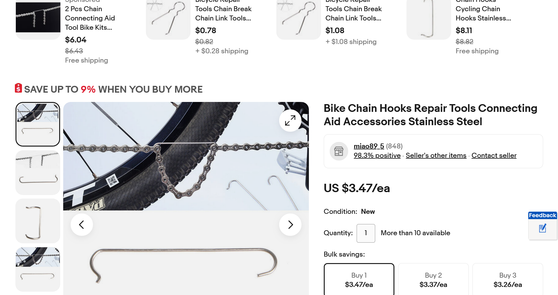

I don't count links. I use a door. Remove the old chain. Hang it over a door. Cut the new chain to match. If it takes two chains, make them equal length. Include an extra link or two. You can always remove one if it is too long/slack on first gear or 8th gear. 6/7/8 speed chains are called 8-speed. A chain hook can help. You can make one from an old spoke.
