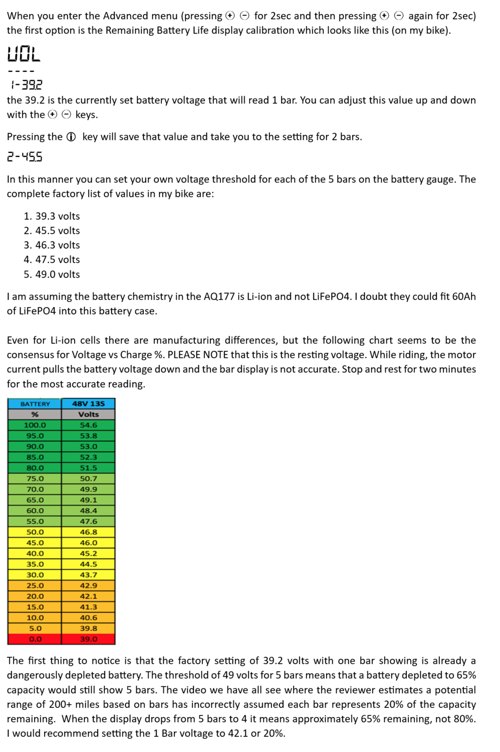

While fiddling around with the display menus I discovered that the manual was written for a different bike. The first item on the advanced menu is UOL and it is the voltage threshold of each bar on the battery gauge (handlebar display not the gauge physically on the battery).
Below is a graphic I put together showing how to set up this menu item. Unfortunately, the factory defaults are harmful to the battery and give a misleading estimate of range.
The values I have set in my bike are as follows
5 bars 51.5 volts = 80%
4 bars 48.4 volts = 60%
3 bars 45.2 volts = 40%
2 bars 43.7 volts = 30%
1 bar 42.1 volts = 20%
