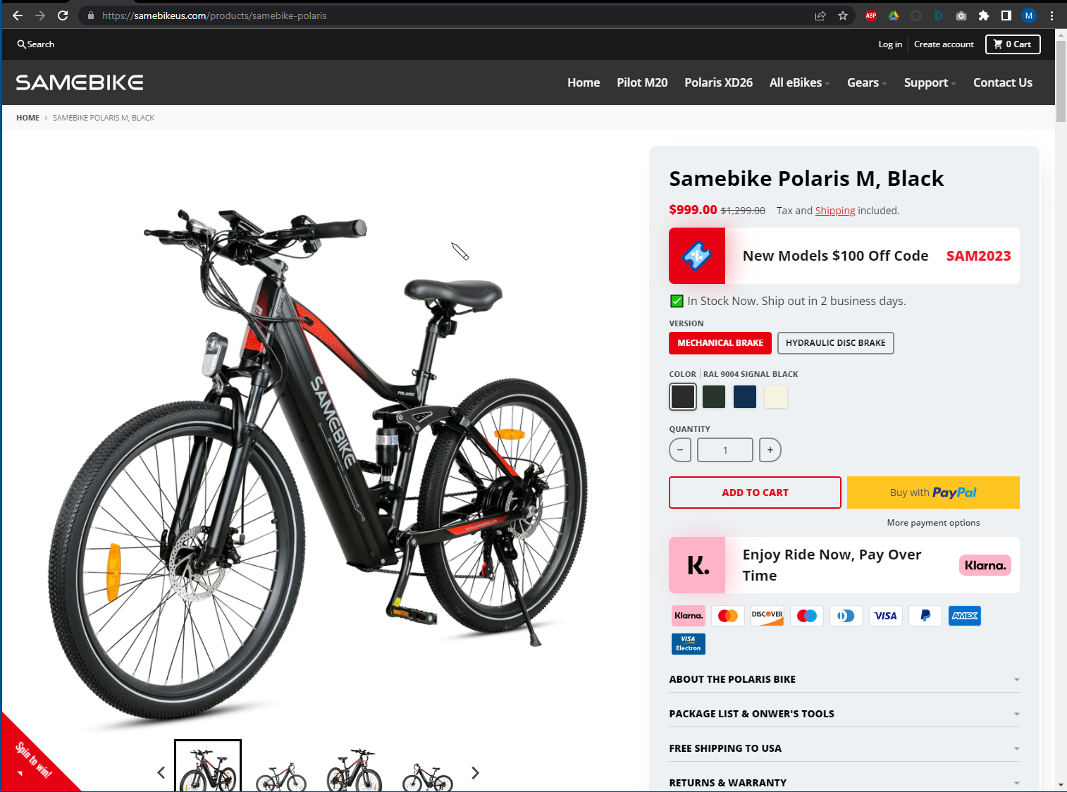

To be blunt, that bike looks like junk but its marketing team invested in a nice web site to hawk it.
The $999 sale price (not $850) is with mechanical brakes. Also you have to realize that suspension costs additional money to put into a bike design, and if you are seeing full suspension on a bike for the low price of a thousand bucks (yes this is a low price as ebikes go) then that price only is arrived at by cutting every corner possible. For instance a 672 wh battery is tiny. From their web page:
"The 21700 battery cells are MSDS, UN38.3, and CE-certificated for use safely indoors and outdoors."
Ignoring the spelling error (there are many throughout) ask yourself what "MSDS certified" is. A Material Safety Data Sheet has nothing to do with safety certification. They are just throwing acronyms out under the assumption that the layman is too ignorant to know any better. And if you've been around for awhile you will know there are countless bogus claims of safety certification for batteries. The fact they have thrown in MSDS for good measure just reinforces the fact that they are playing you.
The rear suspension shock looks terrible - a tiny little thing not suitable for anything but maybe a kid's bike. Maybe. You can expect the suspension fork to be a spring fork at that price point, which is awful, performancewise. I'm not getting into the why's and wherefores here because explaining these conclusions would take more time than anyone has here :) .
Its $999 and the page claims "free shipping to USA" so they can sell this bike for that price AND ship it and still make a profit? Bottom of the barrel parts is the only way that happens.

Thanks for your replies everyone! Its actually 850 for the mechanical and 950 for the hydraulic brakes (both on sale). There seem to be four versions of the bike, two for the EU, and two for the US, the batteries you quoted are the EU model, which was on the advertising graphics. but here is the US model specs at the bottom of the page. https://samebikeus.com/products/samebike-polaris-h-black#

Looks like we are all wrong. The prices are 999 and 1099 like I said, but if you add the SAM2023 code on the page, you knock the price down to 899 and 999. At least thats what they are showing me at your link. But I have to emphasize... when I see a seller actively BS'ing the consumer I consider them a write-off. No telling what fibs they were more clever about concealing from me.
