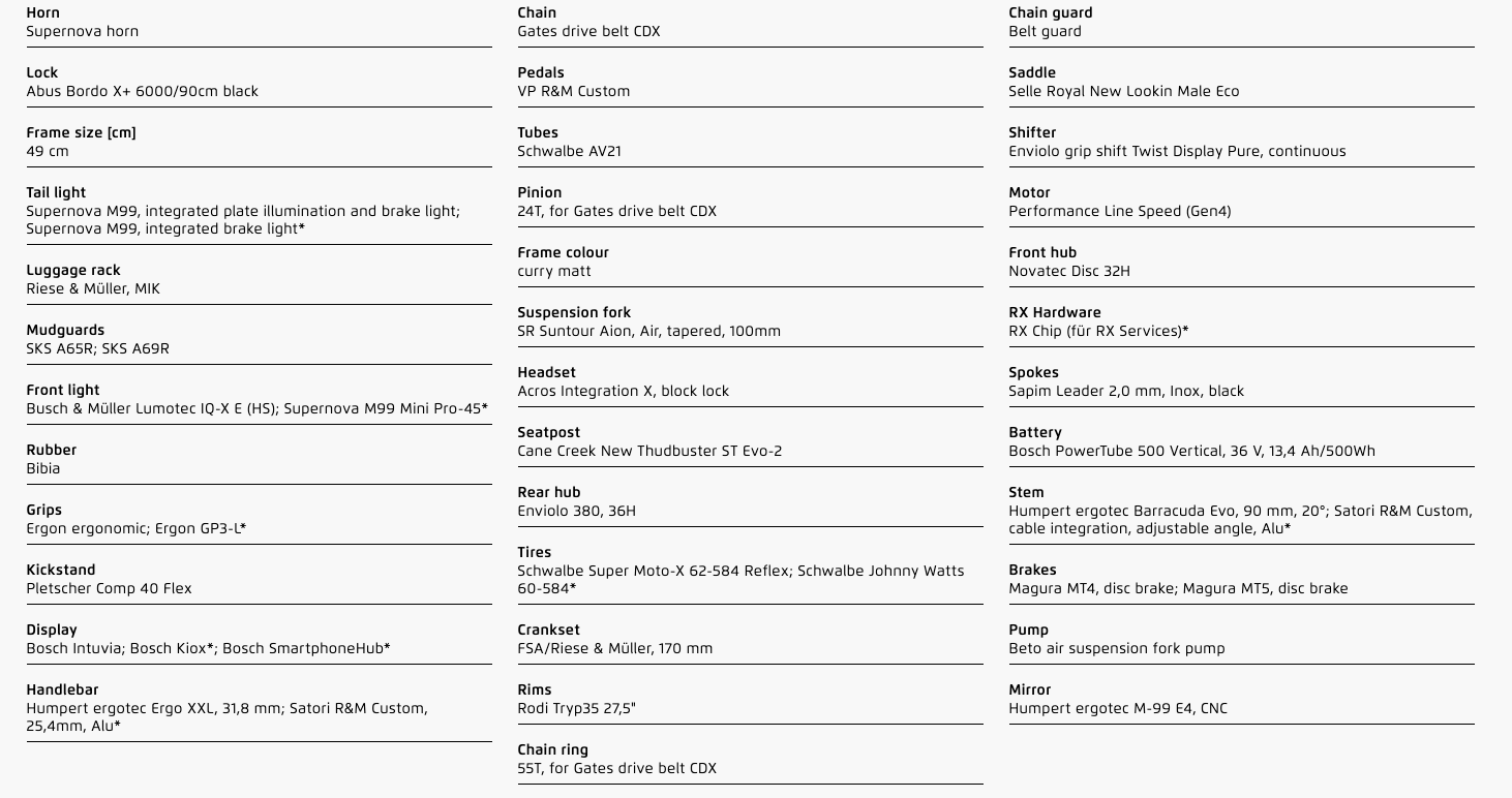

I’ve an SC2 high speed with Enviolo -
Many threads here around how it’s under geared for high speed and cadence too high to maintain 40kph or above.
Got me thinking - would it be possible to replace Enviolo with standard Rohloff hub and manual shifter ?

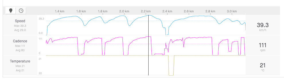

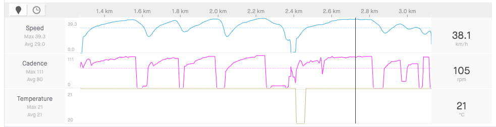

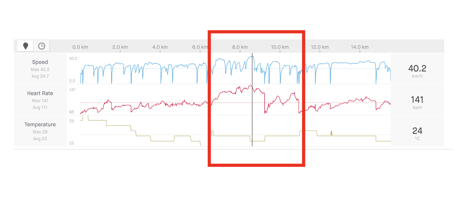

I'll move my cadence sensor off my gravelbike and onto my SC2 and give it a test to see what my cadence is required to exceed 40kph
ok so a short ride today with cadence sensor on - basically needing cadence of around 110rpm to hit over 40km on the Bosch headunit (Garmin usually 1-3kph slower)
Couple of screenshots:
Unsustainable in my mind - I'm not a featherweight by any means, but whilst weight will make some difference, ultimately, there is not enough high gears to be hitting 40kph at a sustainable rpm, let alone 45kph.
I'll do a similar test on my gravel bike (Rohloff + Gates Belt drive too) and see what my cadence is to get to that speed).

What drive unit do you have and/or what year is the bike?

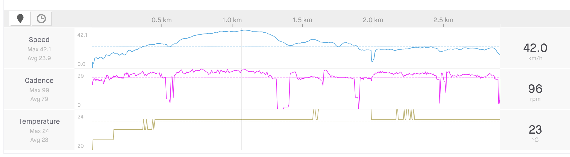

OK and now here is the test on my Gravelbike with a Rohloff and Gates belt drive with GravelKings SK Plus 700x35 - not super fast tyres and quite wide, so takes a bit of effort to get up to 40kph+ (quite windy today too):
So hit 42kph with 96rpm cadence - MUCH more acceptable.
So shows that the Rohloff would be a better fit for lowering the cadence.

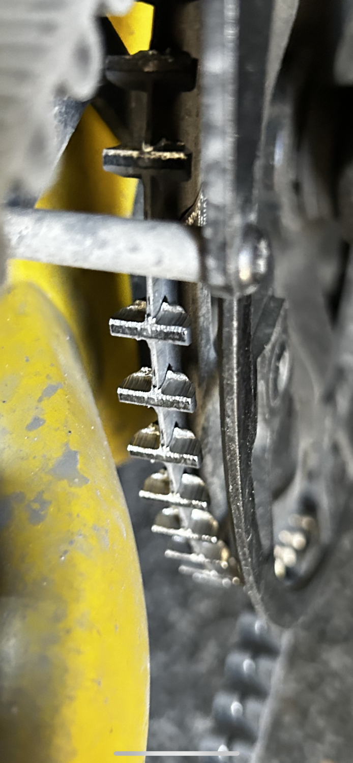

I forget the history of your top speed/cadence dilemma. If you've got leeway in 1st gear, have you considered a slightly larger "chain" ring?

Sadly no - only a couple of mm clearance already with the 55mm chain ring and the frame:
