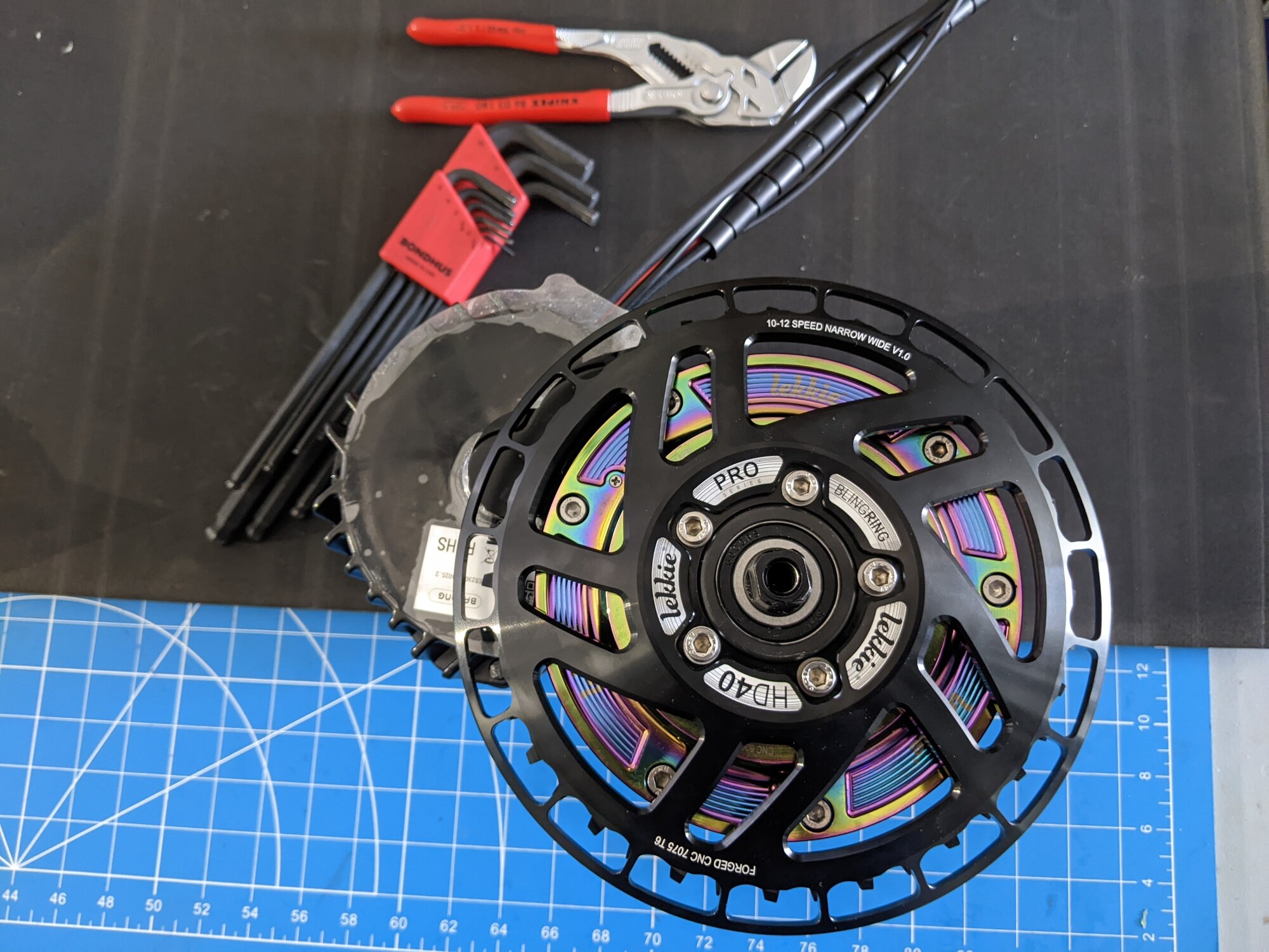

Nope not a zerk. Its just a teeny hole at the bottom of a conical receptacle that matches the Park Tool (and similar) bike-sized mini grease gun. Its capped with just a basic (and super tiny) countersunk phillips head screw. Maybe an M2 size.
EDIT: Here's a pic of the motor I am installing next month on my current project (click to embiggen). See the little countersunk phillips head screw at about 10 'o'clock? Unscrew that and there's a hole at the bottom. It fits a Park Tool grease gun tip perfectly.
