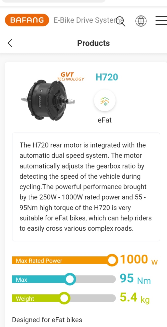

So, I have a brand new H720 Bafang motor,..
I had to Google that,..
Holy Crap !!
I didn't know that there was such a beast ?!!
I want one !!
It looks like it only accepts a single sprocket though, but I'm fine with that.
I don't pedal anyway.
I'll just pick a low gear to use if I'm forced to pedal.

What about the H720 2-speed for a fat bike?
I can't find anywhere to buy it?
@AvalancheRun did you buy the motor or an e-bike with that motor?
A two-speed is good enough for me, but the gear ratios are 1:1 and 1:1.3* and my geared hub motor gas a 5:1 gear reduction.
Does the 1:1 and 1:3* gear ratio on top of the normal 5:1 gear ratio, or does the wheel turn four to five times slower than my hub motor?

The 1:1 and 1.3 gear ratios don't make sense to me?
It doesn't look like a direct drive motor?
I found out that the 3 and 5 speed hubs are just geared hubs, not geared hub motors.
