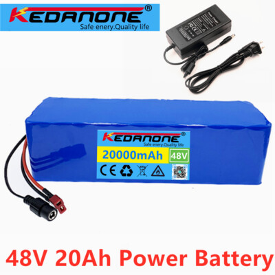

This battery pack from ebay is almost exactly the same size as the one in my plastic case.
Really 1/4" and 1/8" smaller in two dimensions..amazing
It's a 20Ah where mine is a 12Ah and I think mine is a 16S where this is 14S..not sure if that matters.
It comes with the charger.. Pros/Cons ? will this work ? I'm 71 retired trying to save a few bucks DIY
My motor is 750 watt 1200 peak 1000 watt battery OK?
I'm not sure what to do here too. The other 700watt battery of theirs has 20 amp output where the 1000 watt is 40 amp.
my controller is 25amp. Is that 40amp safe or will it blow me up..hmmmm?
will I get less performance with 20amp? sounds like a stupid question but I'm that stupid with this stuff. thanks if you can help.

Meanwhile, the battery you found on ebay is a fake. You're not getting 20AH for a hundred bucks. I can see the lie in their specs. They say it's a 52 cell battery, which would mean a 13x4 cell array. The AH rating comes from adding up the individual AH number of the cells in a parallel group. In this case, 4 cells. Divide 20AH by 4 and you need 5AH cells. Well, they don't make cells that powerful yet. The most powerful are like 3.6AH. It's more likely they are using 2AH cells, so this is a 8AH pack, if you're lucky.
If you were to buy it and charge it to its full charge of 54. 6V, I suspect it will sag to 48V the first time you use the throttle, If the Prodeckotech still runs, then you
